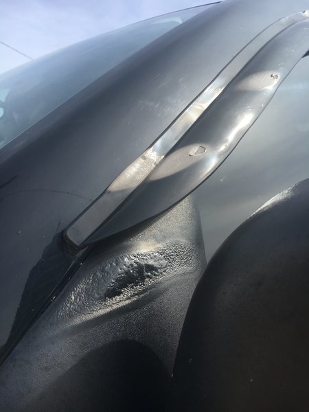

    The plastic is melting in stripes on the plastic on my truck. No one has seen this issue before and outside of the car wash chemicals they have no suggestions. It is not on the paint or adjoining rubber. Just the hard plastic. It was first noticed after I had a central heat and air system installed at my house. However everyone says that freon wouldn't cause it. Has anyone come up with a solution? There is also the same pattern on my faucet cover for the exterior of the house.
