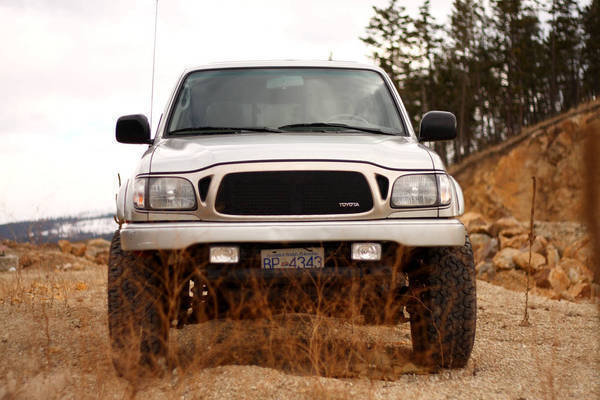

    heres a pic for ya,its rab89's truck
    for the blinkers you could temporarily hang em up out of the way,wire up some new lights to be your blinkers if you want them to be permanent,or you could switch the blinkers to the corner marker lights next to your headlights by switching the green wires around in the wireloom that feeds your blinkers and corners.
