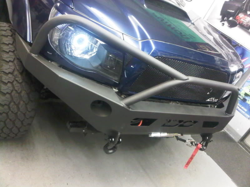

    I recently hit a deer and I'm getting a check from insurance to fix it myself. I want to get either a plate or tube bumper to protect from future damage. I would like to know opinions of which type would best suit my needs and preferences. I think im leaning more toward a plate bumper because they seem to offer better protection but I don't want a ton of weight added either. I want hoops that come up over the grille and headlights, and I want to keep my fog lights. I like the looks of the Aluminess, Relentless, Brute Force, Demello, and Shockworks. I don't like the ARB. I live outside of Pittsburgh and its deer country out here and that's mostly what I want to protect against but a lil extra can't hurt.. Currently have no desire to lift my truck but if ever I do I don't want much 3" max. My factory shocks are worn out and i have a set of 5100's to go on. Throw me some opinions please..

    I'm actually about to build a bumper and am trying to decide the same thing. Plate or tube. I've looked at pictures but have yet to decide. IMO plate will give more coverage but will definitely sag the front end if left stock. However thats a good excuse to do some suspension mods. I'm interested in the opinions from fellow TW members also!

    The majority of energy absorption comes from crumple zones built into the frame and inner fender extensions. In a severe crash, the bumper will get pushed into the front end of the truck. The crumple zones still crumple as usual. Airbags still deploy (sensors are acceleration-based).
    Most 4x4s in Australia (including American vehicles like the Holden Colorado) come with plate bumpers as a genuine OEM accessory. The automakers wouldn't market these bumpers if they voided crash testing results.

    plate bumper ftw. I just got my Demello 3 hoop. It was heavy but even with the winch mounted I was able to lift it on the truck by myself. The bumper is a around 110-120lbs (guessing). The winch is around 63lbs ( comp model XRC8 )

    I really do like the Demello in fact its one of my top picks.. how much did it run you?

    Got it on their group buy it was 1100 shipped or something around there ( to norcal )
