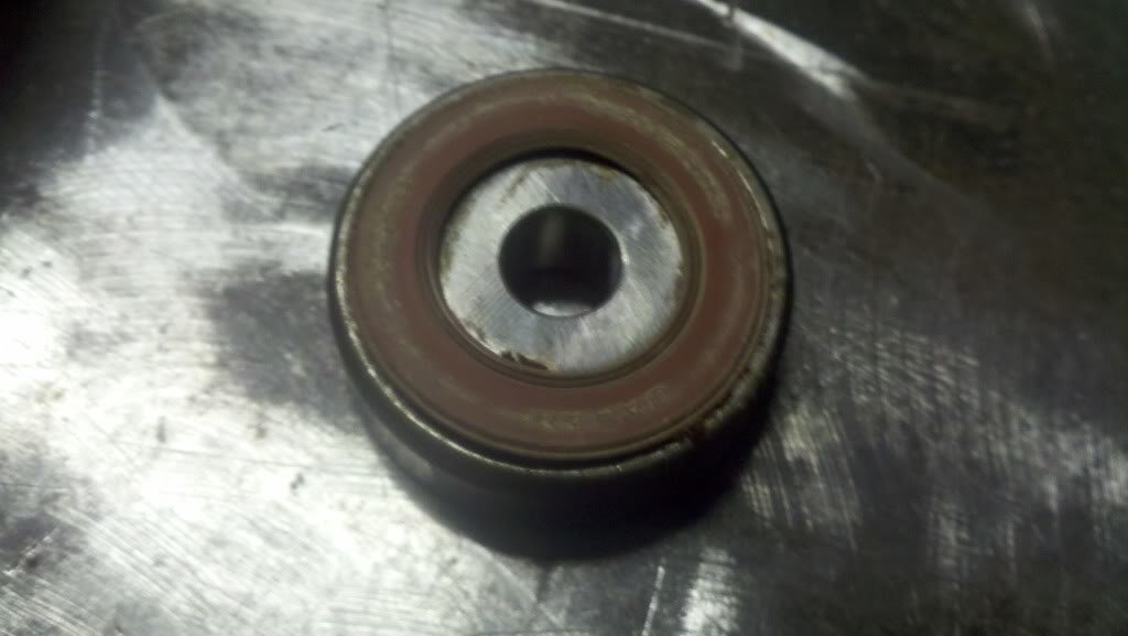

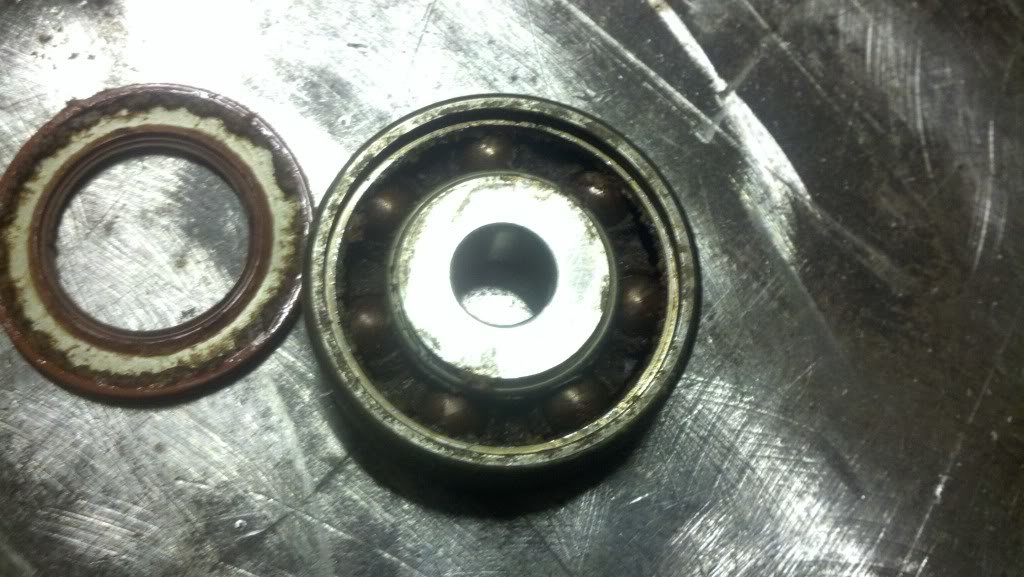

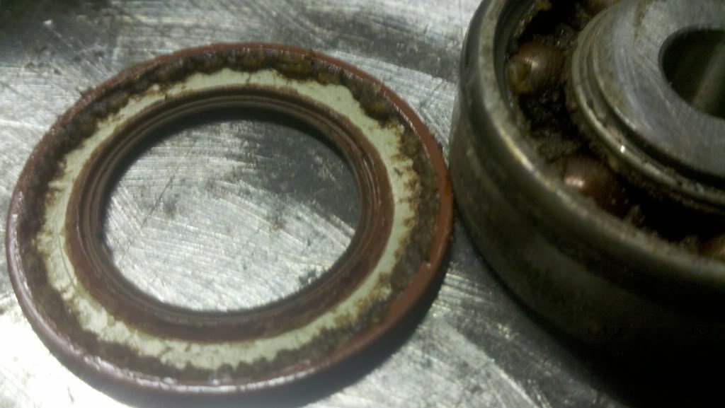

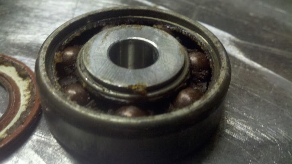

    I did repack the old bearing after pressing it out and this is what I found.
    For the cost I'd just replace it as I don't think you can do a very good job of cleaning and repacking without pressing it out. I just threw mine back in the truck as a spare.

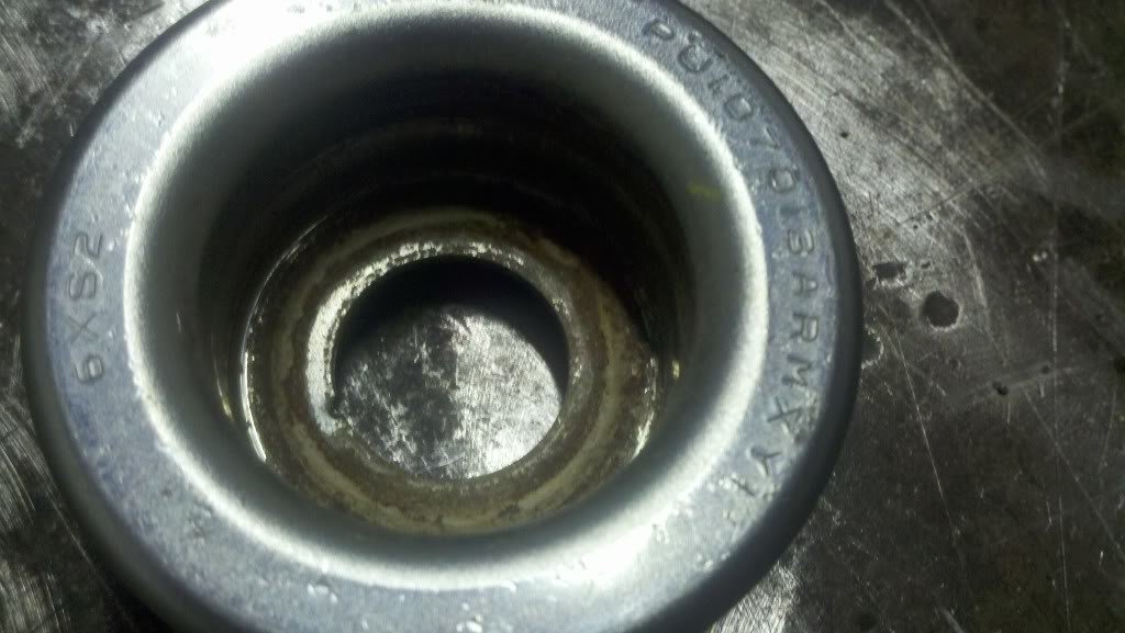

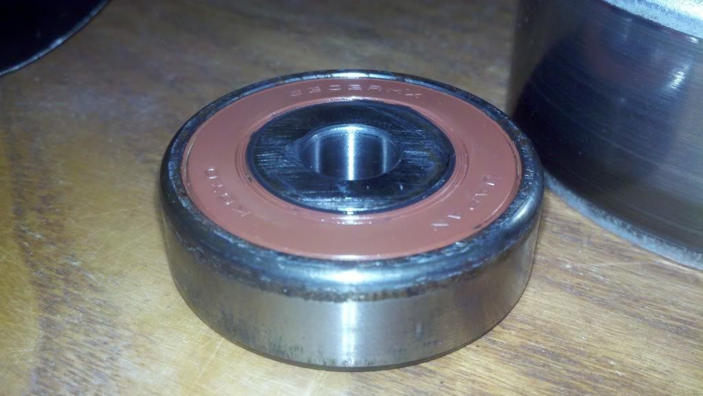

    As an after thought, the bearings in the pulleys are simple 6202 bearings that can be bought at any autoparts store or bearing shop. The problem is, the Toyota bearing shares the same outside diameter as the aftermarket one, but the inside diameter where the bolt holds it to the block is much larger on the aftermarket bearing versus the Toyota one.
    If someone could source the shim that the Gates/RockAuto pulleys come with, it would be just a matter of buying a $5 6202 bearing and pressing it in your pulley. The shim would then reduce the inside diameter of the bearing to that of the bolt that holds it in place.
