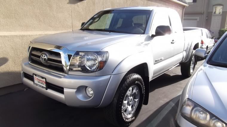

    Hey guys,
    Here's my update. I got back from the stealership with my new 2010 4x4. I hope the wife doesn't mind it if I sleep with her tonight instead.
  11. Jul 4, 2010 at 8:10 PM
    RideFast
    RideFast on the flats.
    Jul 31, 2009
    #20433
    1,145
    Jesse
    Albuquerque New Mexico
    Tacoma
    thats awesome man, you are going to love your truck!
  12. Jul 4, 2010 at 8:13 PM
    Incognito
    Incognito No better friend, no worse enemy
    May 25, 2009
    #17626
    13,752
    VA
    2012 Pyrite AC TRD OR
    Spacer lift, bumper stickers, ejector seat, etc.
    Very nice!
  13. Jul 24, 2010 at 7:15 AM
    tacoma guy
    tacoma guy Well-Known Member
    Jul 8, 2010
    #39944
    1,756
    Joe
    Phoenix Az.
    2011 Tacoma Prerunner TRD
    Bilstein 5100's on all four corners. Front set @ 0 with OME 883x coils. Alcon leaf springs. Viper Alarm. Wet Okole seat covers. WeatherTech Floor liners front and back. Oem Toyota chrome exhaust tip. ARE Shell. America Outlaw Wheels.
    X2 awesome choice and you you will love it. Wecome to T W joe.
