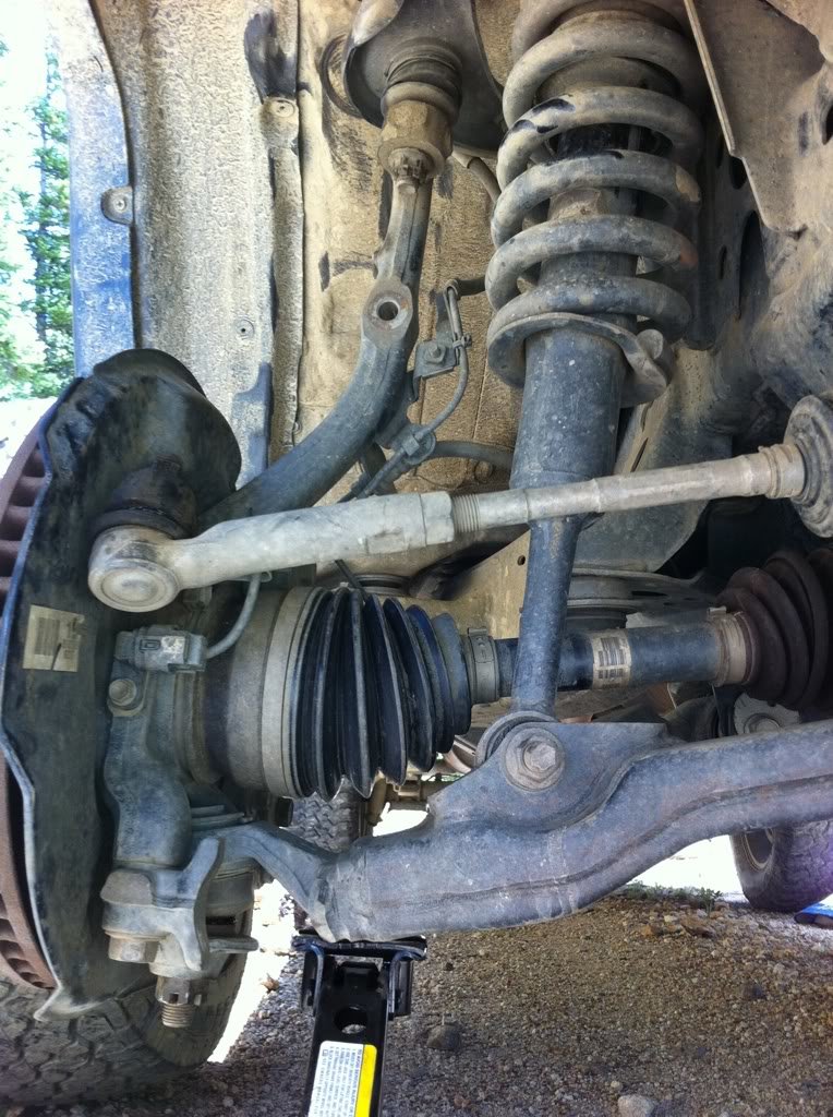

    I couldnt drive it the tire was rubbing so hard it wouldnt move. Even in 4 lo 1st gear the truck wouldnt budge.

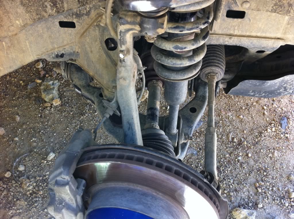

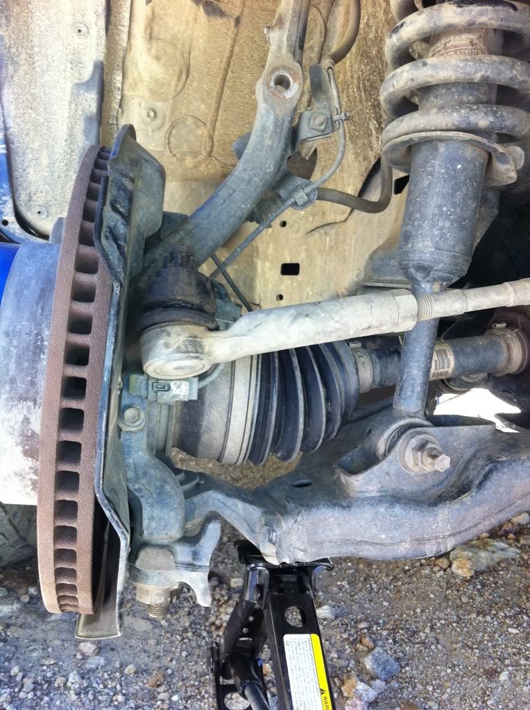

    Made it down. Barely... The wheel spacer gave me about 1" of clearance from the tire to the spindle. allowing it to rotate. started it up and it still wouldnt move. my rear tire was like locked and wouldnt move now. looked at it and the rear passenger U bolts that hold my springs to the axle were pushed back about 4 inches causing my axle to push back as well, making the E break line pinch. 2of4 bolts were loose and I didnt hit anything back there. And last night it didnt do this as I tried to move. Weird. Anyway. got the bolts loose, kicked the axle back and i was back in business!
    The drive down wasnt bad at all. Just my steering alignment is off and hard to control. But I made it with the hazards on!
    More pics.
    Here she was all broken
    04e5cf14_0b5925d67d066e7c828e20e6b17d3d56ed974e97.jpg8cc5c380_b218c43d72c5fe35e0558a5b6f94f9f25c2eb710.jpg853b8dee_9dc10f9f7dc023e4e378e4b1efec55c7cc5a290b.jpg
    Being the only jack I had thats the only place I can jack it up enough to get the tire off.

    Is the spindle hard to replace? Anyone know how much one is?

    It's not that bad. You should replace the bearing and bj's while you're there too.

    Considering he took a hit that moved the rear suspension 4 inches........I'd replace them

    Replace the bearings and seals on the new spindle. Prerunners should be the same. It should not be very hard at all assuming you have basic tools. You remove the brake caliper from the spindle. Then the disc. Then the steering rod, uppper and lower ball joints, and it should come right off. As I mentioned before with the spindles off it is a perfect time to gusset them for additional strength.
