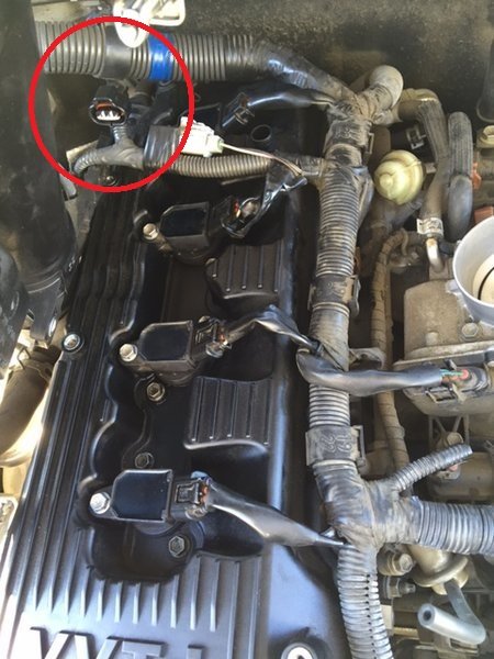

    What is this guy, and is he connected when you try to start it?

    BensonX- yes that plug is plugged in when i try to start the car.
