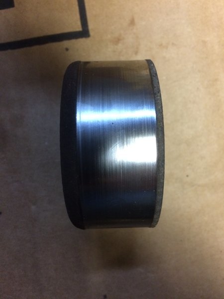

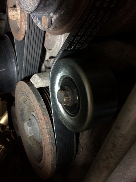

    I just purchased and installed the No.1 Idler pulley. The OEM idler I received was part number 16603-31010. It was the same diameter but not as wide as the original I took off. Now, the outside edge of the belt rides exactly on the outer edge of the new idler. I never compared the width before the install. Seems to be doing alright.
