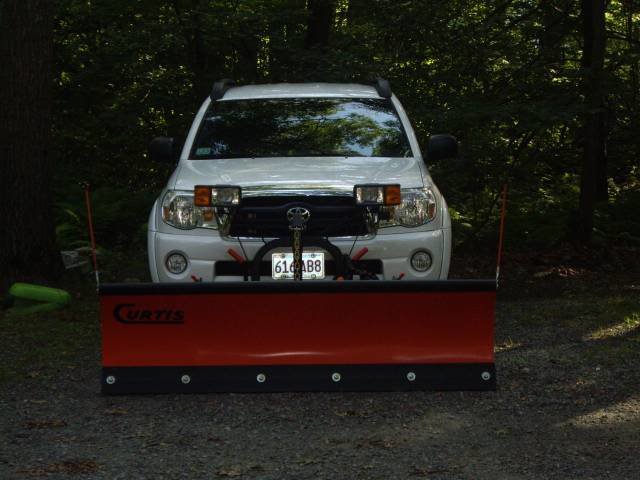

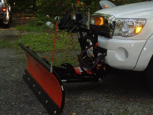

    05 Access Cab 4x4 Base 5sp Man, 16 DCSB 4x4 Sport 6sp Man
    I plow a 900' and a 600' driveway with my 2nd gen Tacoma. This is what I use:
    http://www.snoway.com/index.cfm/act/plow/s/11
    EDIT: See socolax91's post (2 above) for sample photo.
    The Snoway 22 series is a lightweight polycarbonate plow (275lbs for 6'8") but comes with hydraulic down pressure so you can scrape a surface clean. No need for Timbrens.
    If you're just doing your own driveway, you could also get away with a Snowbear system. They're light and cheap at ~$1200. I think Lowes even carries them. This is an electric winch-based system. Spare parts are cheap from Superwinch, but expensive through Snowbear. You could even get a used one on craigslist and buy the mounting kit for your truck separately.
    Personally, I'd steer clear of the Fischer and Western "occasional use" systems like Homesteader and Suburbanite. They cost a little more than the Sno-Way, weigh about the same, and don't have hydraulic down pressure.
