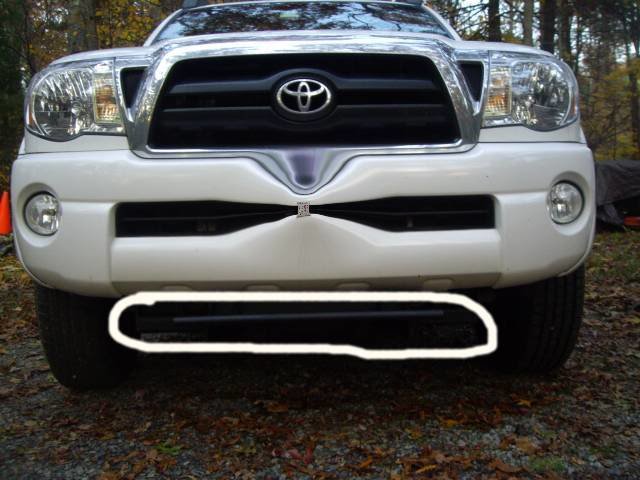

    This how it looks when the plow is off!!
    The frame is painted black.
    You might be able to see it.:D
