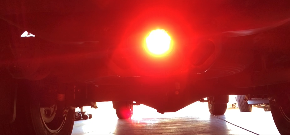

    Black 17 SR5
    Got mine installed with MESO hitch pod and made into a BrakeLight. One bright Light, Yes I painted the clear lens to red.
    BudFriendguy likes this.

    Damn, I bet that is bright!
