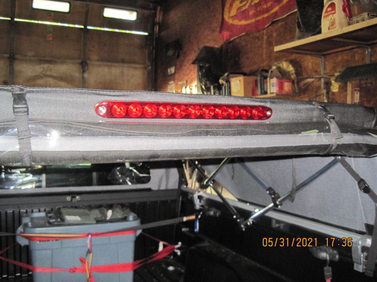

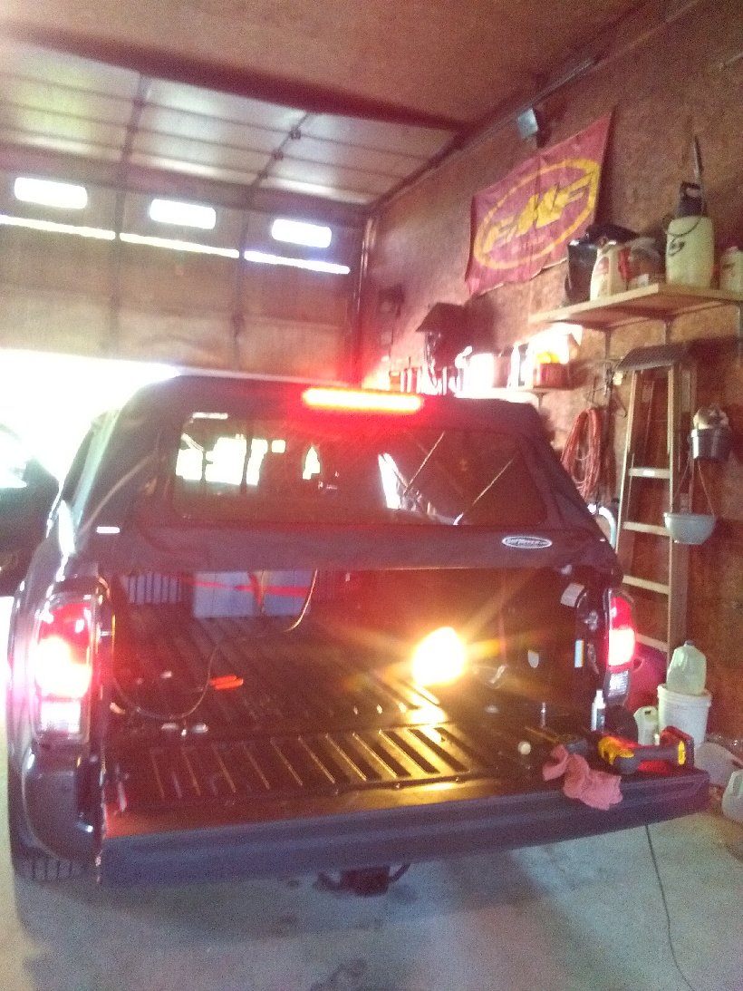

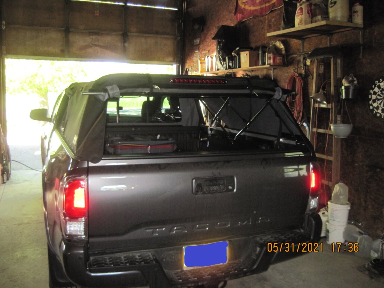

    Used a harness from @Puppypunter this past weekend to install a 3rd brake light on my new Softopper. It was so nice not to have to tap into my OEM harness like I had done on my 2nd gen! Thanks Puppypunter.

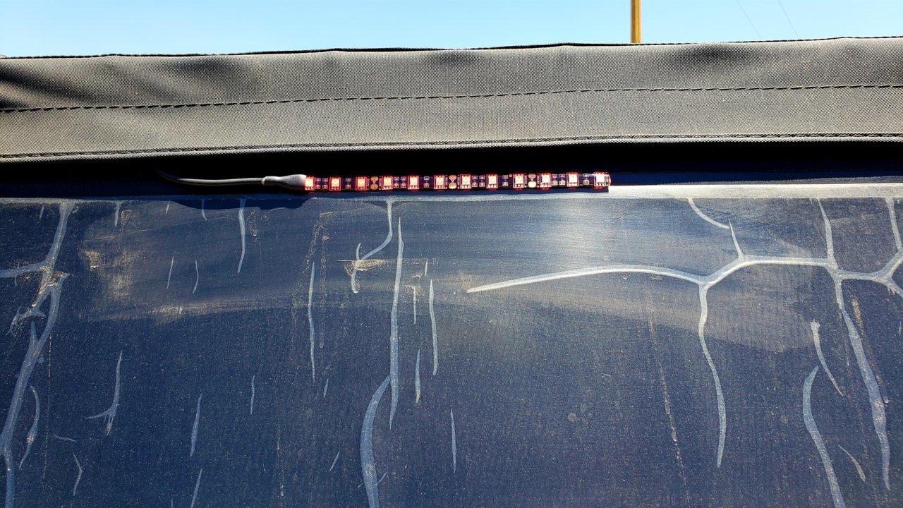

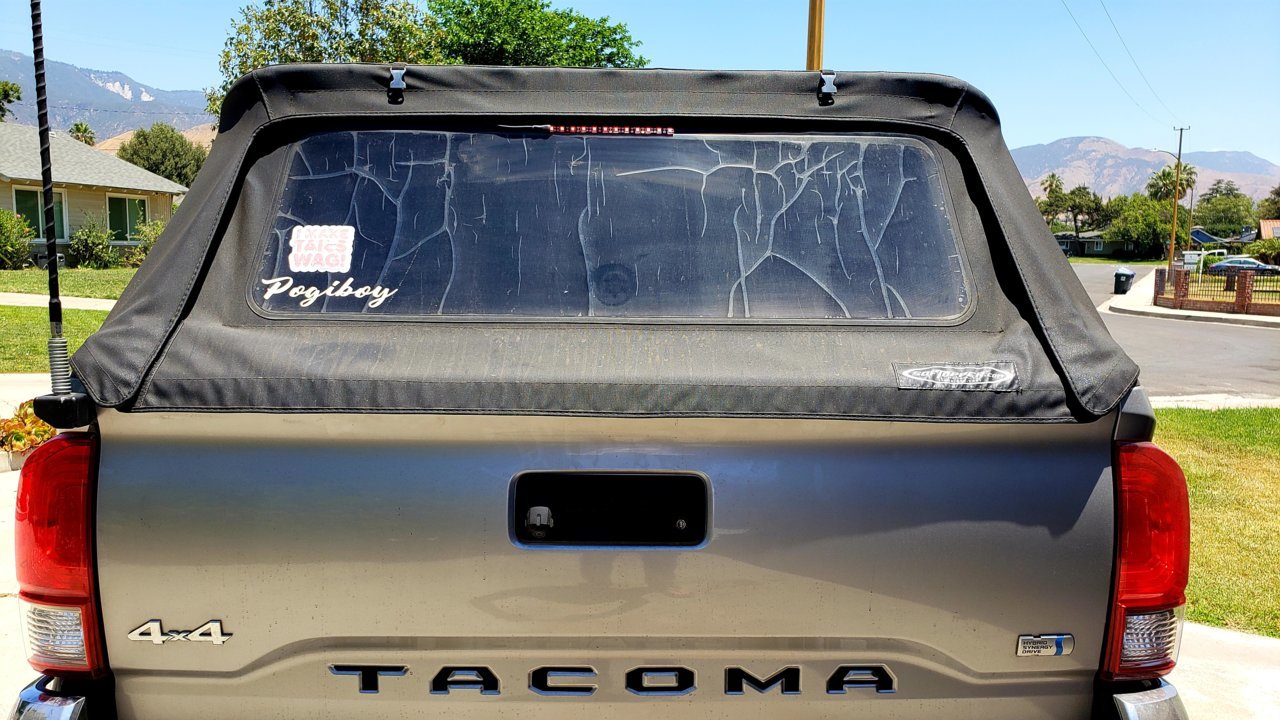

    Super fast shipping. Great product . Thank you @Puppypunter . My first ever something electrical mod ha ha. Now my topper is legal with the 3rd brake light and its a stick on . 20210609_124511.jpg 20210609_124532.jpg
