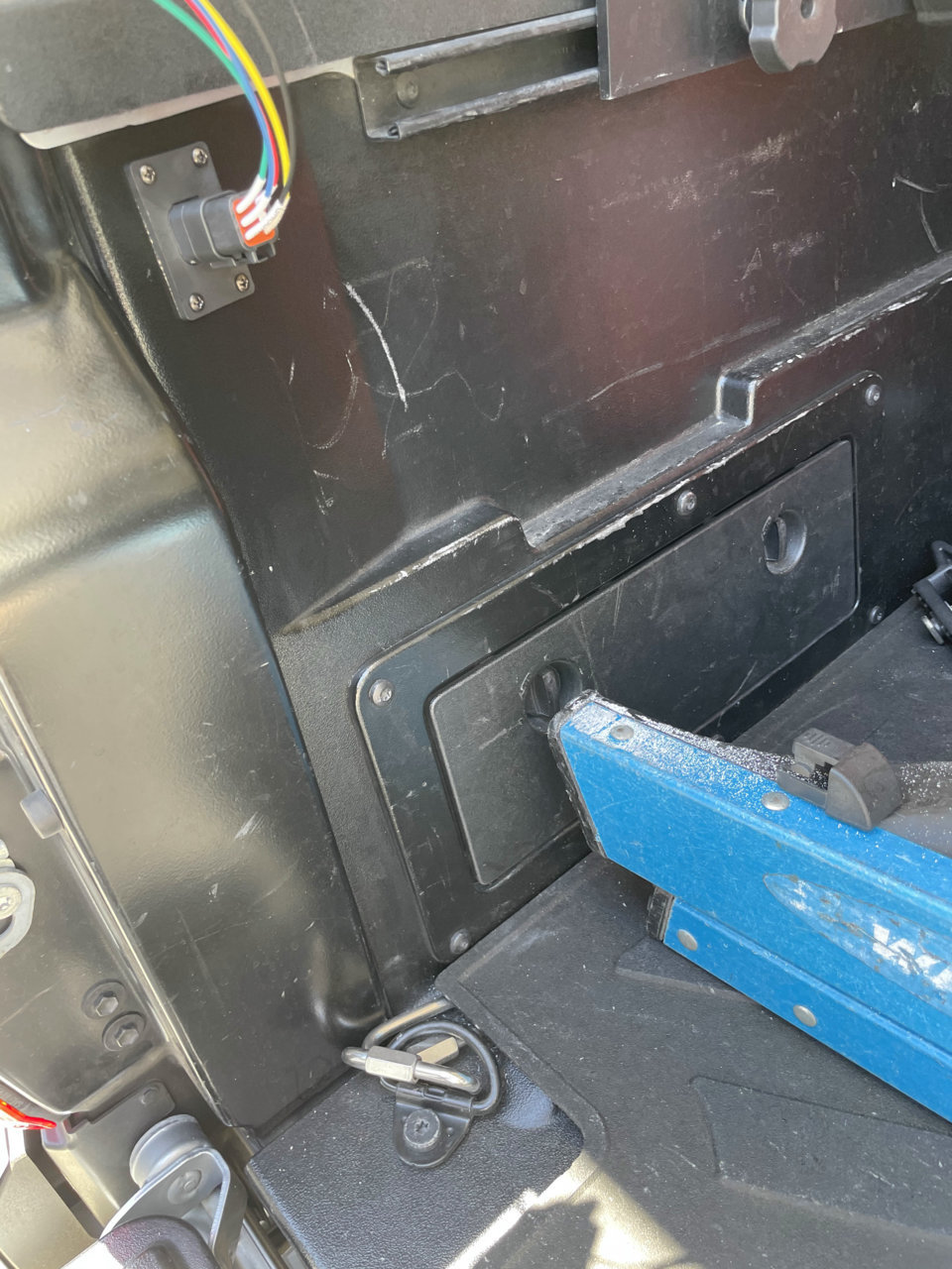

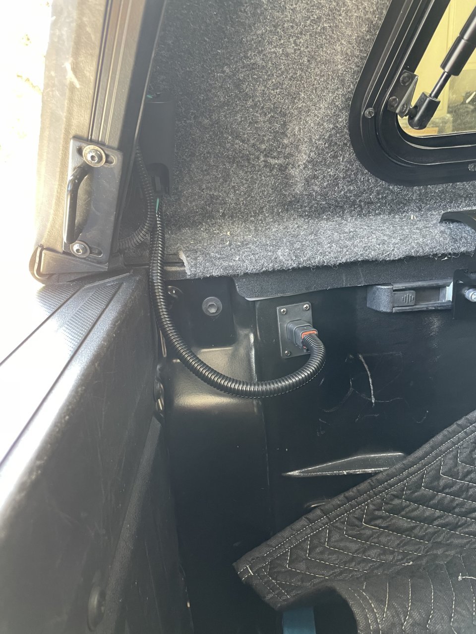

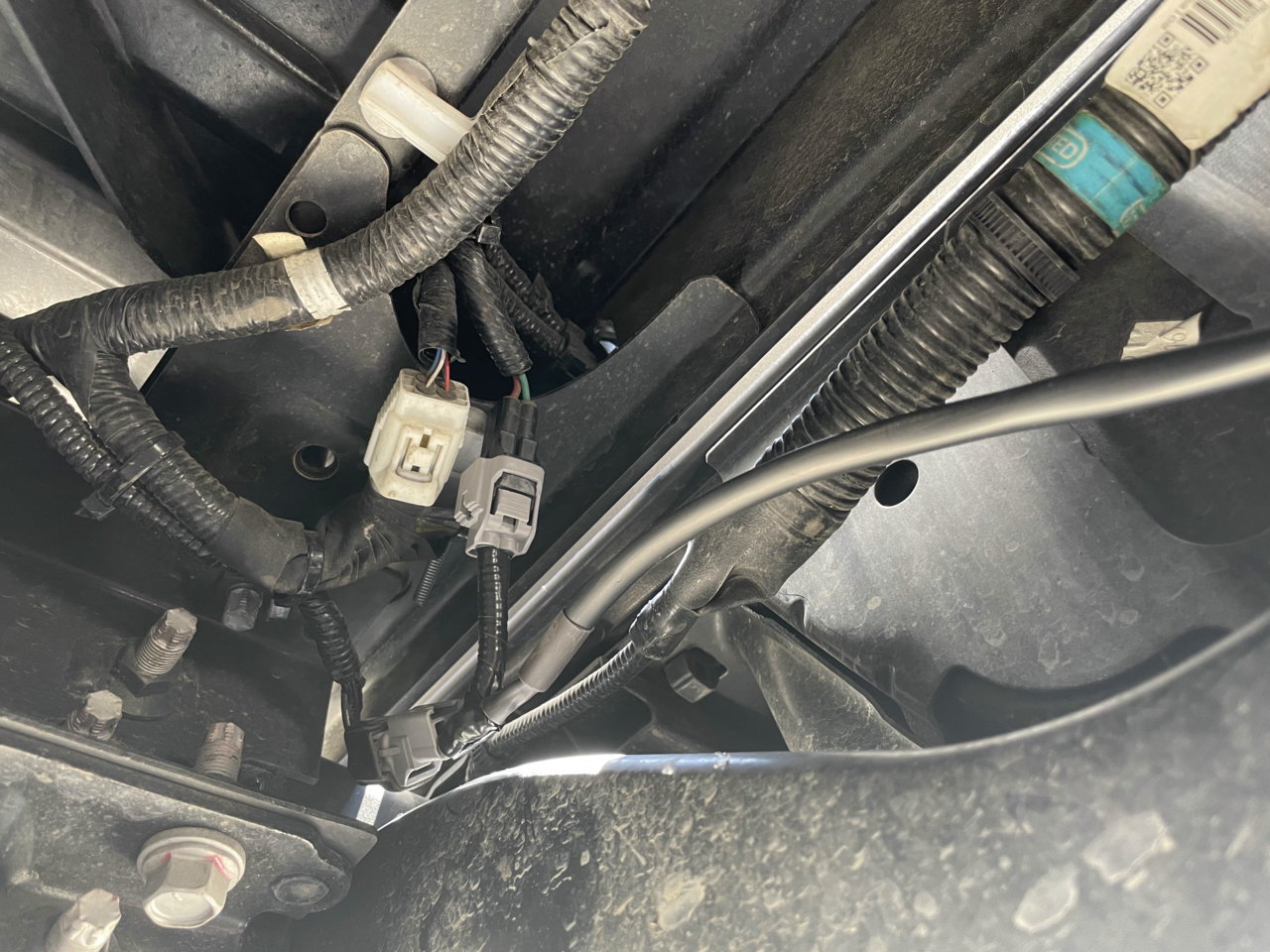

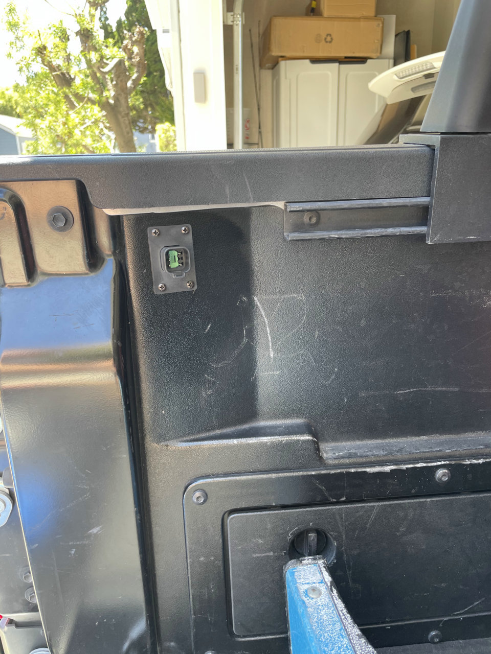

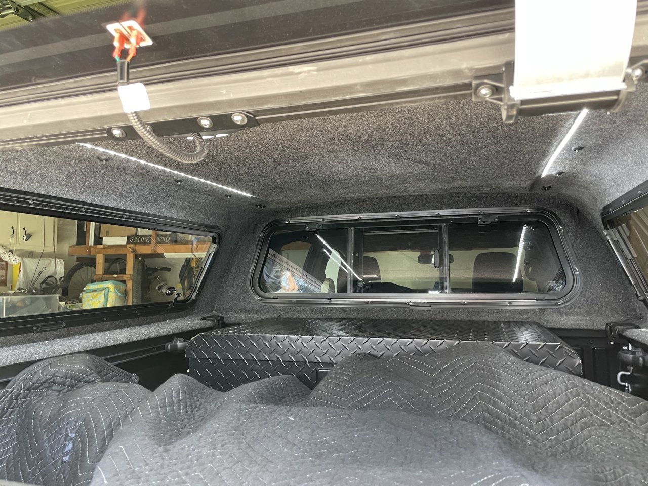

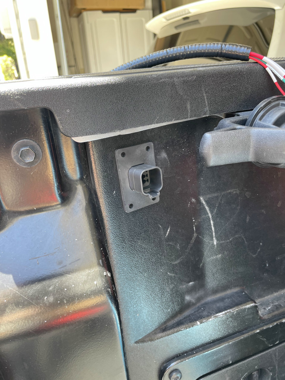

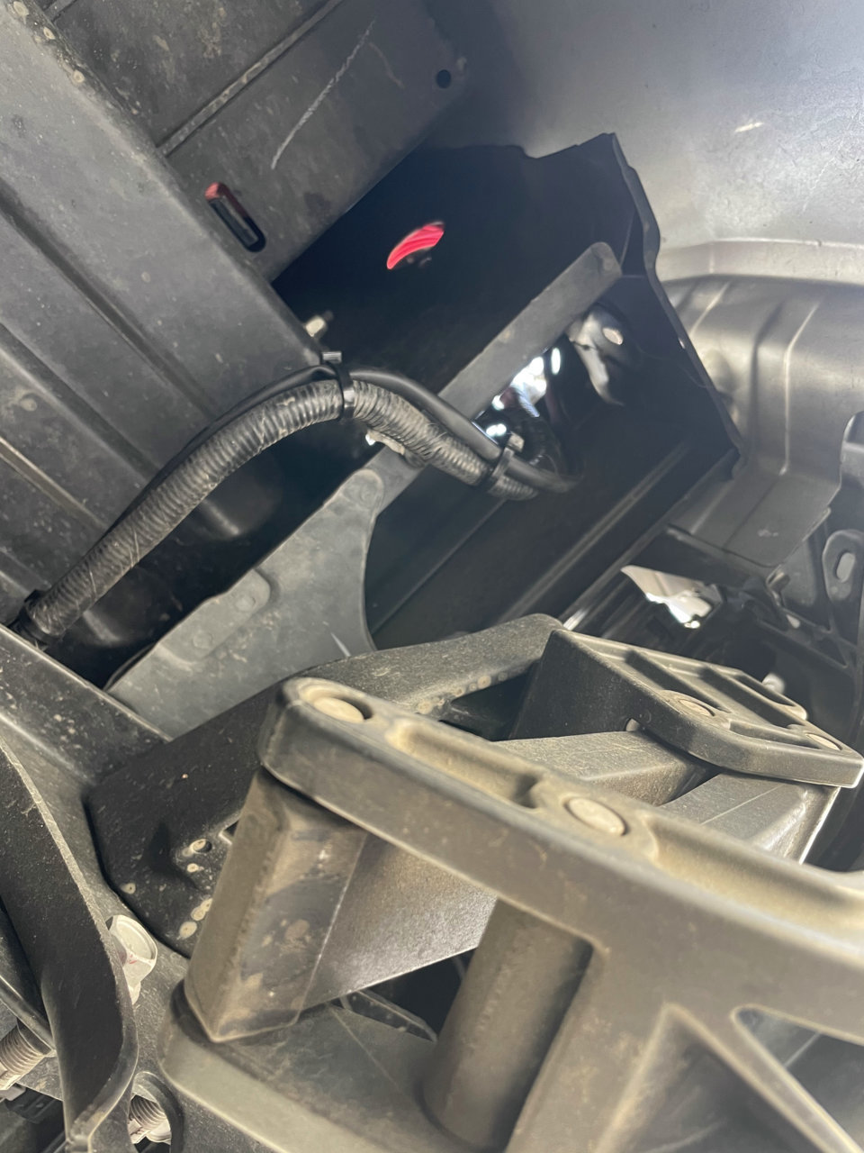

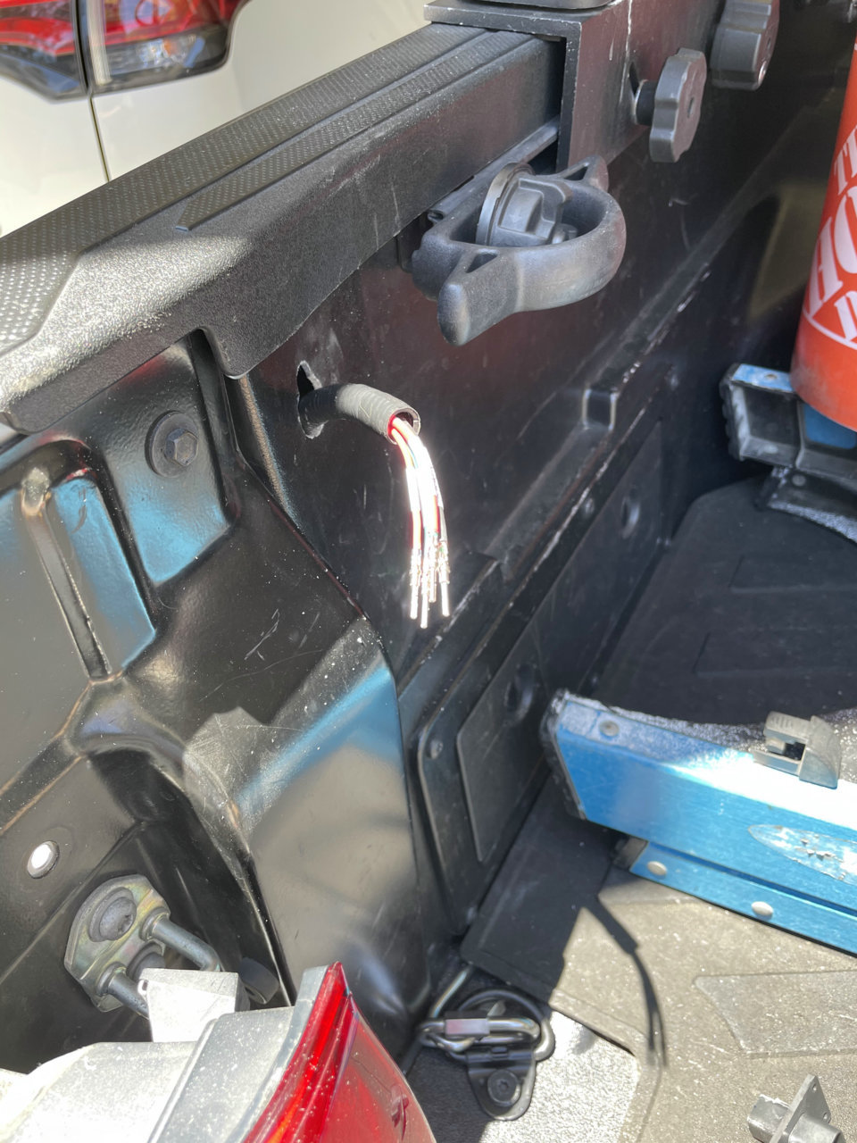

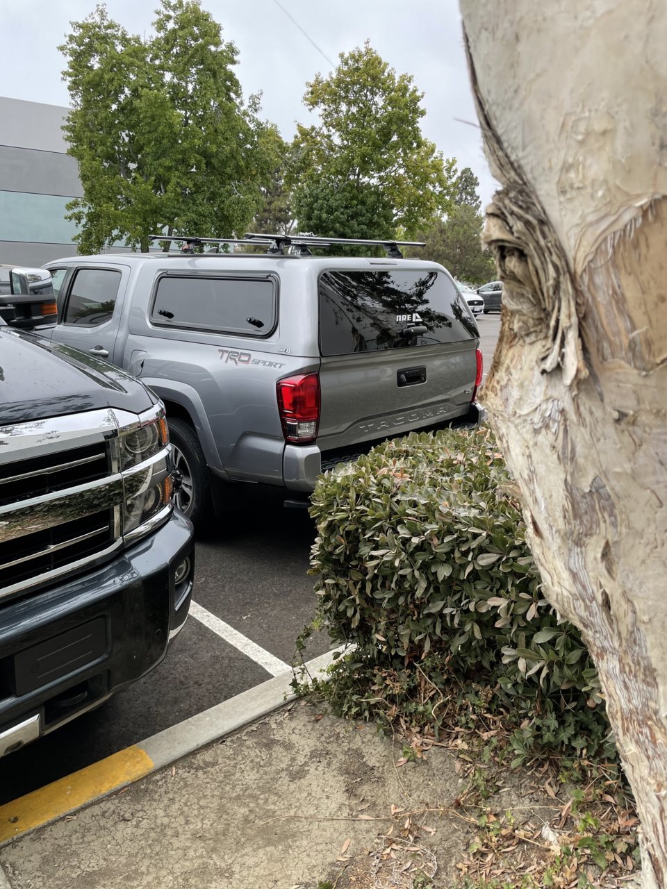

    More photos,
    Got the shell installed. Took the guys about 30 minutes thanks to having the truck pre-wired.

    Thanks for the photos! I may be biased, but it came out really clean I think :) Truck looks good with that topper too :thumbsup:

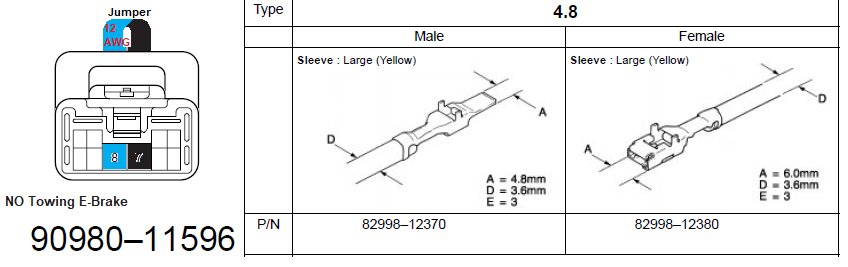

    @Khoadattran take note. Though this is in cab (easy access) vs at the hitch (more work to tap). You can jump it to have always hot to the 7 pin and suck juice from behind, or at least that’s how I understand it.
