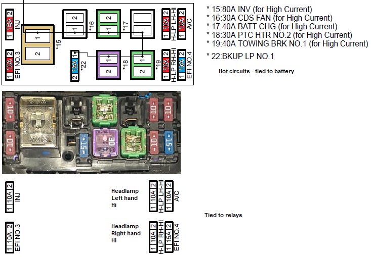

    40 amps. You can lower the LP JCASE fuse to what you require.

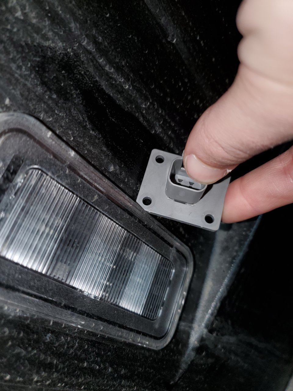

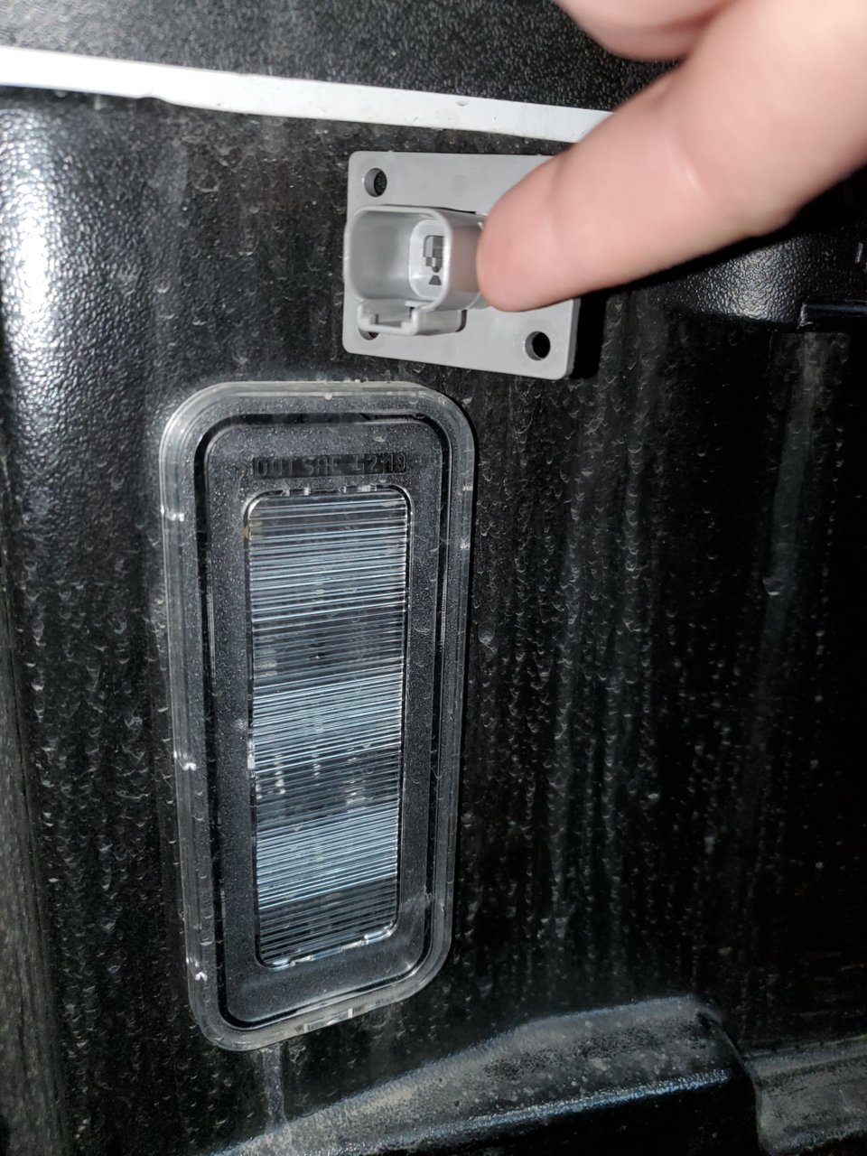

    So I see that you picked the angled part of the composite bed. The only thought I had about taking that spot is it bumps the possibility of 2020+ OEM flush mount bed lighting. I’m trying to decide where I want mine. Hmmm.

    I think you can squeeze both in with the factory light position. Being a 2016 you'll have more flexibility since you get to make the hole for the bed light.

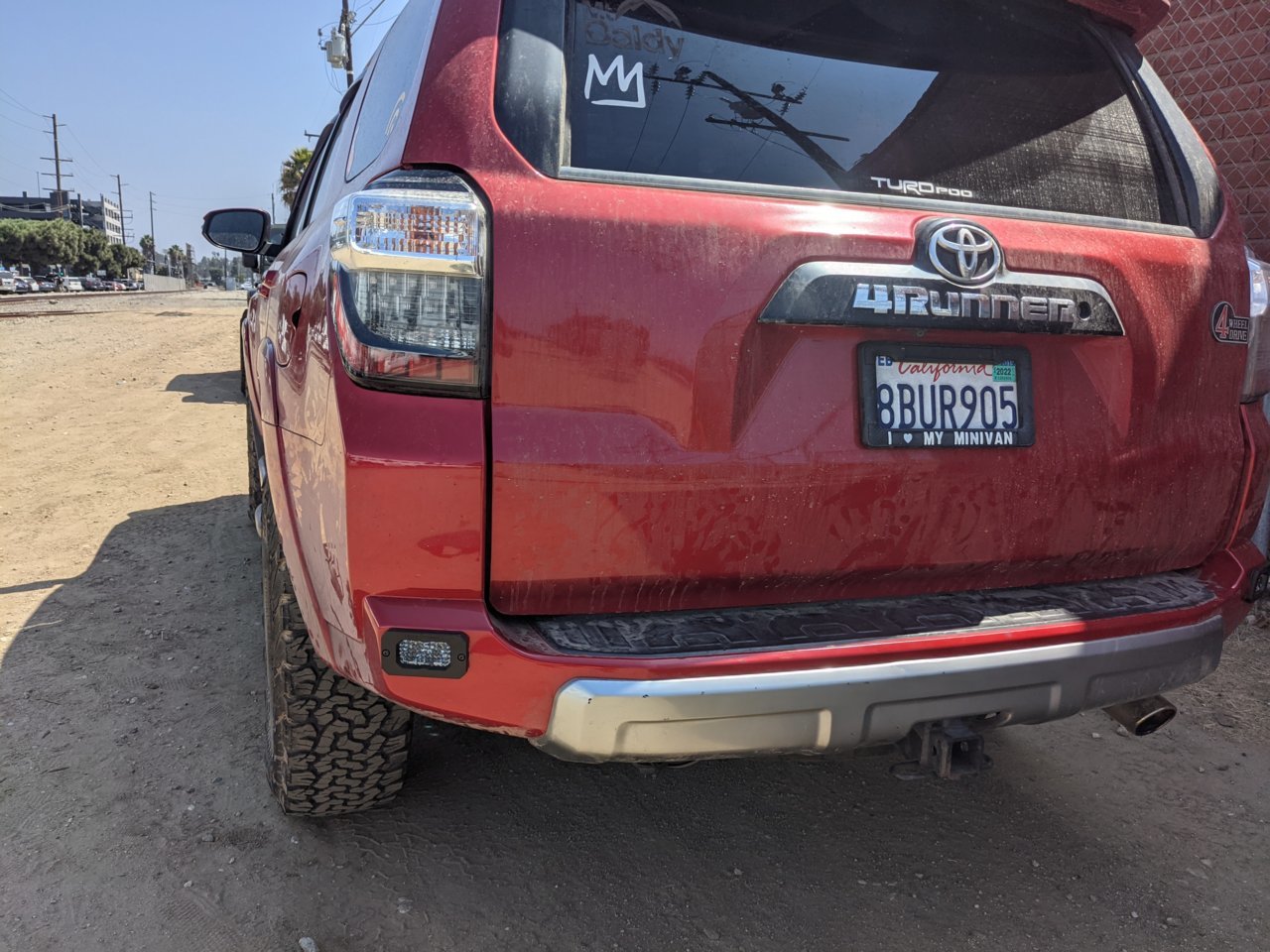

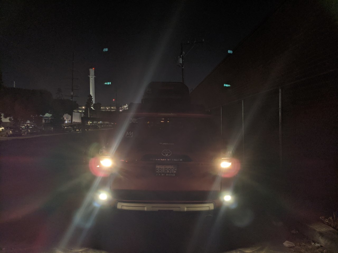

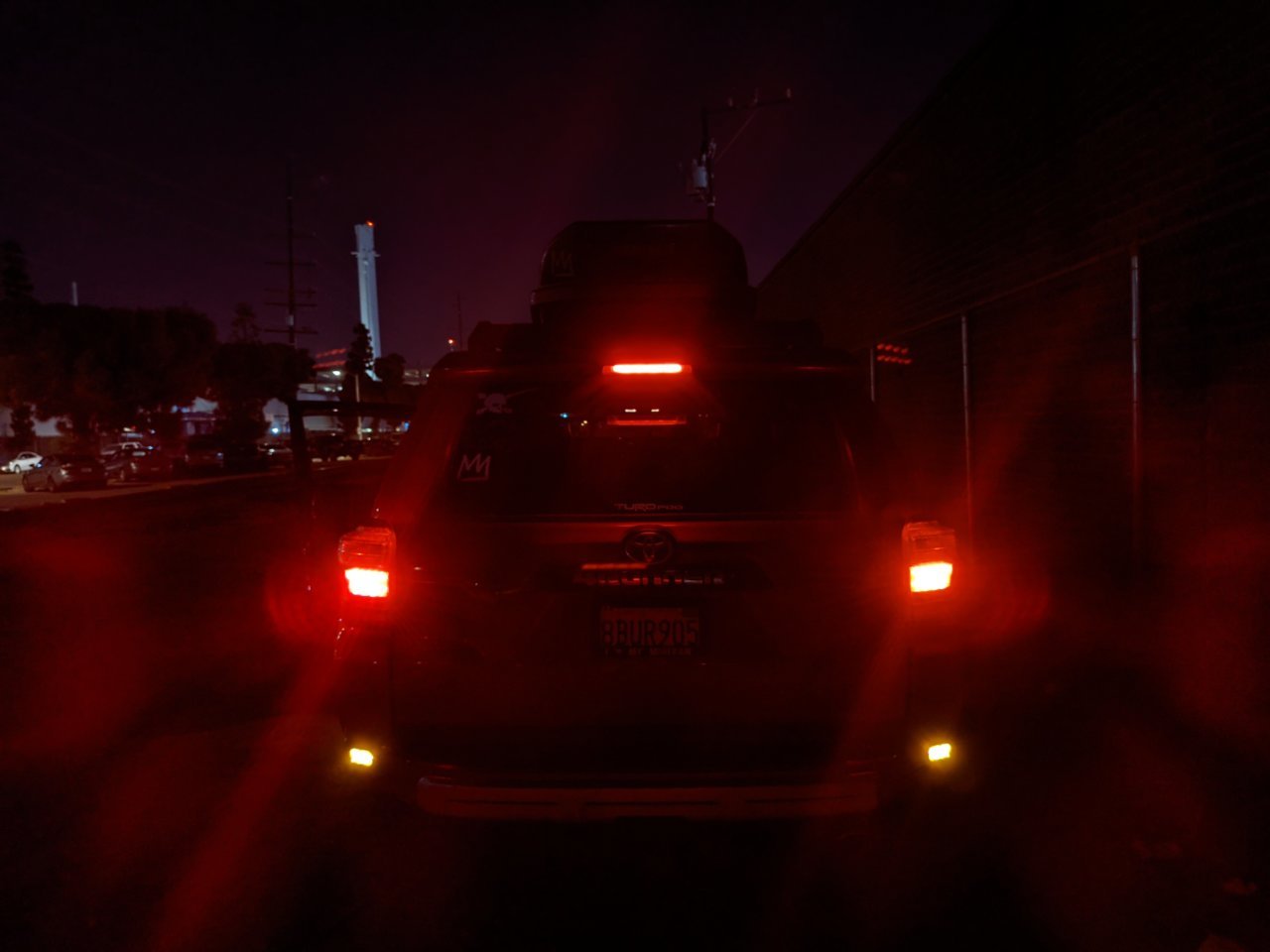

    Very thorough response thank you! So, I've already kinda "cheated" on this one. Rather than looking into taps, I just used a 7-pin trailer plug and wired that to my bumper lights. Instead of a single brake or reverse light, I'm using SSC2 lights that have a dual function. The trailer plug on the 4Runner is sort of tucked under the bumper so it's less obvious than the Tacoma.
    Now technically I should have selected red backlights on these, as you said the trailer circuits work as both brake and turn signal. The white SSC2 lights can be optioned with red, blue, white, or amber backlights. But the yellow lights can only be optioned with amber backlights. I picked these on purpose because they have a warm white 4000K base emitter instead of the 6000K emitters in the white lights. Just a preference thing, I find 6000K lights to be too harsh. The lights have a circuit that turns off the backlight automatically when the main chips kick on, so there's nothing to do other then wire them up.
    I will hit you up if I decide to redo the wiring! Maybe turn them into signal/reverse only.
