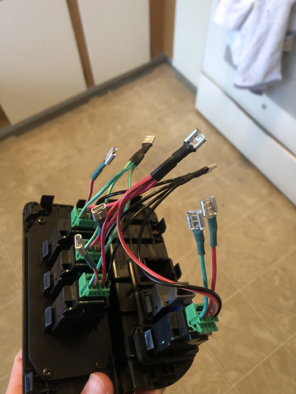

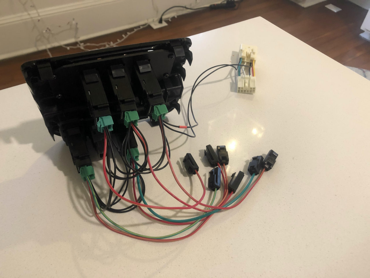

    I just de-pinned the ones off the CH 4x4 switches and got new contacts.
    Contacts p/n IL-AG5-C1-5000
    I’m actually working on jumpers now since I’m replacing the LED colors on my switches to be OEM blue. I’d recommend picking up a couple of Molex or JST connectors for the end of your (+) and (-). Should end up like this:
    Then on your breakout harness you can put the mating part of the Molex or JST so you have a quick disconnect:

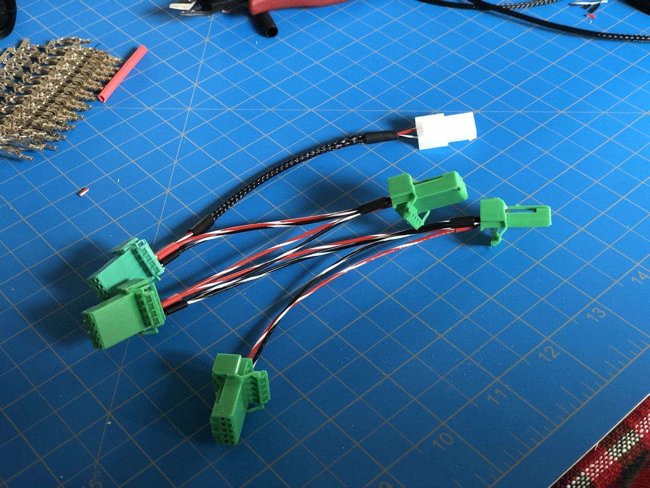

    Coincidentally I also just did a 5-position connector for a Bussmann. For the external connector you can use a metri pack 5-position.
    Male 5pos 12186400
    Female 5pos 12084891
    Position lock 15324857
    Pin 12048159
    Contact (tanged) 12077411
    Green seal 15324982
    For the internal connection just snag a 5pos Molex mini fit jr

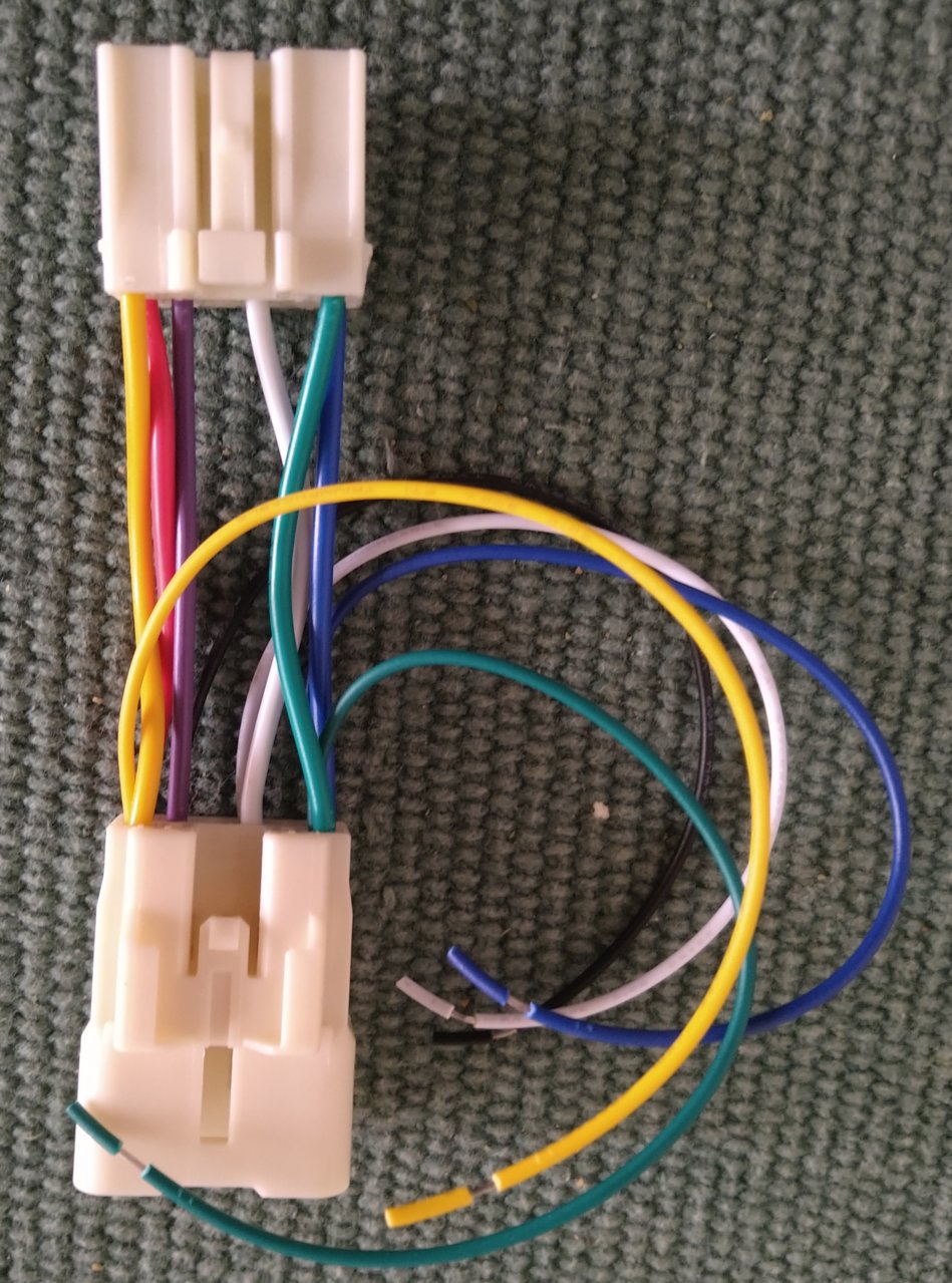

    BUMP...
    Custom one, all wires T'd except Rouge.

    What are the extra wires for?

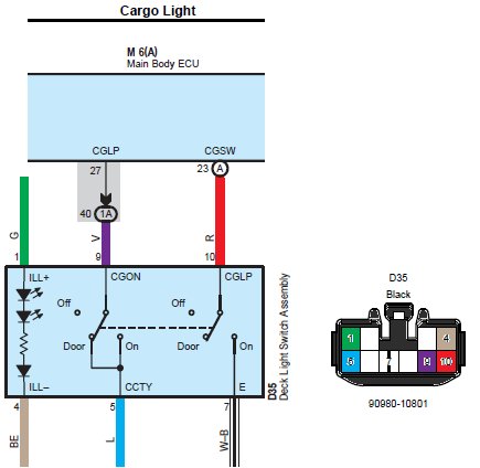

    Blue #5 - read post #51
    Violet #9 is to bypass the switch. Added 2nd Relay (coil -) gets to actuate lamps attached the same as interior illumination.(dome) ON @ unlock and/or door open.
    3rd GEN Added Lamps to Cargo SW
    White with Black stripe (here it's white) #7 is shared chassis ground.
