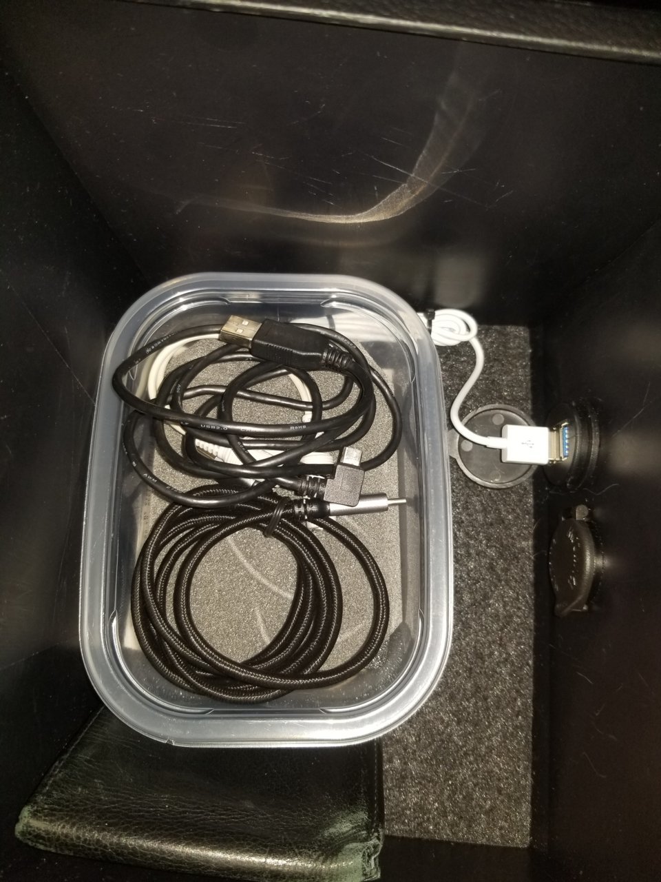

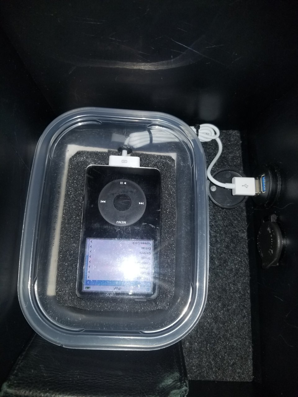

    I think I have it figured out. I had a bad 30 pin usb cable for my ipod. I ordered a 10 pack and, so far, problem solved.
    I gotta say, this is one awesome mod. The ipod is out of the way in the center console. I put it in a throw away piece of "Tupperware" so it doesn't get banged around. I couldn't be happier. I was using this but I've since ordered 2 of these so everything should be Quick Charge 3.0. I haven't installed it yet. I'm waiting for this to arrive and I will. I will have one port available so I'm gonna install this and run the USB cable down to it so it should be Quick Charge too. I was going to build a Frankenmount but thought I'd try the easy way first.
    I decided to leave the OEM accessory plug in the center console and add the dual USB beside of it. It came out looking pretty good.

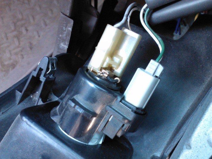

    Much appreciated. But I don't think this is what I had in mind. Here is a photo of the connector at the back of the cigarette lighter (different model, borrowed photo). The lighter has two "blades" on the back that plug into the electrical harness (white plastic in the photo). My thought was to put a junction between the blades at the back of the cigarette lighter and the harness. This would make it possible to draw power off the harness without splicing into the wiring (plug and play). I am sure I have things wrong, many thanks for the education!

    That’s absolutely what you can do, spade connectors will fit. But the negative is the standard size spade (what ever that is), the positive is one size smaller. Just easier to use posi-taps for a T connection then you’re not messing around trying to find the right size spade for the positive.

    Posi-taps are the way to go. You'd only be punching a small hole in the wire. Remove the posi-tap and no harm no foul.

    You would not want to do this because it runs the risk of too much draw through the existing wires. At best you'd blow fuses. Any additional power ports(including a usb charge port) should have a dedicated hot lead coming from a fused source such as an add-a-fuse keeping in mind the total current on that fuse slot.
