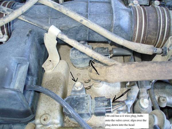

    Distributorless Ignition System= D.I.S.:D

    I have these, no wires whatsoever. They run right from the wiring harness and slip over the plug down in through the top of the valve cover.

    :eek:
    how does that work

    LOL.... give me a few I will go out and get a pic for you guys.

    Ok, here ya go. Look on top of the valve cover you can see where it is bolted down and has a 4 wire plug. The plug is down in the head, the coil pack slips down into the head and then it bolts down, then plug it in...

    whoa... thats strange. So it lasts longer then?

    Damn I hope so, those things are $80 each to replace. Good thing is, you can do one at a time or all.
