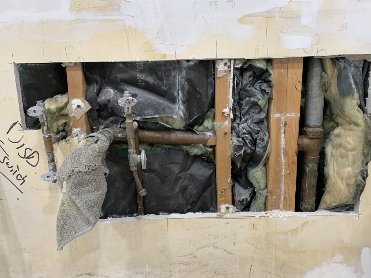

    Here’s what I’m looking at.
    Can I cut the copper drain pipe the need drop use a fernco tee and then extend a piece of pvc up to the iron vent pipe?

    id say cut it and go, only consideration I'd hope that wall isnt load bearing since you'd have to oblong or cut a new hole for the pipe.

    What’s up with the dual valves on the hot and cold? One set to the sink and the others went where?

    Im surprised it hasnt leaked somewhere, with the galvanized and copper pipes going.

    Dishwasher and water line for fridge.

    Would a deeper than normal p trap work? Just thinking outside the box. I wouldn't want to weaken the wall with more holes through the studs.

    May seem weird but is that right above a basement or crawl space? I mean you might be able to just keep that copper as the vent tube and then plumb a fresh drain straight down and connect in the basement area.

    Dont use a fernco tee!!!
    If the steel pipe goes up threw the roof above your kitchen then replace it with plastic. If its a wet vent ( something else drains to it above ) then your kinda screwed. Are you installing a garbage disposal?
    Im a plumber, if you want I could give you more advice
