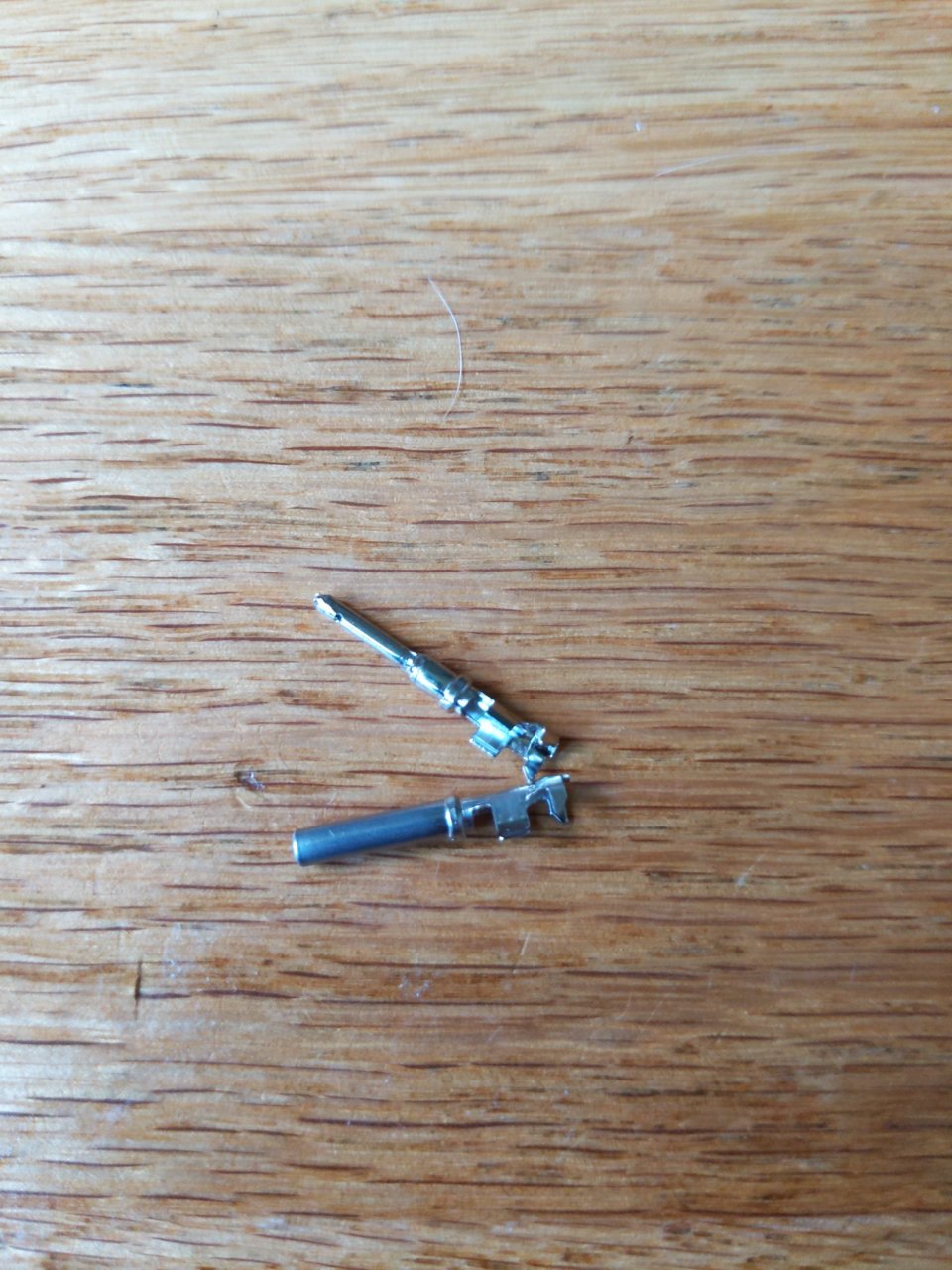

    The connectors I bought looked like this
    I was able to fold over the pins with the needle nose and then crimp them on harder. After that I soldered them together. They aren't going anywhere. I've seen ones that just have a barrel type opening which I would guess you'd need the special tools for that (or just smash it and solder it)
    Regardless, I recommend soldering as well as crimping as it just creates another permanent bond

    Where did you pick those up? I assume there's different sizes for different gauge wire? Or are they all the same?

    DT02 connectors work with 14-16AWG wire. I used 14AWG to power my components and 18AWG for my switch harness. The 18AWG was tight (loose), but I just used more solder :p
    I purchased my connectors from eBay, seller alab.engr, but there are many sellers of deutsch connectors on eBay

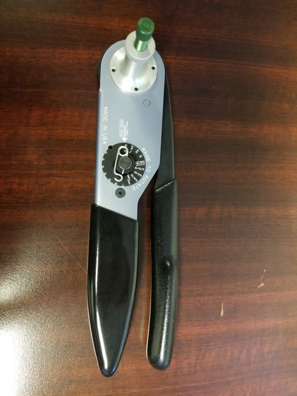

    I caved... I found a killer deal on the (legit) crimping tool, and I'm a tool junkie.
    If you or anyone else has a wiring project that uses Deutsch connectors, hit me up and I'll loan it out.
