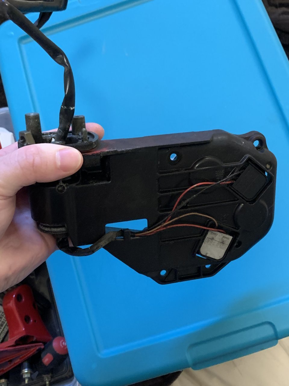

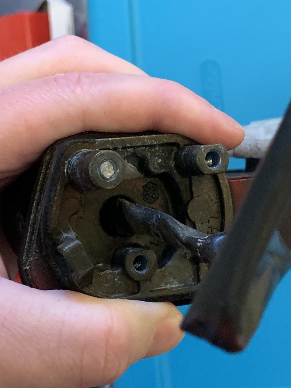

    Anyone in the PDX area have a lead on how I could get 4 snapped bolts drilled out and tapped? Any and all suggestions welcome.
    For context, I was trying to remove the side mirror housing to install new led mirror covers, and the bolts that hold the foldable section on are soft af and loctited from the factory. I used a soldering iron to heat them up and hit with an impact, but still snapped a couple. Then I snapped a couple harbor freight extractors (expected, i know) trying to get them out with no luck.

    Wish you were closer, have a bunch of extraction tools, do you have a picture of the broken bolts?

    Hey Justin, thanks for the reply!
    Here’s a picture of one of the bolts stuck in there. The other mirror has all three snapped off unfortunately.

    Hacksaw and slot it and try a screwdriver?

    Thanks everyone for your suggestions, I appreciate that you took the time.
    Definitely a good idea to get quality extractors. The harbor freight ones I used at first broke when I was trying to extract the screws on the other mirror.
    These screws are the softest metal, but so stubborn! I've even heated them up to loosen the locktite.
    Because I have other mirrors, this is a side project and I'm at a point where I have a hard time justifying the purchase of quality extractors or a good tap/die set.
    I'm leaning towards bringing them to a machine shop if anyone can refer me to one near pdx.
    I wish it was! lol but yeah, might have to get some of those
    I tried that method on the other mirror, but it tore the exposed half of the screw apart. I swear these screws are like a tube of play-doh with a titanium loc-tite shell.
