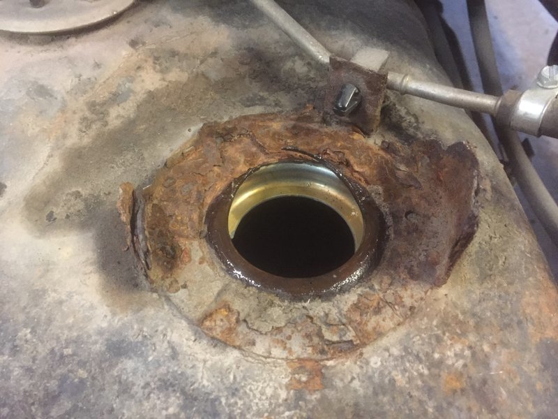

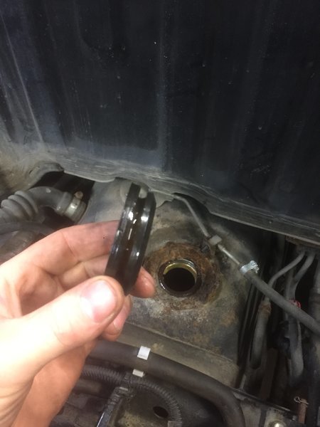

    So finally an update to my CEL woes. I've been driving my beater jeep while the taco has been parked for winter. Pulled the bed off and found this:
    What you're seeing is a rusted flange surrounding what I am guessing is some kind of vapor port for the charcoal canister. After pulling it out(press fit-no turning), I found this:
    You can see that the lip of the tank where the seal goes is rusted out and is most likely the culprit causing my EVAP leak. I can easily push the one way vapor valve and rubber gasket back in and it is very loose. I am guessing my best bet it to buy a new tank and gasket set. Replacing the tank shouldn't be too bad with the bed off, just wasn't expecting such a $$$ repair.:annoyed:
    Additional pics:

    Replacing the tank got rid of the evap leak codes. It turned out the leak around the rusty hole in the tank was the culprit. These evap leak codes can come from anywhere in the evap system though.
