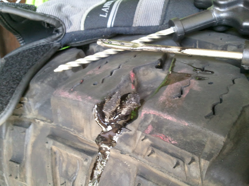

    I think I found an even simpler and safer way. The rasp tool pictured below allows one to "twist" the tool inside the tire easily, like a drill bit, and then pull straight out to complete the rasp function. I did that about 3 times today and called it good. Worked well. :thumbsup:

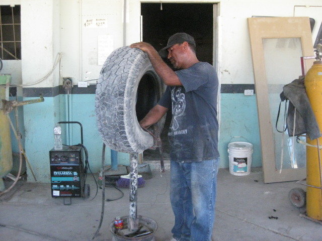

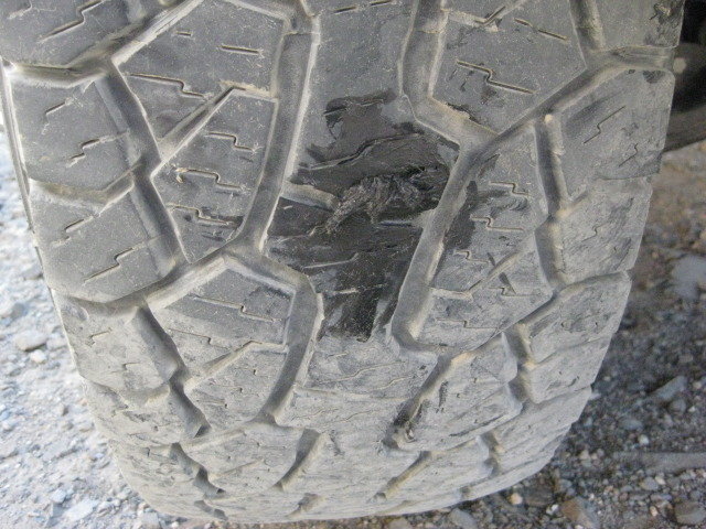

    I had one flat on my Baja trip, and it turned out to be in the same place and same tire as the only other flat I had... So, either the patch failed or lightning strikes twice in the same place! I have the same plug kit, and it took three plugs to stop the air escape... twice.
    Hole repaired near Coco's Corner.
    Patched, at Gonzaga Bay.
