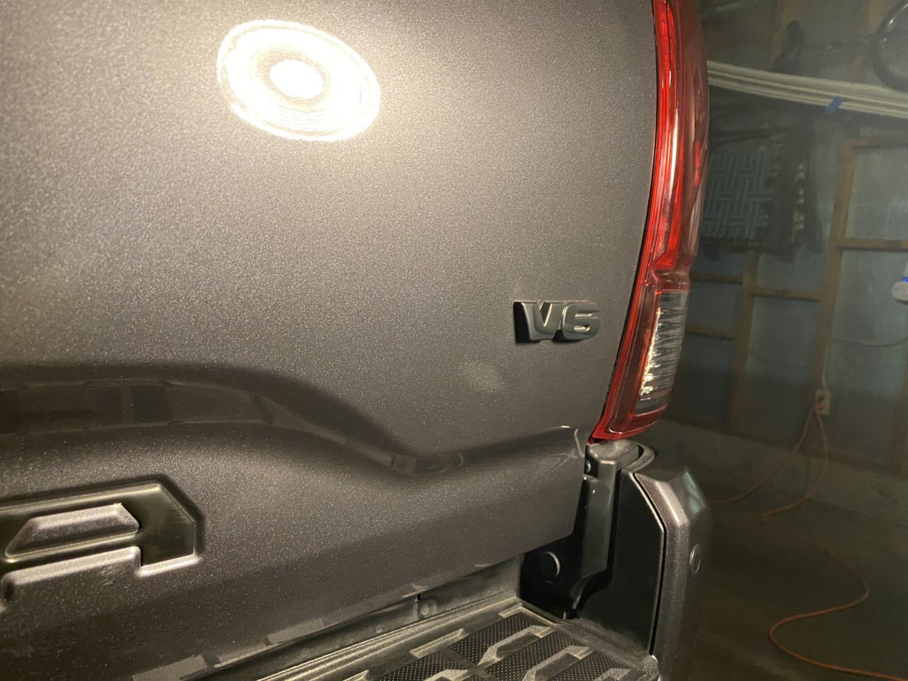

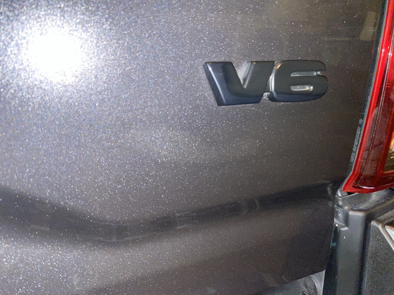

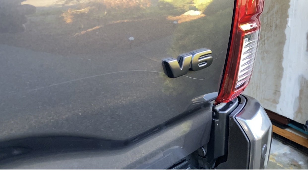

    D541F9FD-EDCE-4EDD-827A-9B19708729E6.jpg EDD23421-B126-4B0E-B098-0B14CBCFDA8B.jpg 2F084082-34EB-47C7-9BD1-DD2E757335DD.jpg So attempting to fix a scratch (which I did fix) I may have burned a small part of the tailgate clear coat. Using a random orbital DA with polishing/cutting pad and griots garage fast correcting cream. Was barely even putting much pressure on it either. Is the paint really that thin? Attached are some photos. Is there anything I should do/can do to fix this? I’m really not too worried about it and you can barely see it unless you really look and I’m not looking to sell my truck. Thanks. (Also photo of before scratch).

    I don't believe it's so much that's paints that thin but more that you have to be very careful with a buffer.

    I doubt it’s permanent. Have some good wax? Hand wax it.

    It’s a burn, been there with my MGM. Coincidentally I got in a fender bender with a tree so had it resprayed at the same time.

    Rubbing compound should knock that right out. Apply it on with a small circular microfiber hand sponge and rub it out in a circular motion using mild pressure.

    Very hard to burn paint with a DA especially one that freely rotates like the porter cable, harbor freight, Meg’s, or cheaper griots. They will almost always stall before it gets to that point. A forced rotation DA will do it but you almost have to be deliberate. But I agree that looks like rotary burn.

    Hang on, am I looking at that scratch in the first picture or am I looking at the spot which is notable in the second picture which you are wanting to correct?

    Looks like you hit basecoat? Burned the clear. What’s the final outcome?

    Looks like a shadow burn, just move the emblem over top of it or re clear it.

    If you burned through the clear coat, trying to use rubbing compound on it will make matters worse not better. There's no way you can add back clear coat through rubbing away on non existant clear coat since it's already burned through and now you're at base coat.
    Definitely looks like rotary burn. Very difficult to do that with a DA or OA unless you caught the edge of the pad.
    Instead of spending the $14 on rubbing compound, it'd spend $21 on this to confirm it's burned through

    You can have an experienced painter blend the clear and or back tape it and spray a little clear. A painter will know how to do it. Good thing it not on a top surface because blending the clear wont last long.

    Your tailgate Needs to be refinished. No open blend no rubbing compound. Go to a Bodyshop. I’ve been a painter for 30 yrs. sorry for the bad news. Or put a sticker over it.

    Looks like cooked on product to me. Get a dot of product on a MF towel and use your finger to try to remove part of it.

    So I don’t really mind the blemish. More of a learning mistake for me. This won’t be open to rusting down the line will it? That’s what I’m mainly worried about. I probably will relocate the badge or maybe put on a collegiate metal badge over it or something.
