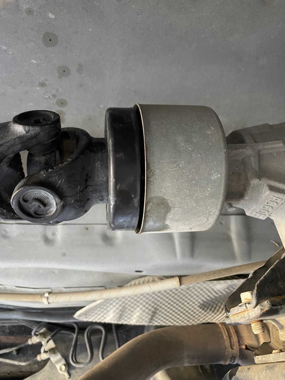

    2016 2wd DCSB here. Just diagnosed my driveline vibrations to the front yoke. Somehow, my driveline is ‘too short’ or my rear axle has moved to the rear about an inch. I can’t seem to understand the how/why. I will post a photo of the front yoke where the driveshaft meets the transmission output shaft.
    With the rear flange disconnected and the carrier bearing bolts loose, I can push the driveshaft all the way forward. But then there is about a 1” gap at the rear driveshaft flange and differential.
    There is a violent shake at 20-25mph and again at 50mph. A noticeable vibration at all speeds otherwise.
    Not sure what my solution is going to be.
    Suspension details: front-king ext shocks w/TC UCA. Rear- Deaver stage 3 with hammer hangers and king ext shocks.
    Help….
