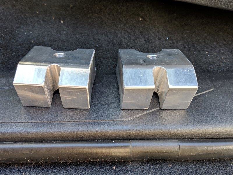

    6/12/2019 Edit: IN STOCK AND READY TO SHIP. See HERE for final design and order information.
    MODs if this is not the right subforum let me know, it's been awhile since I've posted so I'm a little rusty on protocol.

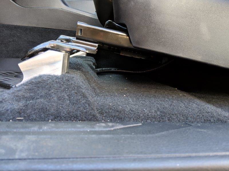

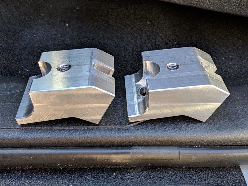

    A friend of mine machined front seat risers for his 2018 Tacoma and they turned out great. Not surprising since he has some sweet machines (Minimill and VFOE).
    We're trying to gauge interest to see if it's worth the time and effort to machine a few sets. Right now he's only doing the front risers but he could pretty easily do rear risers as well.

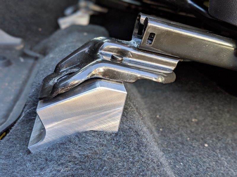

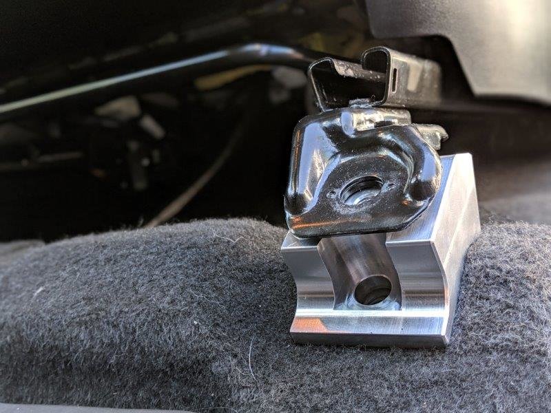

    The trick to the front risers is the offset bolt spacing and the almost parallelogram shape needed to lay flat and match the contour of the floor/seat.
    TBD on if they will fit 2nd Gen but they probably will.

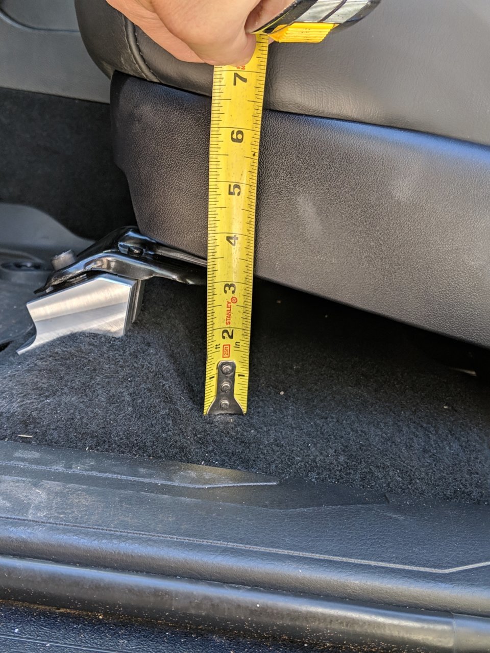

    -1-1/4" Lift (that's the minimum lift due to bolt offset)
    -7075 Aluminum
    -Raw or Powder Coated
    -Hardware TBD but he's using grade 8 3/8s course thread.
    Anyway, here are some pics....

    Would be interested but that’s a lot of liability on you guys if someone gets into an accident and these fail causing bodily harm. Just something to think about if you’re going to mass produce these.

    Nice! Not trying to bash. But since the topic of safety has been brought up. It looks unsafe......
    But this is something I've been waiting on for a while. So I'm assuming the front hole of the spacer bolts into the cab and the top hole is to mount the seat? I wonder if the variation of rear seat risers pose an issue of the fitment for these spacers and vice versa. Kudos to you guys for coming up with something a lot of people have been asking for.

    My biggest issue is that they're aluminum (i.e. breaks before bending), that's not a lot metal in the front, and you just created a fulcrum in the event of a side impact by offsetting the bolts. The carpet isn't going to hold the spacer in place if you put a lot of lateral force on it.
    I wish i had more rise in the front as much as anyone but this just screams bad idea.
    Also, put any disclaimer you want on it but disclaimers don't protect you from a really, really bad design. "Off road use only" or "buyer assumes all risk" aren't blanket statements that mean if the part breaks it's not your fault. If you advertise this for a specific purpose and it fails at that purpose, you're opening yourself up for a world of hurt.

    It's not so much higher than it is the pitch of the seat. It's painfully flat for how low the seat is so if you have longer legs, it puts 100% of the pressure on your sit bones and lower back. A little thigh support would be greatly appreciated for me at 6'1" and pitching the seat back a little would add that.

    That's definitely a concern. The final product will be very strong whether it's made from 7075 aluminum or steel. These will not be the weak link in a accident.
    Correct, the blocks would bolt in the original floor mount location and the seat bracket would bolt to the block. Looks like we can source the Grade 10.9 hardware so it would match the factory hardware.
    All fair points that plague almost anyone who makes small batches of parts for any vehicle.
    Regarding the physics of how it would fare in an accident, I couldn't say but in any accident, the seatbelt is going to do most the work.
    With that being said, we're looking into the cost of steel over aluminum. The biggest concern is the wear on the tooling. With aluminum, even 7075, it's almost null but with steel not so much. The life of the tooling impacts the final cost but in the grand scheme of things it's likely going to be the better option.
    To summarize:
    -We are looking into a steel option
    -Hardware will be factory Grade 10.9
    -We will definitely test fit them on a 2nd Gen.
    -With hardware, shipping and powder coating, we are trying to keep cost under $100 per seat (set of two blocks).
