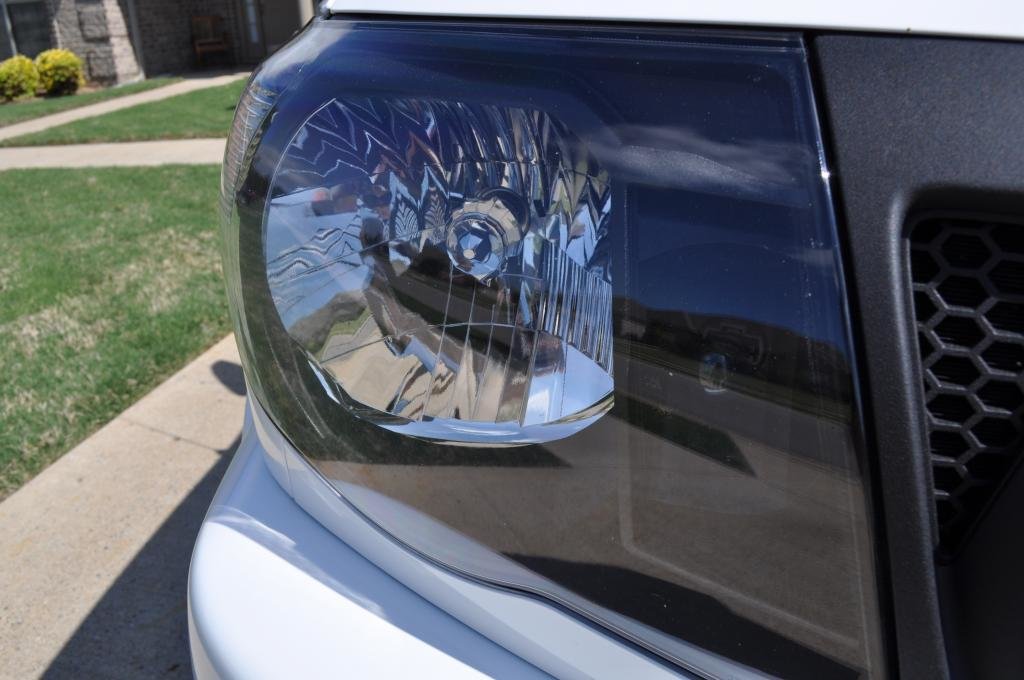

    RearViewMirror
    RearViewMirror Saw things so much clearer once you... were in my
    Apr 13, 2013
    #102010
    24,080
    Craig Christ
    State of Love and Trust
    2023 Subaru WRX GT Manual
    No issues and I actually put silverstars in mine before I did the BHLM. 2 Wires by the way.
    Definitely no issues now :)
