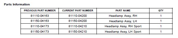

    I found a TSB here from another thread that has the part numbers for the replacement headlights.
    OEMparts123.com has the sport ones for $413 for the pair, and another $74 for shipping. Anyone know where to get a better price?

    Ya... Depo brand on Amazon. As close to OEM as you're going to get, one of the few that don't leak.
    Should be less than $180 for the PAIR including shipping. Be careful because there are some vendors that are getting $140 for just one... make sure the description says "pair"
    They are available off the shelf with the BHLM already done.

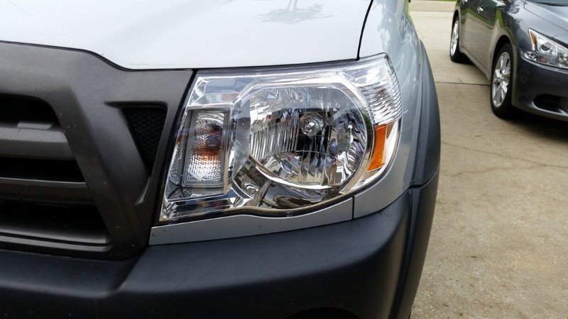

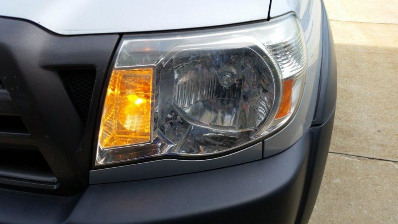

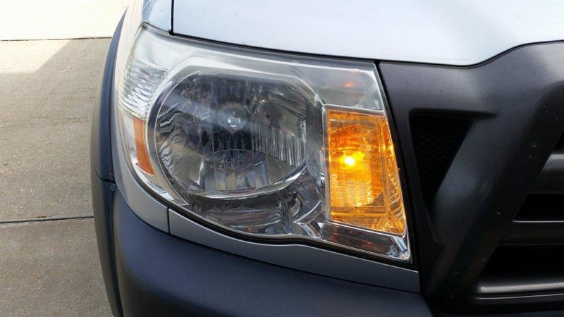

    I finally got around to taking my truck in to have the headlight assemblies replaced yesterday . . .
    Old headlights: :(
    New headlights: :) :thumbsup: :bananadance:

    In my case I think that replacement was the best option. I have less than 21k miles on the truck (yes really) and in addition to the "bubbly" looking effect on the inside of the orange DRL lenses, the clear outer lenses that encase the entire headlight assemblies were cracking in several places (for no reason at all). They had never been hit or bumped in any way. The service ticket when I picked up the truck referenced both the melting and the cracking lenses, due to "poor quality in plastic material". I think Toyota's offer of free replacement ends in November, so I wanted to go ahead and get them replaced.
