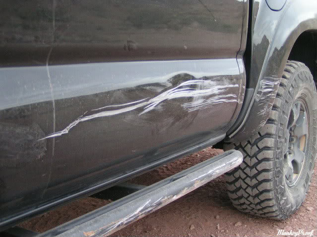

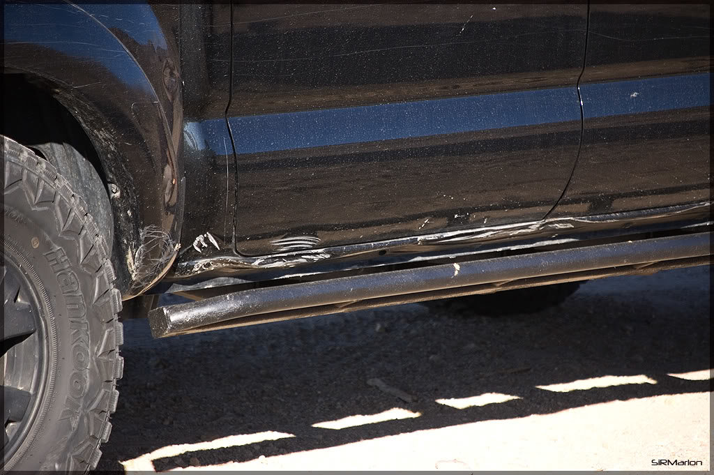

    honestly..have you addressed the absolute necessities for off roading yet?!
    such as sliders and proper under armor (skid plates). don't be like me and learn the hard way. sliders should be the very first thing to be considered, next should be a proper skid plate such as the All Pro or Bud Built skid plates. everything else after that.
    on my very first run in my 2 week old taco i did a run without sliders..bashed the rocker panel on the passenger side, the entire length of it. so bad i couldn't open the rear passenger door. eventually i had to use a short piece of a 2x4 and a large hammer to pound everything back in place so the door can open properly..
    notice the damage along the bottom prior to me getting sliders..
    and consider a kick-out style slider like what All Pro incorporates into their design so this doesn't happen..again, lessons learned the hard way..
