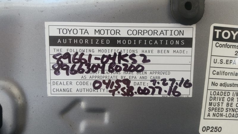

    Had mine done Friday and all those little issues appear to be gone. Raised the hood to look for sticker and ... no sticker. Went back to the Asst Service Manager and mentioned it. He said he doesnt think they have them. He made a couple calls, located a sticker and filled it out and stuck it to the door jam. I mentioned that the TSB shows it on the hood. Pulled it off, started over and put it on the hood. Getting the sticker almost took as much time as performing the upload! If you dont have a sticker then it's just laziness on their part.

    Glad to see you were here. Informing people Toyota is real slack because they didn't get their sticker. I didn't get my sticker either when I had the TSB done. Maybe I should go back to dealership and raise hell about my sticker. I am sure my truck would run better with the sticker attached.
