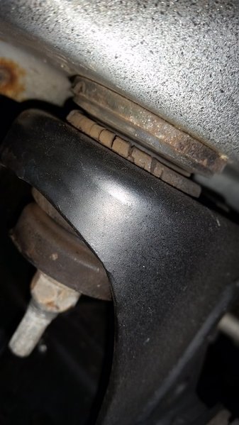

    I had the bushings installed both ways. I ended up with the bigger busing on top, but no big washer. I absolutely love it! Every day I drive the truck and I still can't believe that $23 made the front end so solid feeling.
    My advice for anyone installing the bigger bushing on the top is to loosen both sides before attempting to jack up the body. I didn't do this and I too had pops and clicks when jacking and I realized that perhaps if I unloaded the other side it may have been less stressful for the truck.

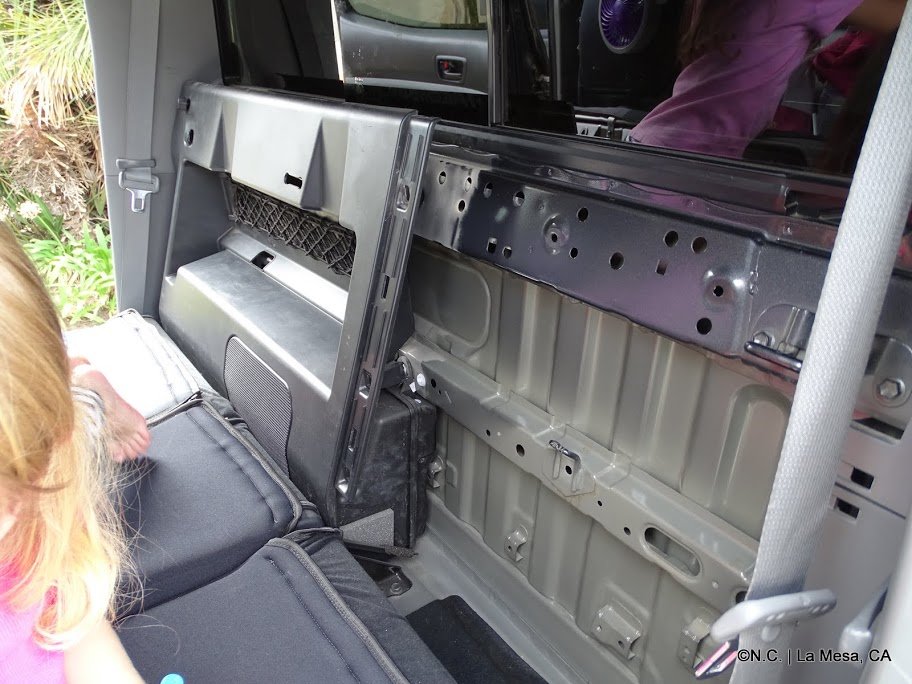

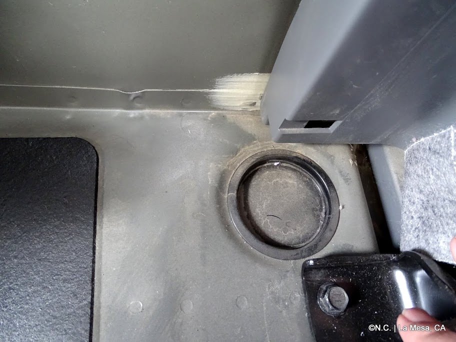

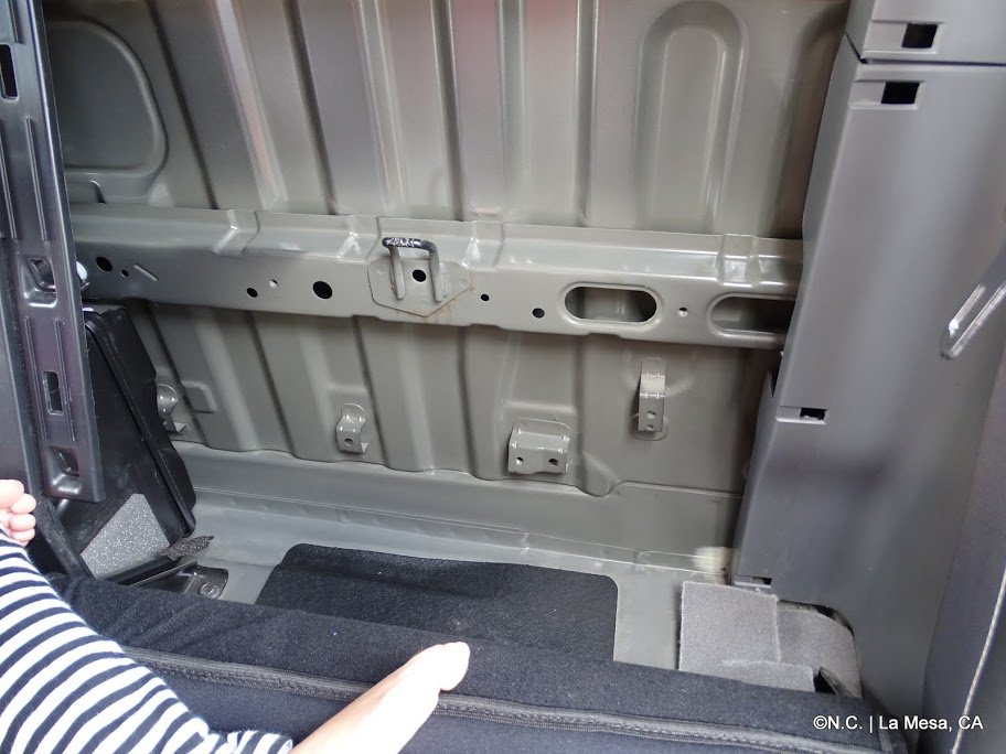

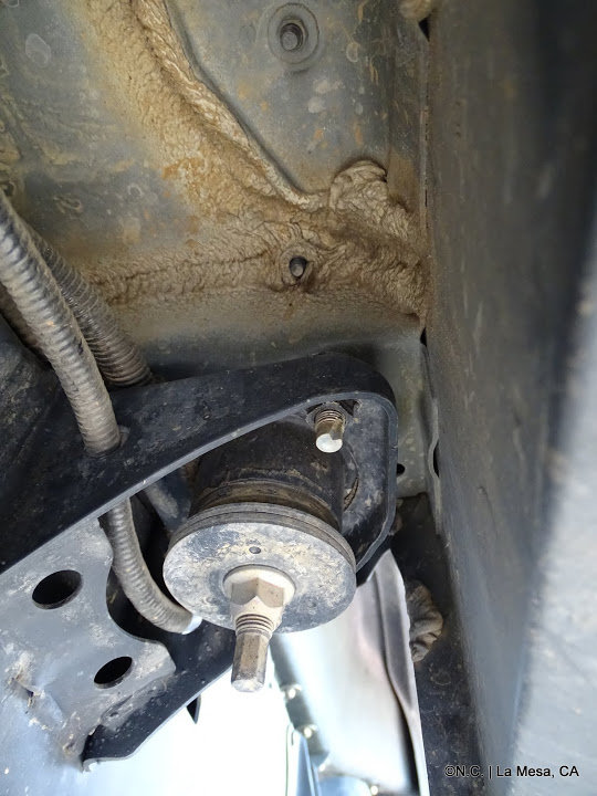

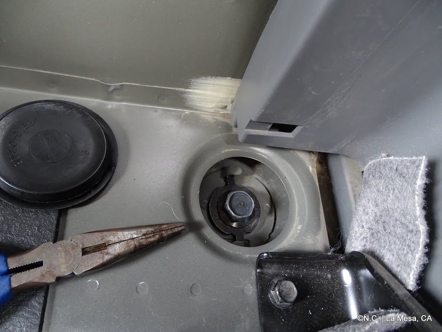

    Speaking of which, I pulled a bin out of the back of the truck and had time to locate the rear body bushing access port and took some pictures.
    Pull bin
    Lower right corner in picture, peel carpet back
    Pull cover to reveal bushing bolt
    Body bushing pictured from below
    No pics of the front ones yet.

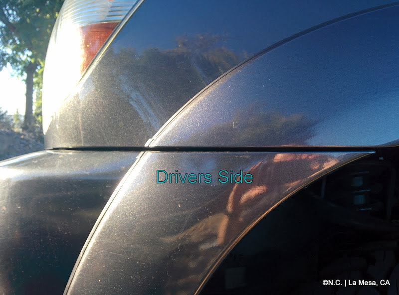

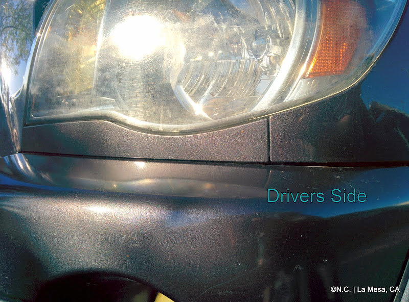

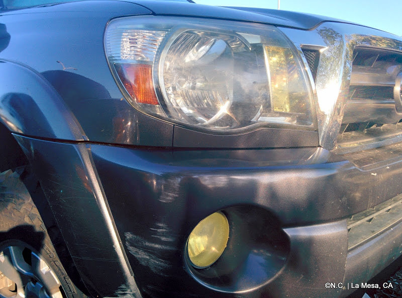

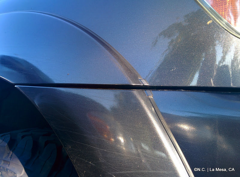

    Yes. Stock bumper cover. Bigger bushing (no washer) on top, it made a small gap. Pictures below, looks amazing if you ask me. (luv my truck!) lol :D
