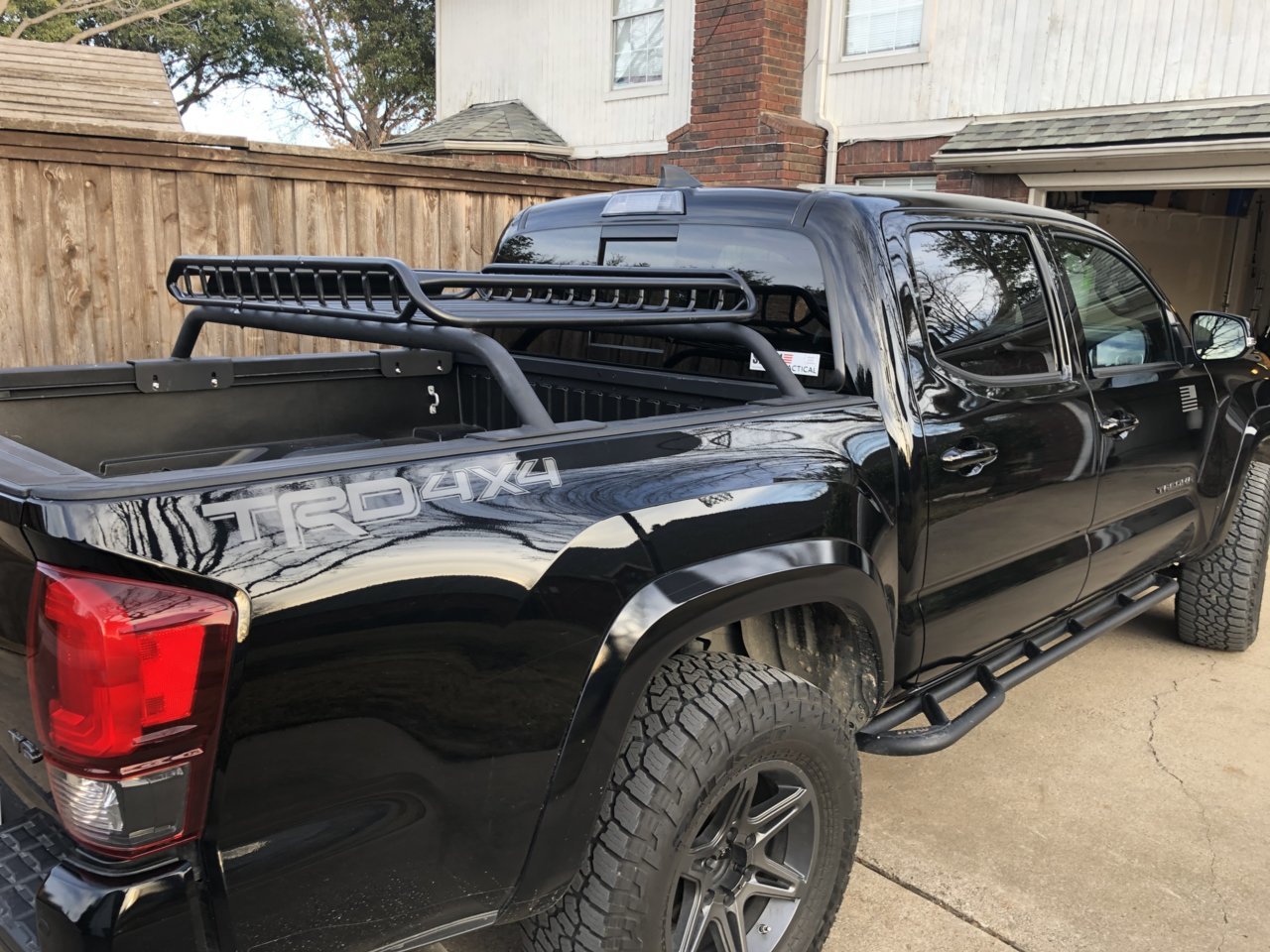

    So, I've been looking for a solution to keep the bed storage of my DBSB fully open, while allowing for some storage above the bed. The Warrior Products Bed Rack looked like the perfect solution to me, but it does not come cheap:
    So, I decided to make my own. I picked up 2 generic bed bars from a forum member for $100 (although AVID Off Road offers a similar style bar design for $100/ea), and added a MAXHAUL roof basket to them for $70. I'm using hose clamps for the mounting. The basket is very secure, but I realized that you can get black clamps from Amazon after the fact, so I will likely be swapping them out for black ones. Final product:
    771-CC49-E-7331-4763-A78-A-C07-BF1-F4470_f359a2a6afb0e7f3804e211ab69ecc27b7abb049.jpg
    Because the basket is open, visibility is still good out of the rear window. Ultimately, I will mount a few items (like recovery boards and a Hi-Lift) and will probably add a waterproof cargo bag like this for another $50:
    https://www.amazon.com/gp/product/B07LB6WTF6/ref=ppx_yo_dt_b_asin_title_o01_s01?ie=UTF8&psc=1
    Thoughts, comments, potential issues?

    I love the janky DIY of it however I would get rid of the clamps and drill/bolt the basket in. You can get some rubber washers to help with vibrations between the rack and bed bars. The clamps will likely work but I would be cautious about the lateral Gs

    Hose clamps are for hoses. I understand saving money but geez sometimes you'd think that on a new vehicle you wouldn't want to mount "driveway engineered" stuff out for the whole world to see. A 20 yo truck? Sure, have at it. Not on a new truck.

    Ok, well it’s a mounting clamp. It has a yield strength. It’s not duct tape.

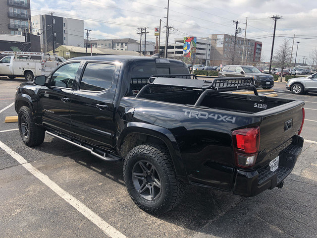

    Updated with bolts and rubber washers between metal contact points and at the top to keep water out:

    OP, why'd you mount the basket sideways?

    Agreed. Hose clamps be trippin. U-bolts at the very least
