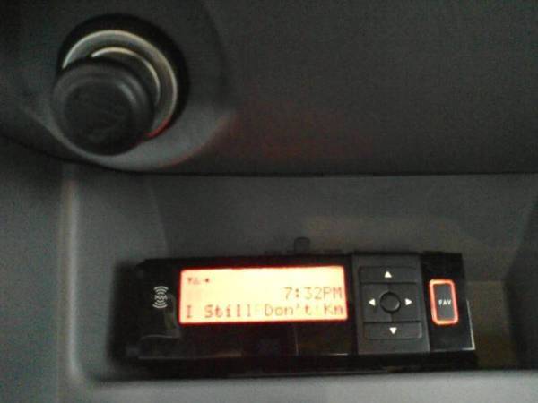

    I spend a lot of time browsing this forum, but never contribute. So, here I go. I installed a Metra Ipod / Aux. interface into the stock stereo.
    http://www.circuitcity.com/ccd/productDetail.do?oid=185485
    To switch between my ipod and XM radio I press DSC on the radio. Works great! The XM radio unit is a Sportscaster. The orange backlight almost matches the dash lights, and it has a remote. Cost is $20.00 on the XM site with a $20 mir. You can also get 3 months free and free activation.
    http://forums.slickdeals.net/showthread.php?sduid=0&t=720561
    I installed the XM antenna behind the radio and under the dash. The signal strength is better than I expected. I used heavy strength velco tape to secure the receiver in the storage area.

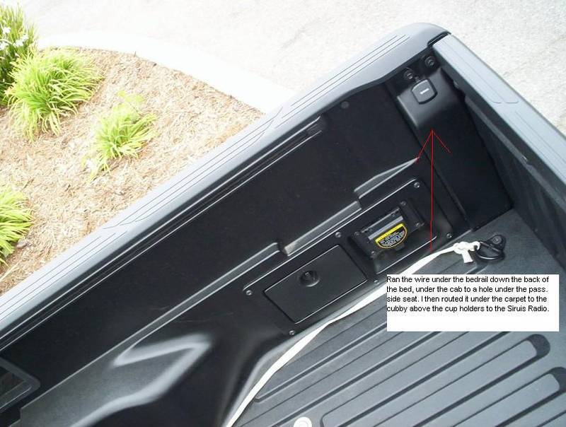

    I will go ahead and post where I placed my Sirius antenna

    Sorry to re-open an old thread..
    How is the reception with the antenna in this location? (Just curious if you have any dropouts with the ant. here.)
