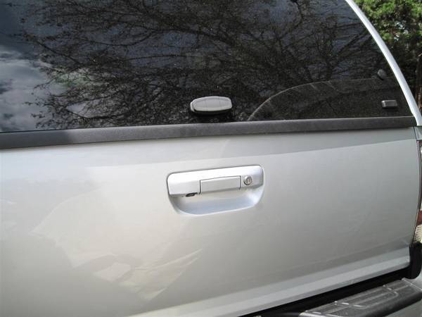

    Color Match appears to me a little lighter than factory. Could be just different angles of surfaces
    Paint surface is rough in a couple of small areas and could use some wet sanding and a couple clear coats
    Or I might repaint it.
    Have read posts complaining of paint pealing, but I have not had the problem.
    Though it's only been 4 or 5 weeks.
    Bought it specifically for the color match.

    Construction seems decent to me. My handle pulls crisply and stops solidly.
    I don't yank the handle, I lift it.

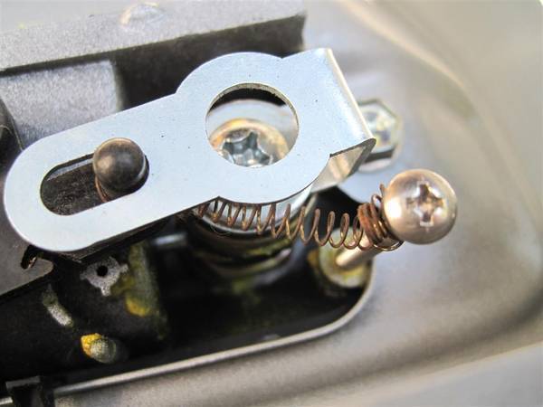

    The one problem I've had as have others,
    the mechanism tends to lock itself, when the gate is closed, not necessarily slammed.
    I mounted a screw (8-32 or 10-32) into an existing (not matching) threaded hole in the inside of the handle.
    1st I used a rubber band from screw to mechanism, helped but didn't last.
    2nd, I got an old spring from a ball point pen and did the same. trial and error 'til it seemed to work.
    Only been a week, but seems to have done the trick. I'll post some pics below (gotta upload 'em 1st)

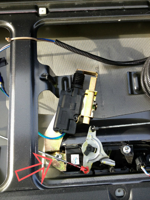

    I'm intending to adapt the PL8521 to the PL5305.
    I have a cap with manual key and remote entry
    I will connect the PL8521 to the same wiring with a switch to disable both.
    Then both Cap and Tailgate can be manually locked. Cab doors , lock unlock with keyfob.
    Hate to be sittin' at a light in the city and have someone open my tail and help themselves
    Pop&Lock 5305
    Pic below from this thread Pop and Lock PL8521 Power Tailgate Install (2012 Tacoma)
    My Installation, Should accept the PL8521, above
    Pop&Lock PL5305 ''Spring Mod' :D
    Pop&Lock PL5305 ''Spring Mod'' Closeup :D

    What does the Pop&Lock PL5305 ''Spring Mod' do?

    Copied & Pasted from my post above:
    "The one problem I've had as have others,
    Only been a week, but seems to have done the trick."
    The internal mechanism can move into the locked position
    The spring puts a little tension on it to keep it in the "unlocked position"
    To much tension will cause it to unlock all the time.
    Hense, the trial and error.
    Spring broke recently (after 3-1/2 years). I stretched and reattached it.
    Gonna look for a Stainless Steel spring and replace it when warmer weather returns.

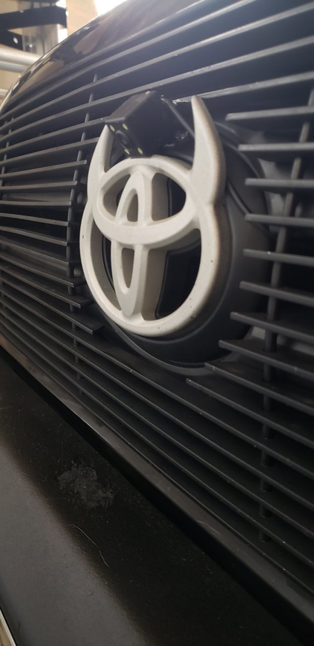

    I put my camera dead center of my stock handle, I had to dremel out a quarter circle of the handle but there was plenty of room, also I have a locking cover that laps over the gate so I didn't need the pop n lock, I can't post a pick cause my wife is shopping with the truck at the moment

    Where did you get the grill emblem? Would love to have that on my truck.
