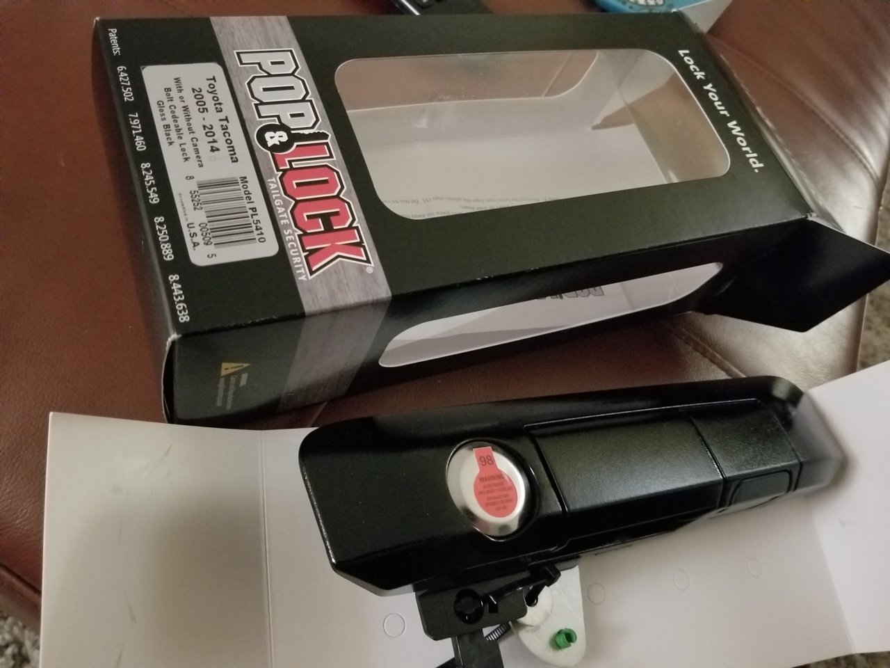

    I have the PL5410 in black gloss. You can program your OEM key. So far I like it and would recommend it :thumbsup:

    Good so far. Before I installed it I sprayed the hell out of it with lubricant spray and let it soak over night. Also whenever I clean the truck I spray the key hole as a precaution. No fading at this point either. The PL5410 is non electric, uses your ignition key, has a mount for my backup camera and offers a painted version. I would recommend the PL5410 :thumbsup:

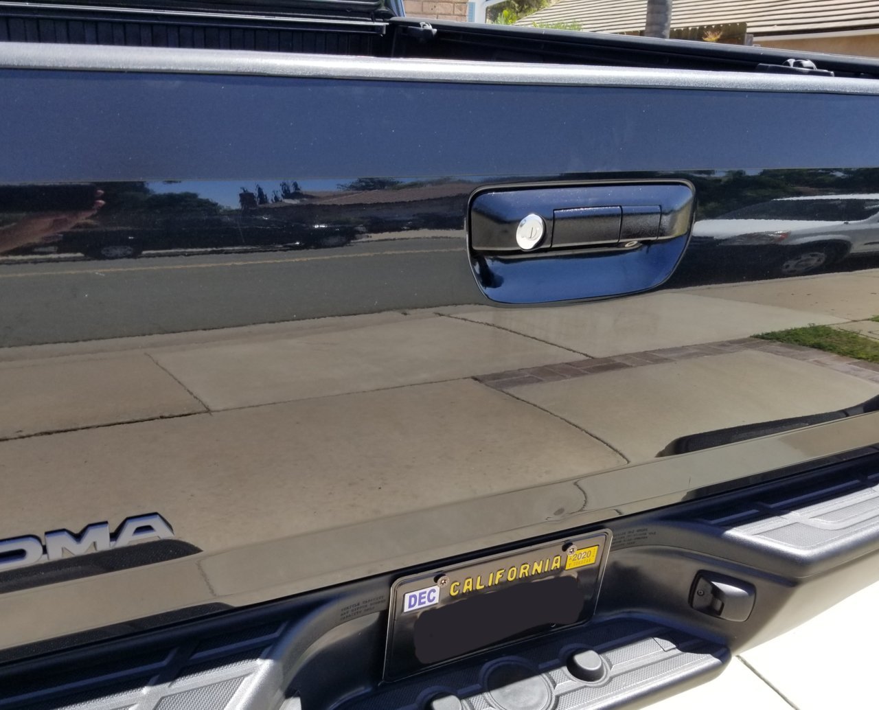

    Here ya go, still going strong. No fading. Still happy with it :)

    Wonder if you could plastidip it flat black
