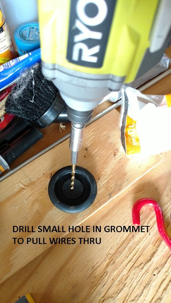

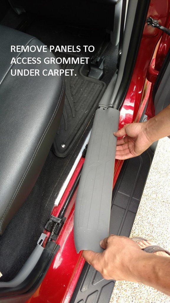

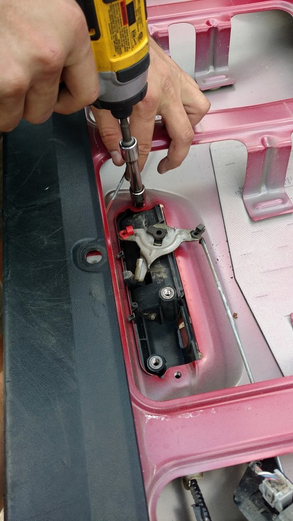

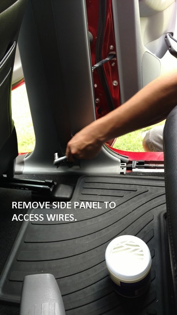

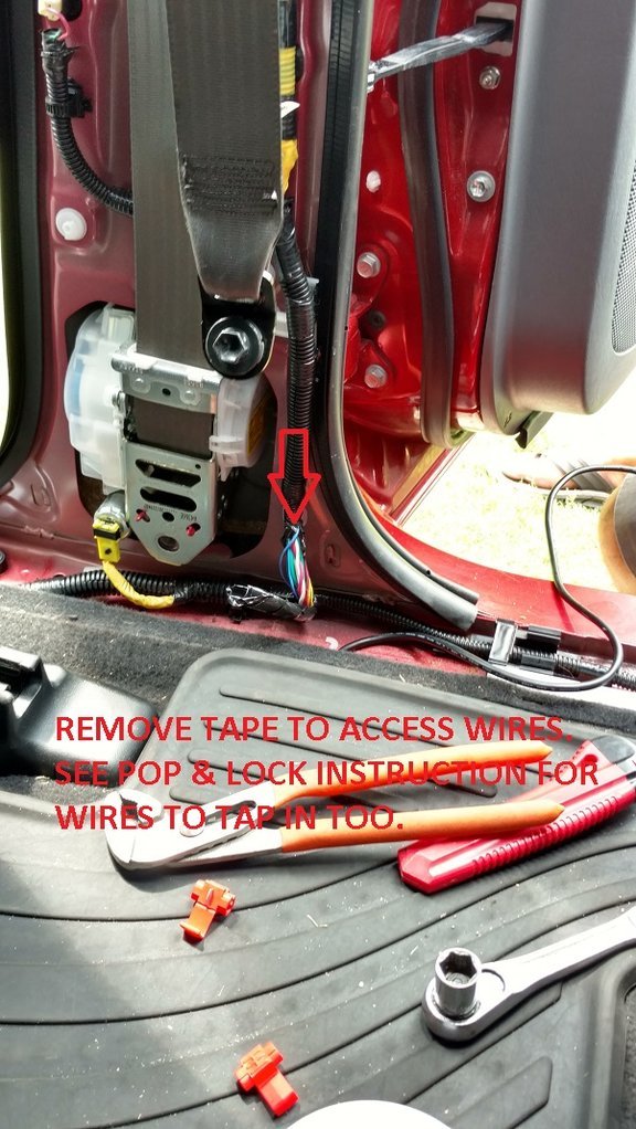

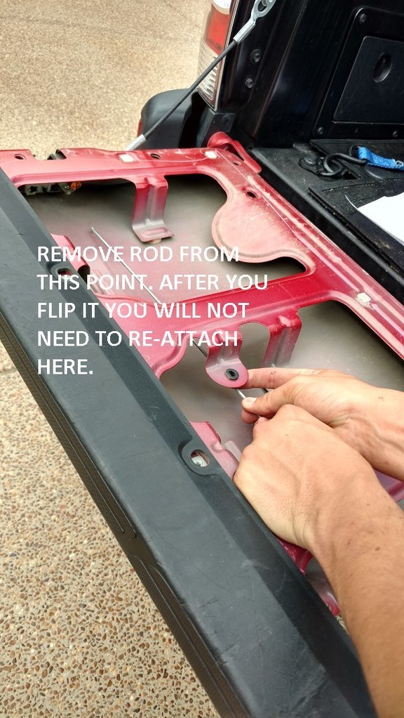

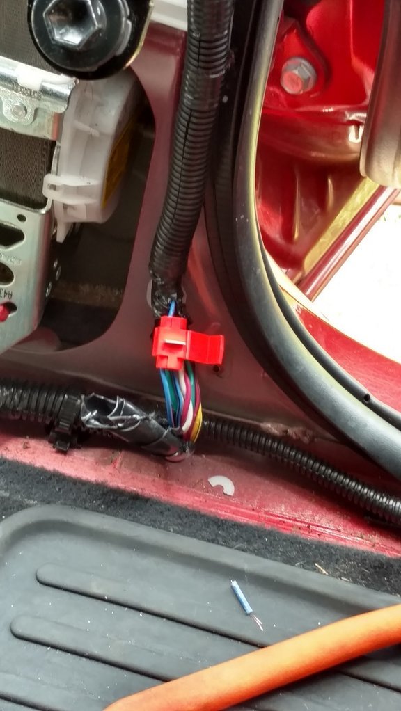

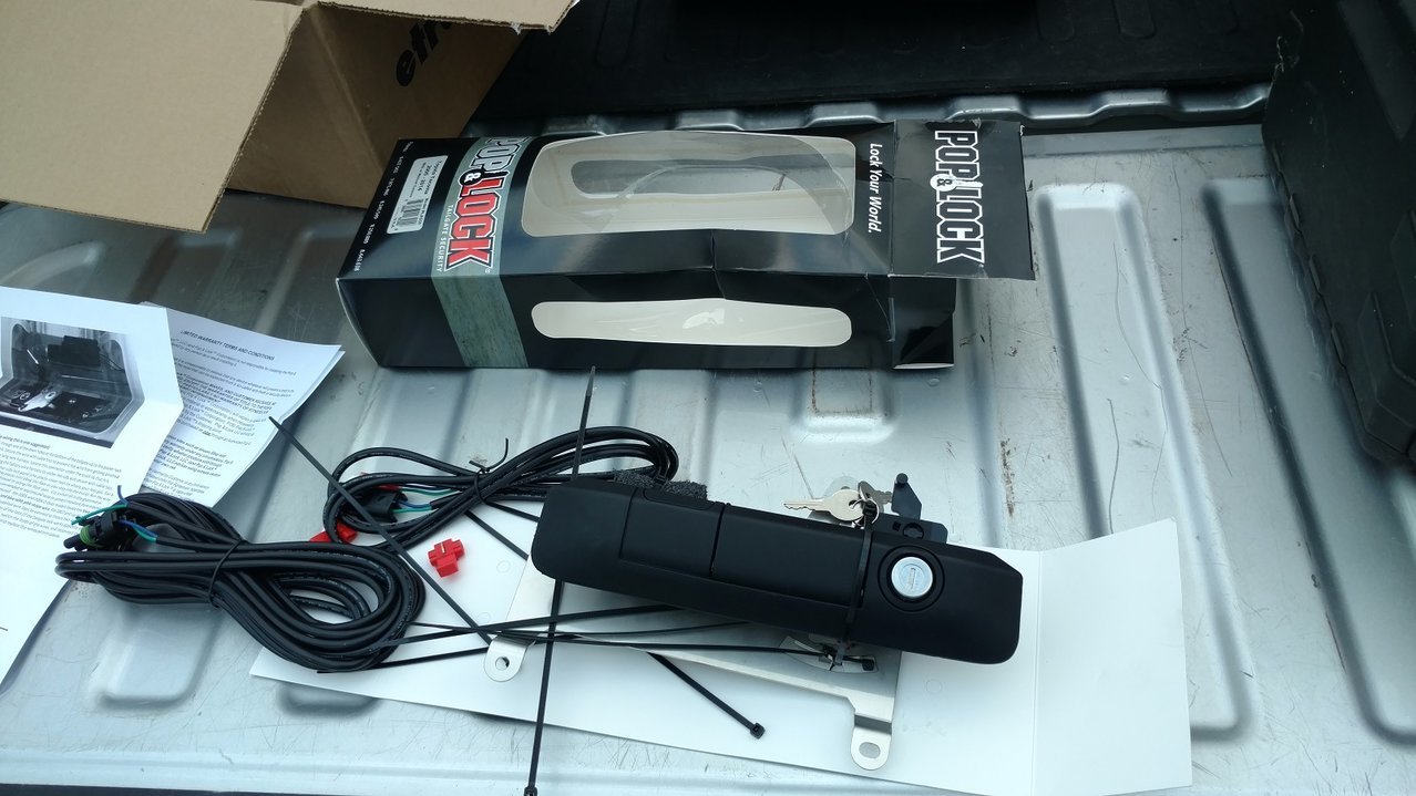

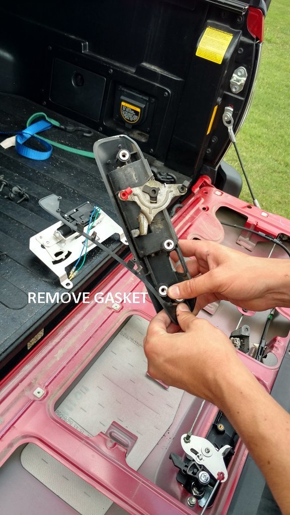

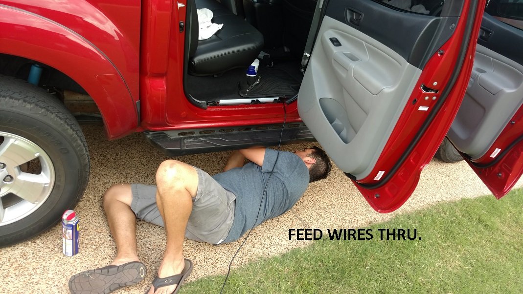

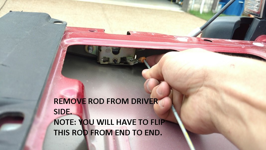

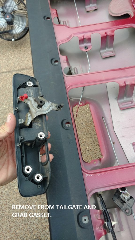

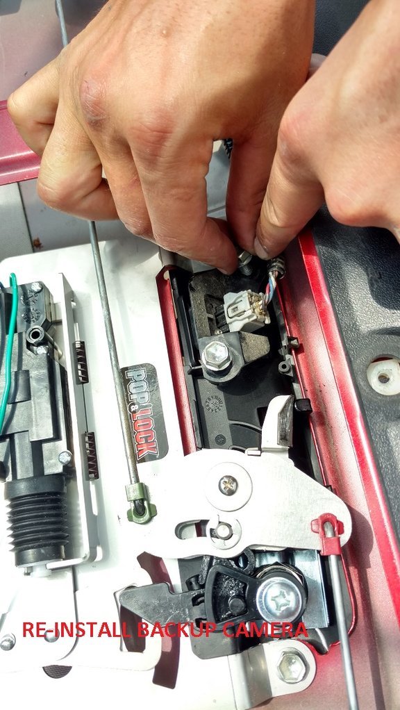

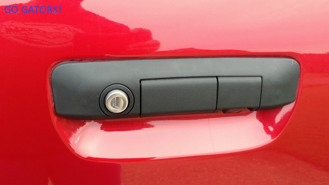

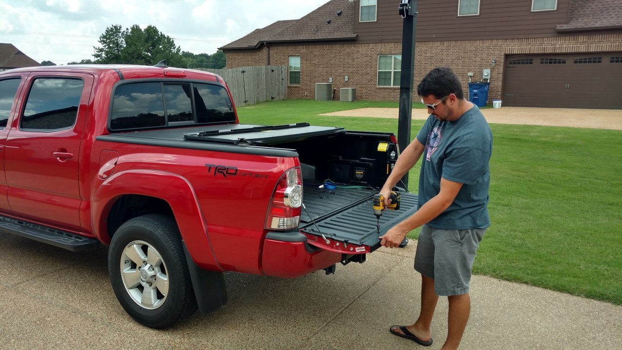

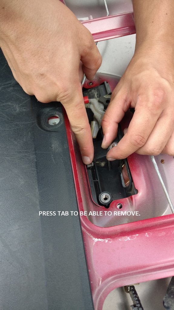

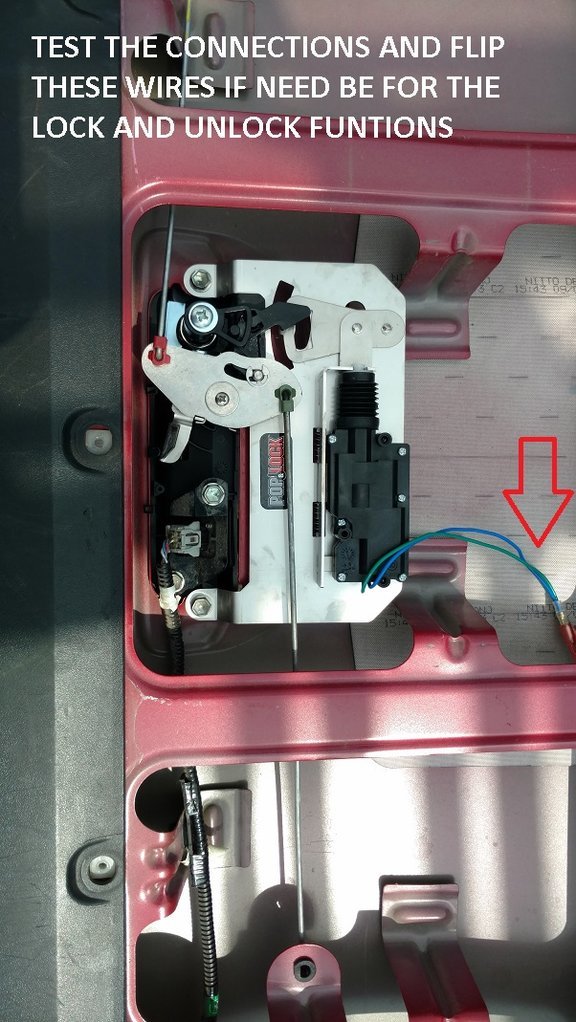

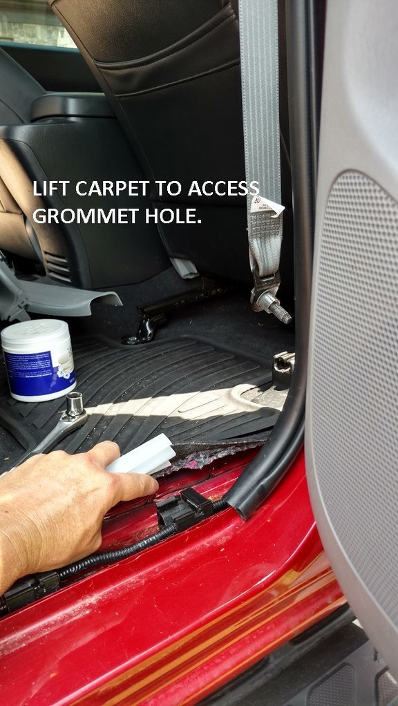

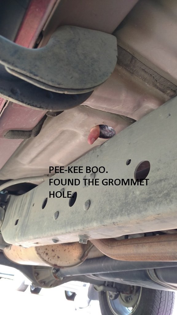

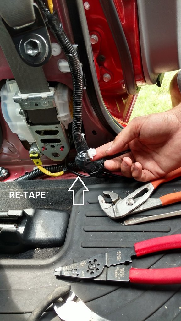

    Installed the PAL8550 with the help of my buddy J-rod.
    Overall it was a very easy install.
    If need any help or have any questions, let me know.

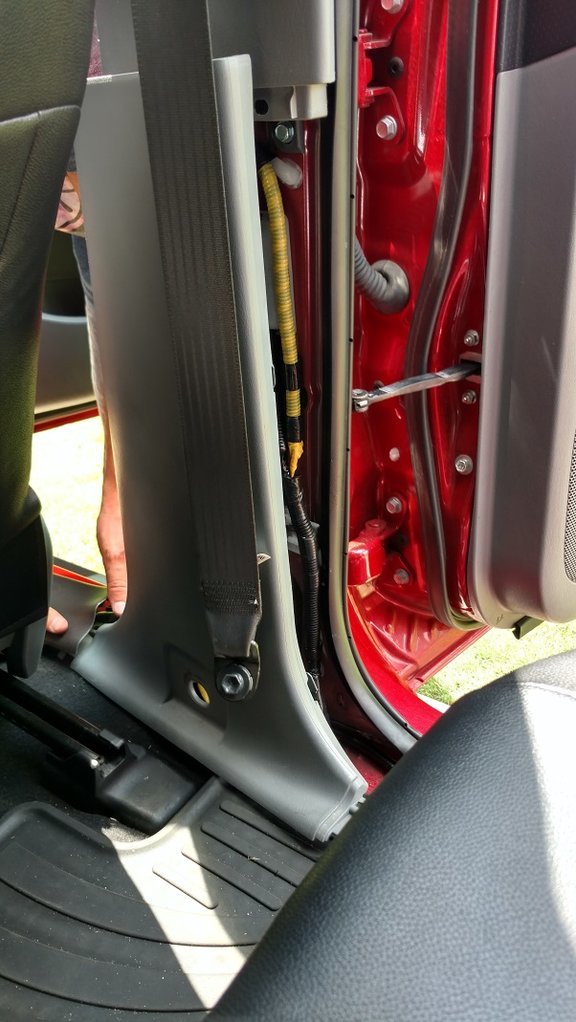

    What size torx bit is needed for the inner panel bolts?
    Much thanks for the awesome post!
  5. Aug 22, 2017 at 7:57 AM
    CMW_TRD_Sport
    CMW_TRD_Sport [OP] Well-Known Member
    Jul 11, 2017
    #223776
    264
    Chad
    2014 Tacoma TRD SPORT
    Tailgate was a t30 bit
    Seat Belt Bolt was 14mm socket.
    Camera and Handle: 10mm socket.
    That was the only tools needed.
    Spindifferent[QUOTED] likes this.

    The only thing I'm unsure of...
    I want to it to unlock with 2 presses of the fob like pax door. Does that simply mean I splice into pax side wires? Is that how yours works?
    Thanks,

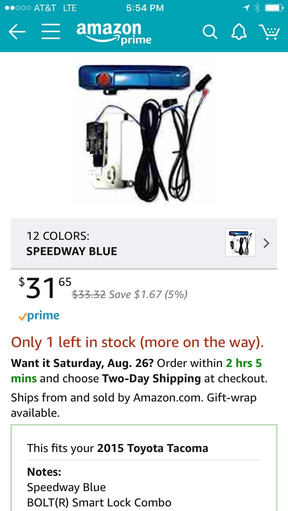

    FYI someone with a SWB better jump on this! Thought I'd check since I see that some people get awesome deals occasionally on Amazon with the pop & locks
    CJVant and 82ND_AAF_TACO like this.
