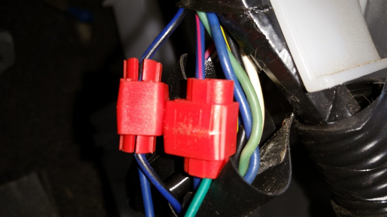

    Does anyone know the wire colors for 2014 tacoma passenger side? Thanks in advance
  17. Jul 21, 2018 at 2:28 PM
    #17
    AaronNY
    AaronNY Well-Known Member
    May 20, 2018
    #254021
    73
    Syracuse NY
    2011 MGM 4x4
    Bilstien 5100s Hella 500s and 700s
    On my 2011 I did green to blue/pink and blue to blue/black. Hope it helps though I'm not 100% sure if 14 is the same or not.20180721_172216.jpg 20180721_172238.jpg

    Thanks got it working
