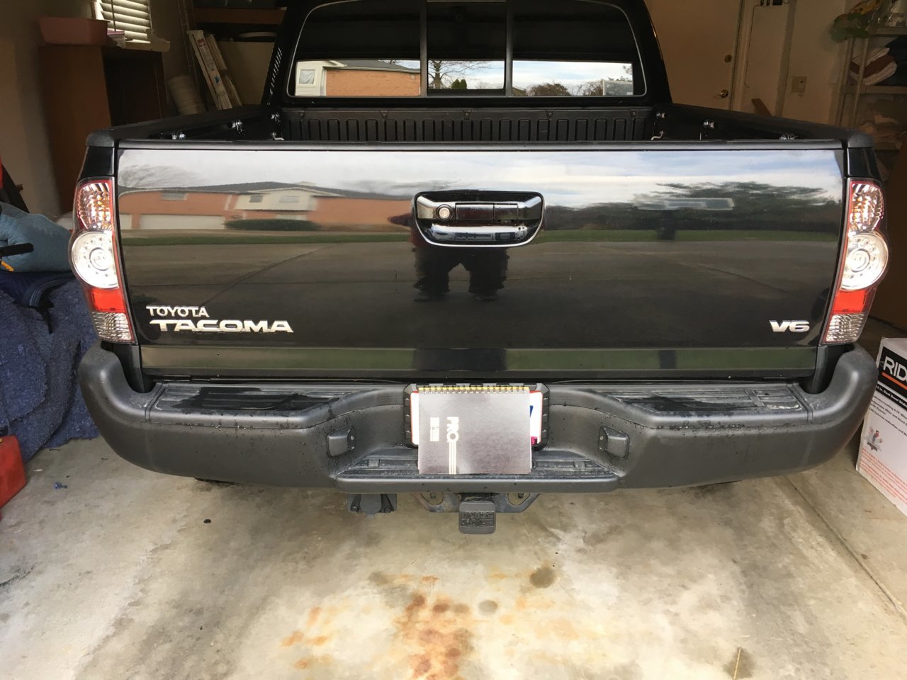

    Just installed my Pop and Lock on my 2014 Off Road with a back up camera. Very easy to do and the camera fit perfectly.
