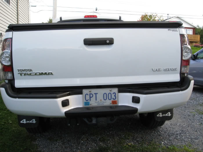

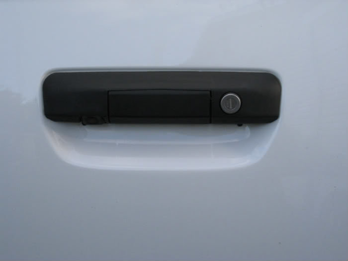

    Just installed mine (PL5300). Very easy install with great instructions.
    2 issues though. I had to drill the holes bigger in the camera mount. The camera didn't click into the holes. Not hard at all to do.
    Another small issue is that the handle seems a bit skinny. There was a gap in the bottom once it was installed. I just siliconed it and everything seems great. Wasn't a perfect fit but no big deal. I really like having the lock. Worth the wait however a lock should have been standard on the truck.
    Once I was into the tailgate, I applied some Krown undercoat inside to protect from rust. It worked good on my ford so I had to put it on my Tacoma.

    Looks fine.
