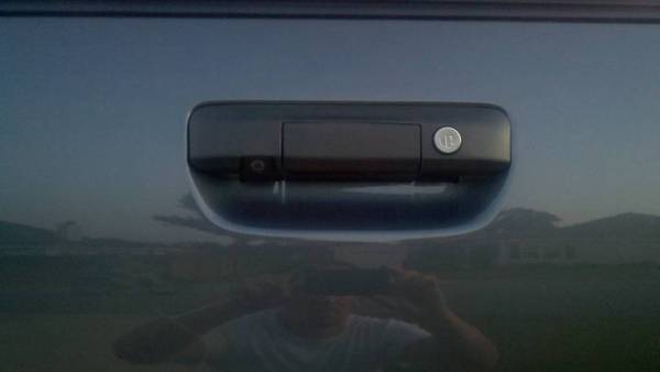

    Well, after about 30 minutes here it is. So far I like it. Pretty easy install!

    Hey looks good, does the whole handle part come with it or did you have to drill or something, i noticed you have your back up camera did the lock interfere in any way? which brand is that one?

    If you buy the 09-11 model you only have to relocate the camera wiring to move the camera from pass side to drivers side. All parts included.
