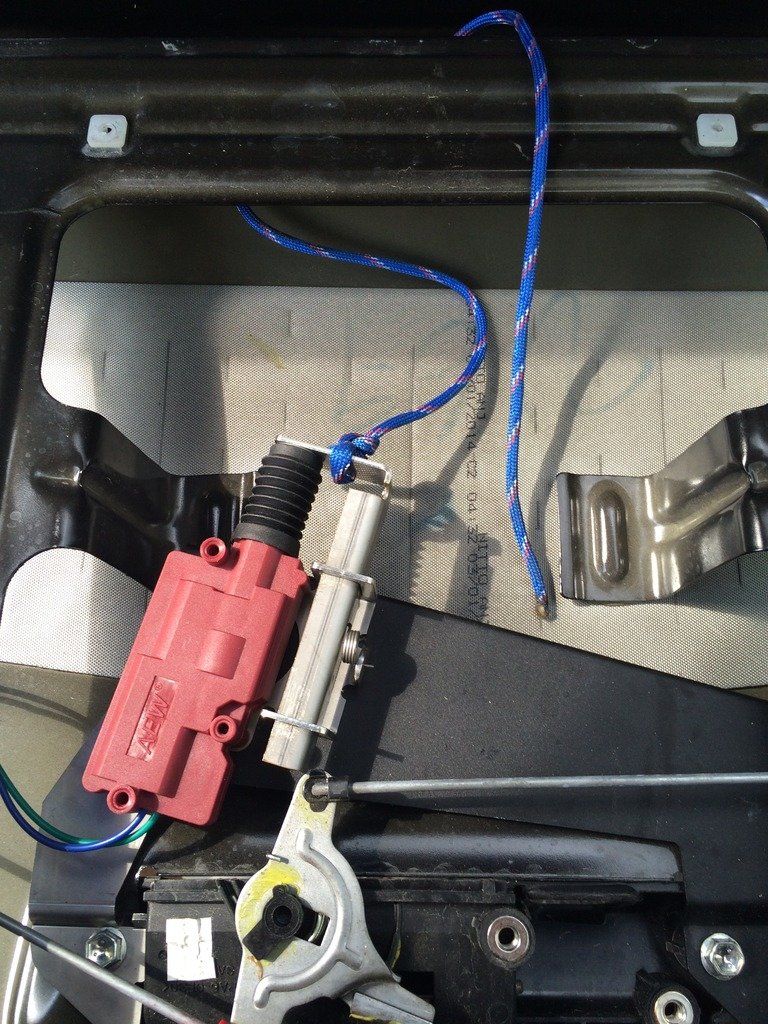

    One of the complaints that many PL8521 owners have is of the unit failing in the locked position causing various amounts of frustration in getting the tailgate open, particularly if you also have a locking tonneau cover. The picture below illustrates my solution to the potential problem.
    542EBD7A-EE70-44E1-B27D-52ABA66BBD51_zps_4b7a9c05e243b5088b562726836753e092dd9cf0.jpg

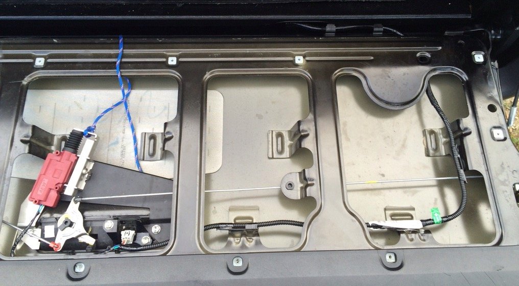

    My solution is simple, easy, cheap and installs quickly. I took some leftover cord, tied one end to the locking bar on the PL8521 and then, leaving a little slack in the line I ran the other end out the drain hole just below the unit. Then I looped the excess around and over the tailgate leaving it inside the tailgate. Next I put the tailgate cover back on, pinching the cord in place but leaving a hidden cord under the tailgate hidden from view. If the PL8521 ever fails I can grab the cord and pull, manually unlocking the tailgate. The cord cannot be seen from the back of the truck unless you are on the ground looking up from under the back of the truck.
    Here is the completed installation without the tailgate cover on.
    8BF9EFDE-C153-4C4A-AC01-0654C8EA113E_zps_0911c2e3f362e1006e3f0eb53e6d838c983e6bd3.jpg
    And I found out it works as I accidentally closed the tailgate in the locked position with the tonneau cover locked in place. One quick pull and it was unlocked.

    How would this be incorporated if the handle broke?

    You bet!

    You are describing a different problem that this solution would not work on. About the only thing you could do if the handle broke would be to take the tailgate cover off, manually release the tailgate then fix the problem.

    Glad to help. One person improved upon my idea by tying off the end of the cord inside the tailgate skin so it cannot come undone and when you pull you can only pull the cord in the direction that will unlock the lock.

    This is a great idea but be careful about the cord hanging down. Anybody can climb under the bumper and give a pull and they have unlocked the tailgate. Try to hide the cord end.

    If you put the extra cord back into the next opening over and the cover pinches the cord then the cord will essentially be tucked up tight under the lip of the tailgate and it cannot be seen unless you get up close and look under the tailgate.

    I’ve had a piece of paracord off my pop n lock like ACEkraut described for 5 years now and it’s been fine.
