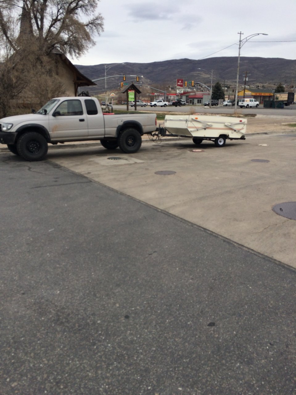

    So a bought this trailer, obviously it needs a little bit more height cause well look:

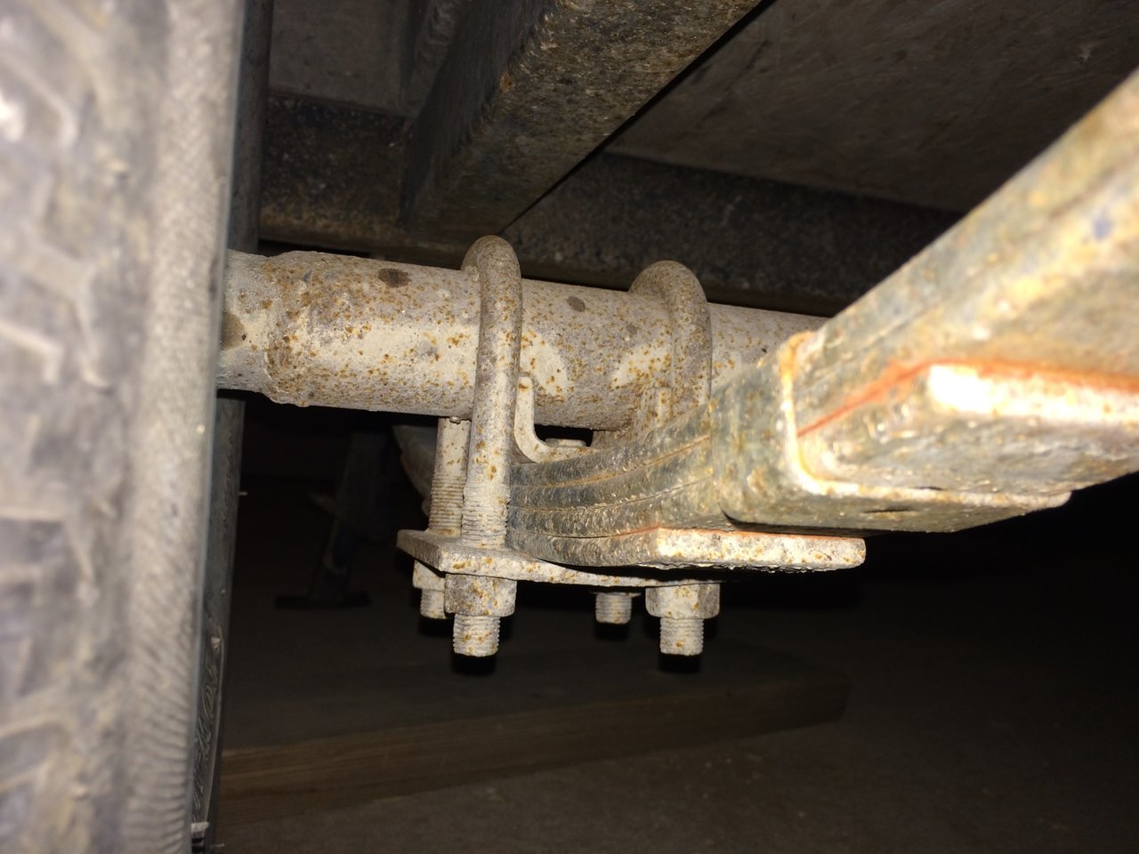

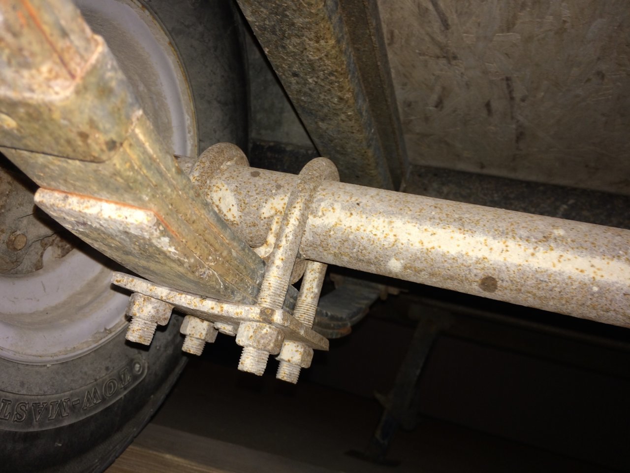

    I plan on flipping the axle to under the spring and have a question.
    Can I just reuse all this stuff but have the axle how I want it?
    DF736736-B92A-44BE-9575-10E55DBE5266.jpg 639AB2E9-788F-47AA-962D-F7BAD97BEEBD.jpg
    The perch looks like it’s welded to the axle, could I just rotate the axle 180°? I’ll get some new ubolts too I guess cause I think they’re welded to the nuts.
    Or do I need to cut and reweld perch’s?

    Some of those axles are camber'd a little for stability. I imagine if you rotate the axle it will have negative consequences. You could get longer springs and weld new hangers. That would also improve the ride but it would be cheaper to just get a new perch welded on. Might only cost you a few beers if you find the right welder.

    The proper way would to be weld new perches on the axle. Rotating the axle won't do it. You could also put 12" wheels on it.

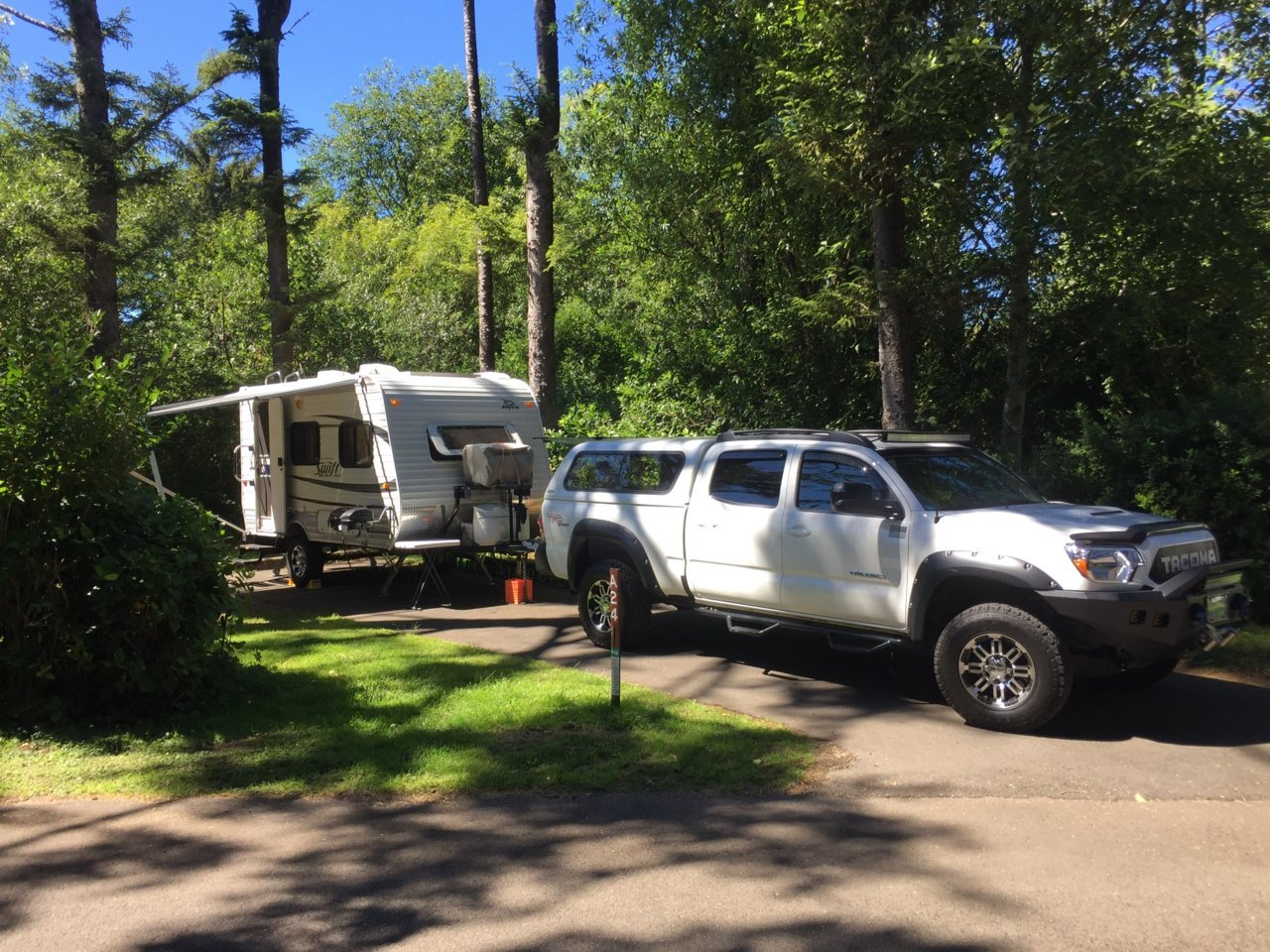

    For some axles on campers they make a kit to accomplish exactly what you want to do. I had my axle flip done by a local dealer.

    I did that with mine.....heres a before and after picC65AFC7F-4FE7-49FA-AFE6-58EFCDF1AC9D.jpgAC68AFE5-50E4-48FF-899E-B0F0B65D0A65.jpg

    I think it would be a lot better, just for clearance and everything.
    I drug the back bumper of the camper on the pavement pulling out of the gas station yesterday. Not a big deal, just annoying.
