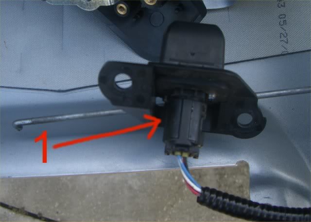

    Yeah, i used this write-up to install mine and it was golden!! Great write-up.

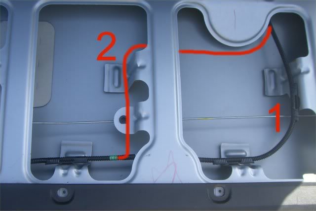

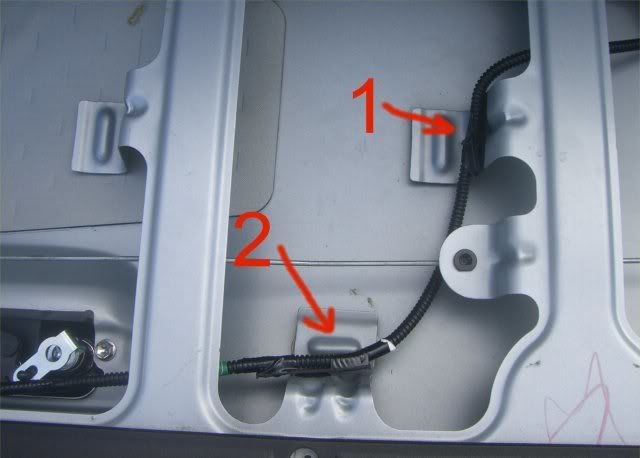

    Only problem i had was at this step. My cable routing was not what i wanted the first time and that was a pain in the ass to unplug the camera once it is mated with the clip. Since the camera plug is inverted from the factory location in the PnL the release for the camera clip is hard to access once it is clipped in. I was squeezing the hell outa that thing and it would not budge. Had to use a screw driver to press in the detent thing to get it released... Other than that it was simple.
    ______________________________________________
    Routing the cam harness cable
    Here is a before and after shot. The cable as you can see in black is where it is run by the factory, highlighted in orange is how to run the cable in order to facilitate the cam on the other side of the handle.
    Once I re routed the cable I used insulation tape to hold it down right at #2 on the picture
