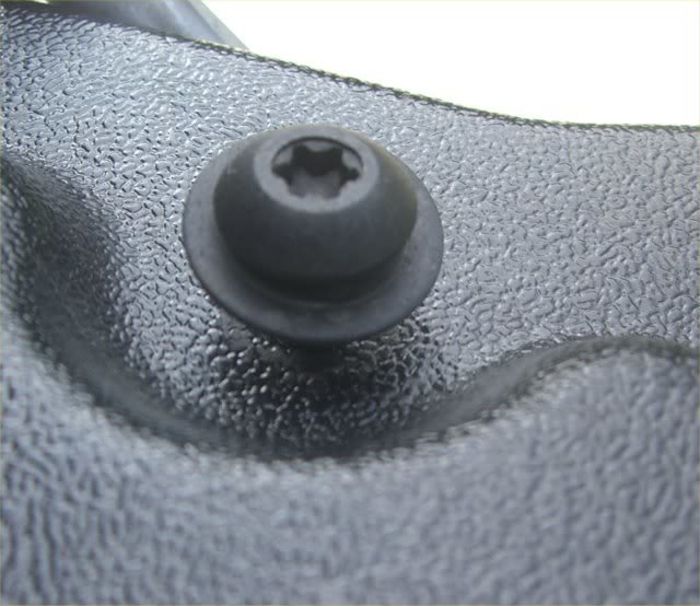

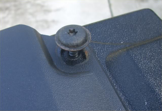

    I did not have the special type of screw driver to remove them so I used a flat screw driver of the same diameter and was able to unscrew them no problem.
    These are the small ones. In total remove 15 of themCimg1850_28929a90155dd914d2e9ebd25103f28f9e8a7dfd.jpg
    For future reference, I believe you can just use a 4 mm Allen key if you do not have a torx bit
