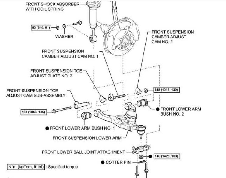

    So I went to the alignment shop today.
    I’m was less than pleased with their service. I explained to them the issue I was experiencing. I showed them the video and explained to him that I was researching and reading up on what I believed the issue was. I said that my LCA bolts may not be torqued to spec. I requested that a torque wrench be used to torque the bolts to 100 ft lbs.
    Next thing I see is the guy under my truck with a open ended wrench . He gets out and says yup they are tight. No issue here.
    Long story short, I left, went to harbor freight and bought a torque wrench.
    when I torqued the passenger side rear LCA bolt it was definitely not to spec. I was able to get about 2 turns out of the nut until it clicked. I was unable to get to the front LCA bolt since I have to drop the skid plate. I’m willing to bet that that bolt is loose too.
  19. Apr 13, 2020 at 2:31 PM
    #19
    splitbolt
    splitbolt Voodoo Witch Doctor
    Mar 7, 2010
    #32761
    7,858
    NW Arkansas
    2016 TRD OFFROAD DCSB MGM
    135 ft/lb and 139 ft/lb...
  20. Apr 13, 2020 at 3:37 PM
    #20
    Sandtaco10851
    Sandtaco10851 [OP] Well-Known Member
    Jul 20, 2017
    #224585
    77
    SoCal
    2017 Tacoma TRD PRO
    so it’s not 100? Lol I read it was. Maybe that was for the 2nd gen
