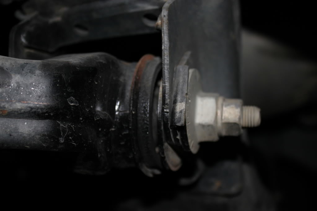

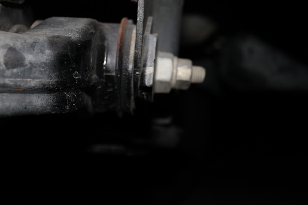

    Observe the gap between the bushing and control arm mount
    Gap is now closed which causes the "pop"

    Nah, it's not the ball joint. Not by the description you gave. I thought it was my ball joint too but couldn't understand why I didn't hear a rattle sound day-to-day driving down the road. I was surprised to see the pushing pop like that but I saw it with my own eyes.

    Ya. You saw the pic I posted above right? That was a picture of the rear bushing from the side looking just behind the tire. You can see the same thing happen with the front bushing too. If your pop isn't so bad, it may pop back before you get out of the car to observe. The only reason why I could take this picture is because it became really bad finally.
