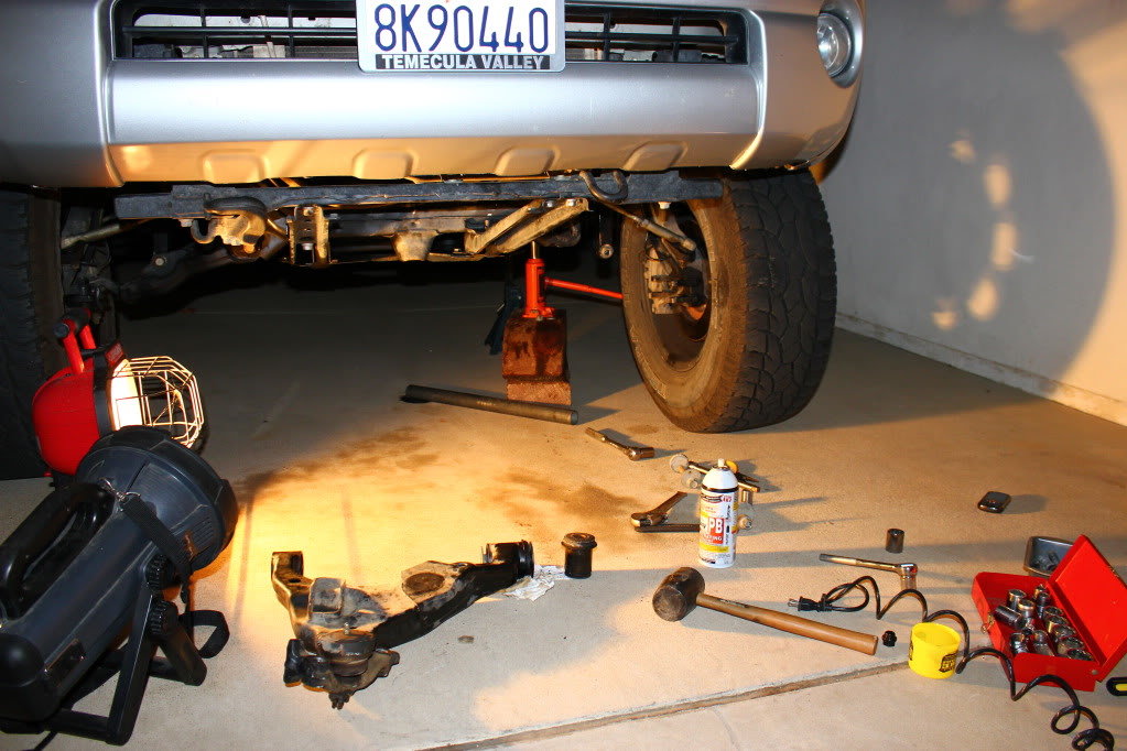

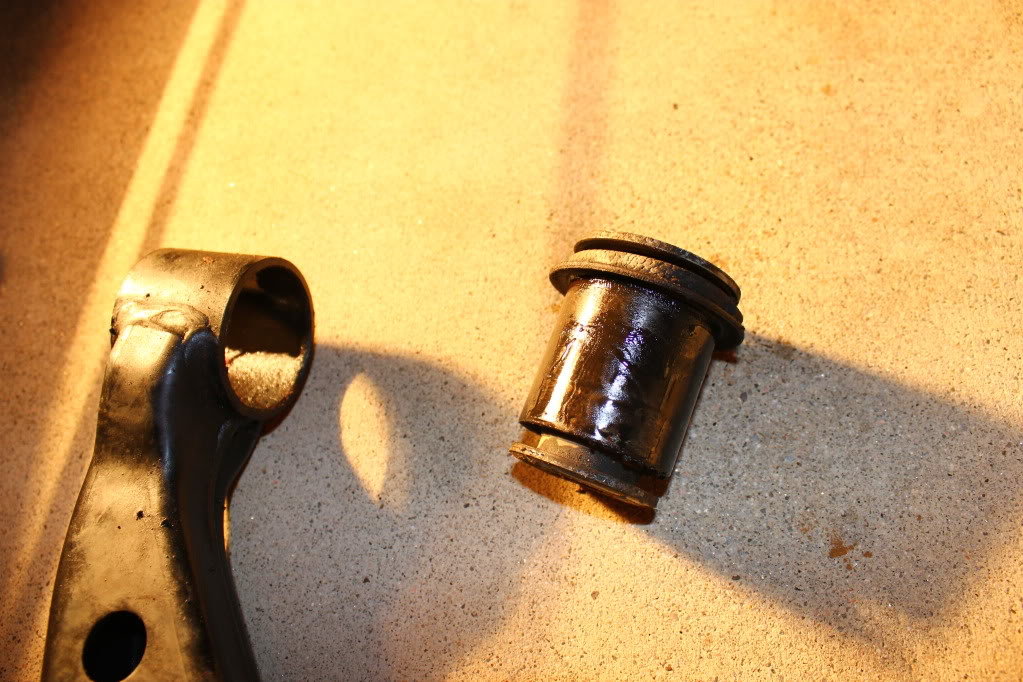

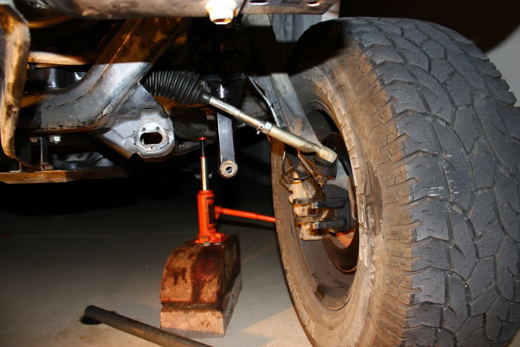

    Does this look simple enough. Haha
    Once I got the arm off, I took one wack at the forward bushing and it just fell right out onto the concrete :eek:. The rear bushing would not budge (As it should be). I'd say I found my bad bushing that was contributing to the clunking sound. I'll take care of the replacement and install tomorrow.

    im lagging it as well, my passenger side is popping when i turn left i looked at my lca bolts but there is a gap just like your pics OP, and its on the left and right LCA:confused:

    I bought all 4 to be safe ($50 a pop). Finished up the drivers side today and what an improvement. Now to do the passenger side next weekend

    Gap is normal. It's the shifting back and forth (gap closes and opens) that indicates the bushing is bad. In my case the front bushing was no longer pressed into the control arm. Dam thing practically fell out with one wack of my rubber mallet. The metal on metal shifiting of the bushing, plus the arm contacting the frame during a hard turn is what created the clanking sound.
