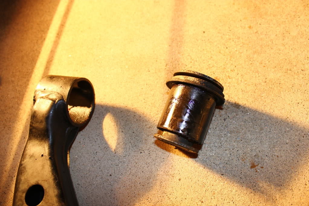

    Secondly: Here's my dilemma. After dicking around with this whole bushing issue I discovered a few things. I discovered that replacing your bushings may likely not fix your popping issues because the LCA housing (that the bushing is inserted into) may be stretched or disfigured from abuse. That being the case, a new bushing will never fit as tight as the original did the day it was pressed in.
    In light of that, I thought, well maybe I can drill a shallow hole into the arm and bushing and use a set screw, rivet, etc. to prevent movement. Tried that last night and although it looked like a win win, after one half hour mild offroading, rivet sheared and I'm back to square one.
    I need a screwy but effective method of getting this bushing to stay in that hole. Ideas?? I thought about JB weld but then how will I ever get that shit out if I need to replace it. Also JB weld will likely crack with the vibration and extreme impacts. Don't know what else to try that's not entirely permanent and yet will hold for as long I need.

    New lower control arm. Although my buddy (madtaco) had a great idea. I think next week we're going to pop the arm off and throw a couple tach welds inside of the arm to create a tighter tolerance when the bushing is pressed in. This idea remains consistant with the original design which is that the bushing stays snug due to tight tolerances. We'll see how it works out.

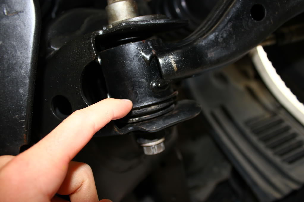

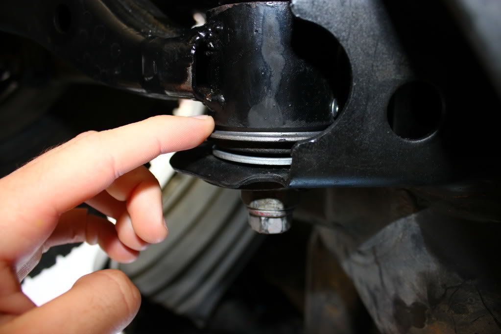

    Not necessarily. Take a look at these pictures and see if you can find something similar under your truck. You may have to make some sharp turns on your street before you'll notice this discrepancy.
    No gap (The correct appearance)
    With gap (Bad, indicating bushing is not fixed in place anymore)

    It looks like the no gap when I just went outside

    Alright. Sometimes it returns back to the "no gap" position after you've driven awhile. May have to provoke the pop sound and check immediately thereafter. I noticed by looking at the other bushings, you can sometimes tell by rust or weathering if one particular bushing is moving around while the other's or not. You have to do a real visually ciritcal comparison.
    If none of those symptoms present, you may have a totally different issue all together. If you here your pop just making sharp turns or pulling into driveways, but don't hear it driving straight or over rough pavement, I'd say it is likely the same issue I'm having. Ball joints and warn parts usually cause more racket and more frequently.

    I pulled the bushing out, made three tack welds at evenly spaced intervals like 10:00, 2:00, 6:00. I placed them halfway (depth) into the housing. As a final failsafe I welded a small amount of the bushing to the arm ( there's a little factory made hole in the housing that you can see when the arm is off). I figure when the time comes, a tiny amout of dremel work can release the bushing for replacement. An alternative though might be to use very coarse sand paper, remove all paint and oil from the contact surfaces, and then use JB weld. Good luck though if you need to pull it out for replacement one day. :rolleyes:
