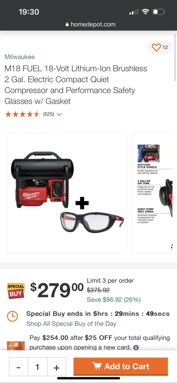

    Surprise, AZ.
    23 Ram 1500 Classic
    Dumped the Tacoma, that's all it needed.
    Just picked this up. Should more than do the job.
    I also have the M12 inflator in the truck.
    BJK1280 and Speedbird like this.

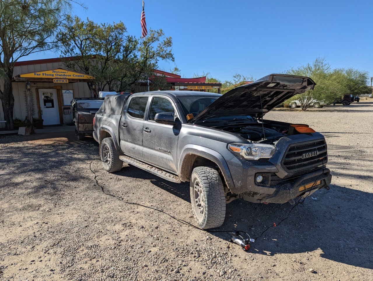

  15. Jan 23, 2023 at 6:31 PM
    TA2016
    TA2016 Well-Known Member
    Aug 17, 2015
    #162050
    3,923
    Oregon
    2016 TRD Sport AT V6 4x4 ACLB P&T Package Red
