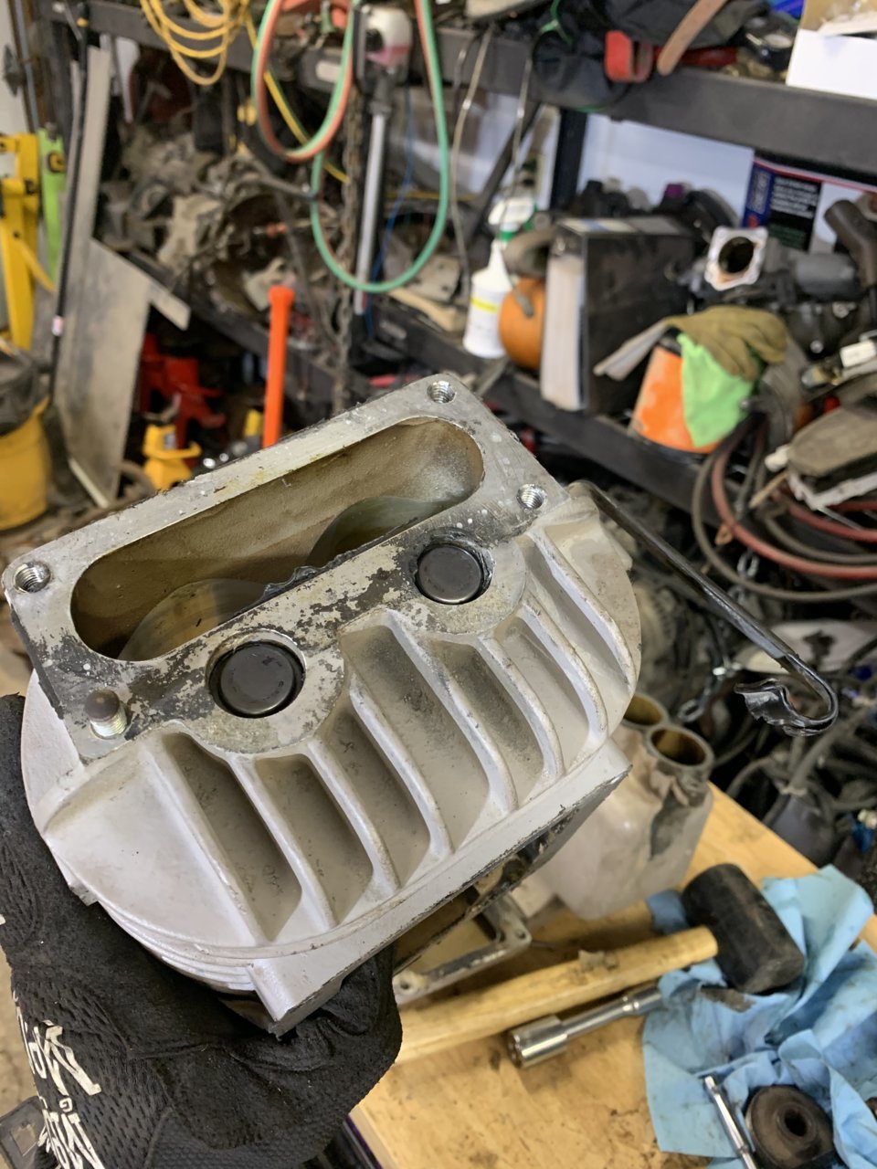

    The guy I bought it from told me he’d rebuilt the nose cone
    Slashaar likes this.

    But when I asked him about the rear bearings, he said he’d never heard of anyone doing them. :(

    And mine were done. So I got them swapped out

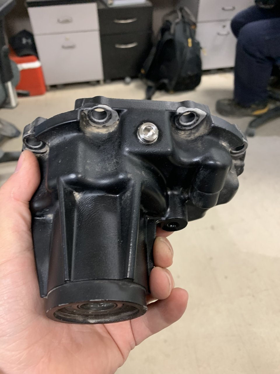

    And since I was there, I drilled and tapped the nose cone, to make oil changes easier.

    The front bearings were still good, so I just replaced the oil seal.

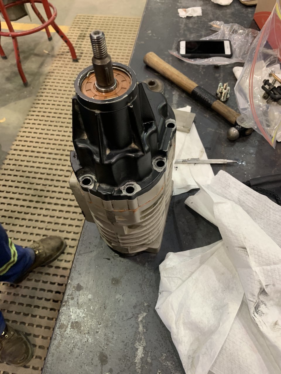

    OME Suspension, ARB Bumper, frame swap, Rebco logger box.

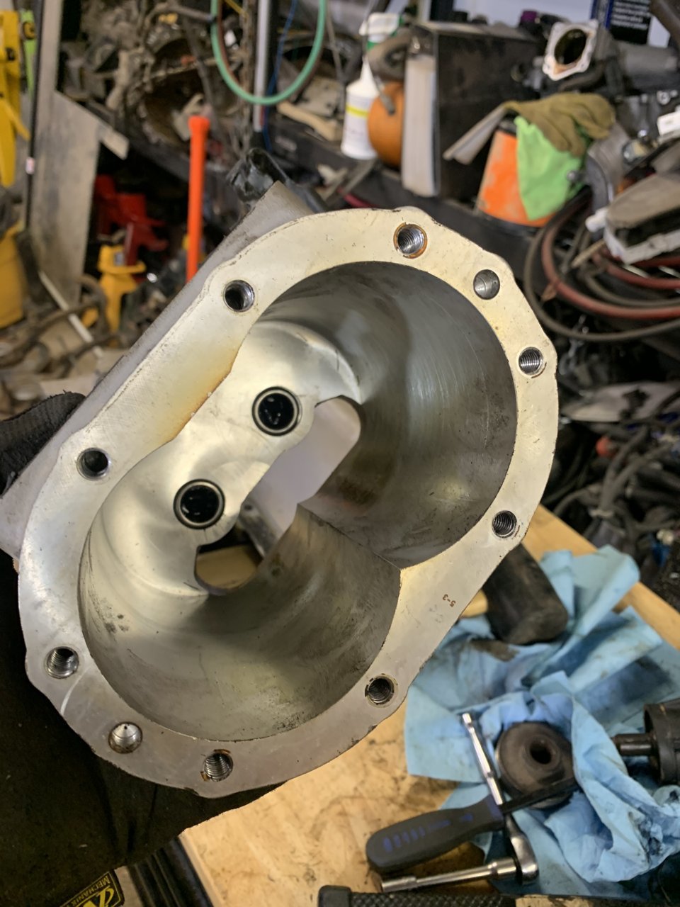

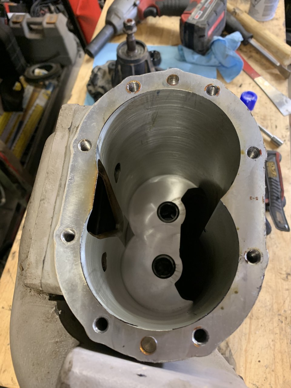

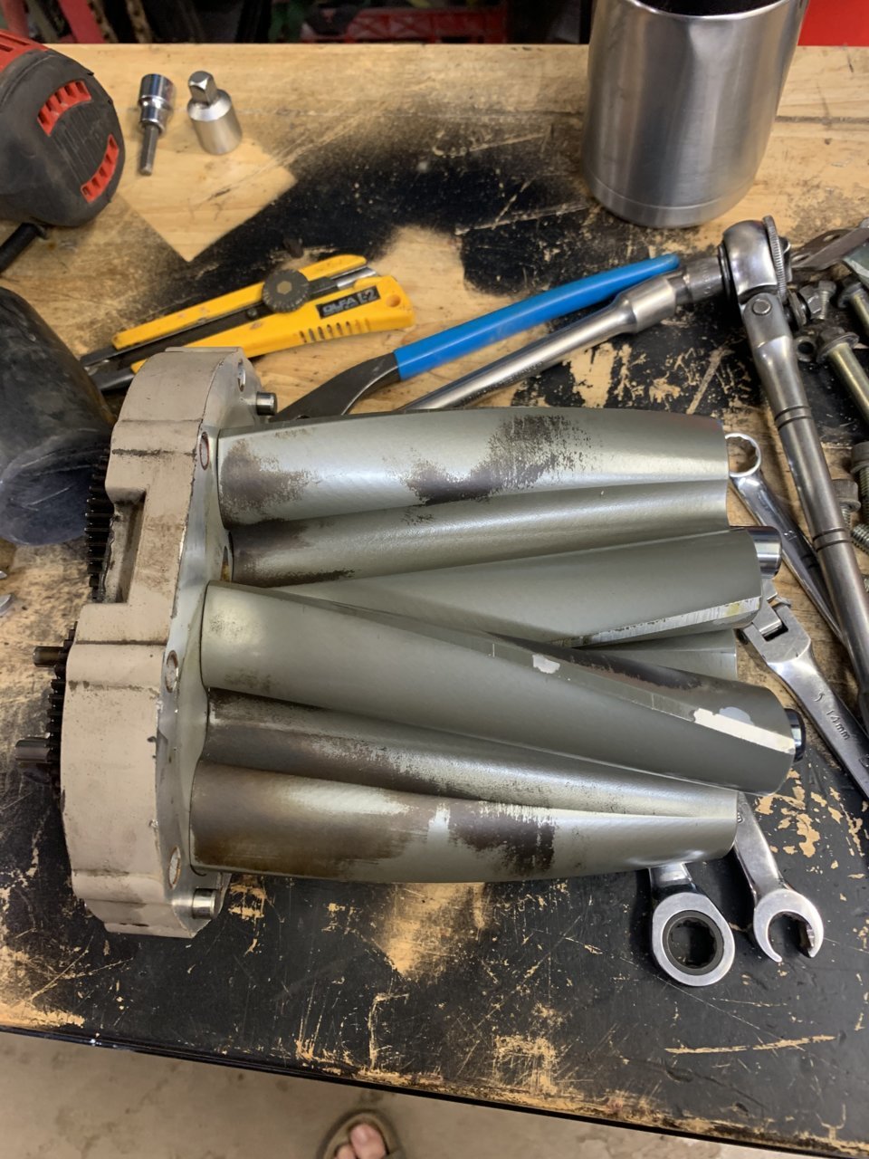

    Supercharger rebuild was awesome! Still so happy with this set up. 35x13.5” Krawlers, 4.88’s and the supercharger, and I get nearly 600km to a tank!

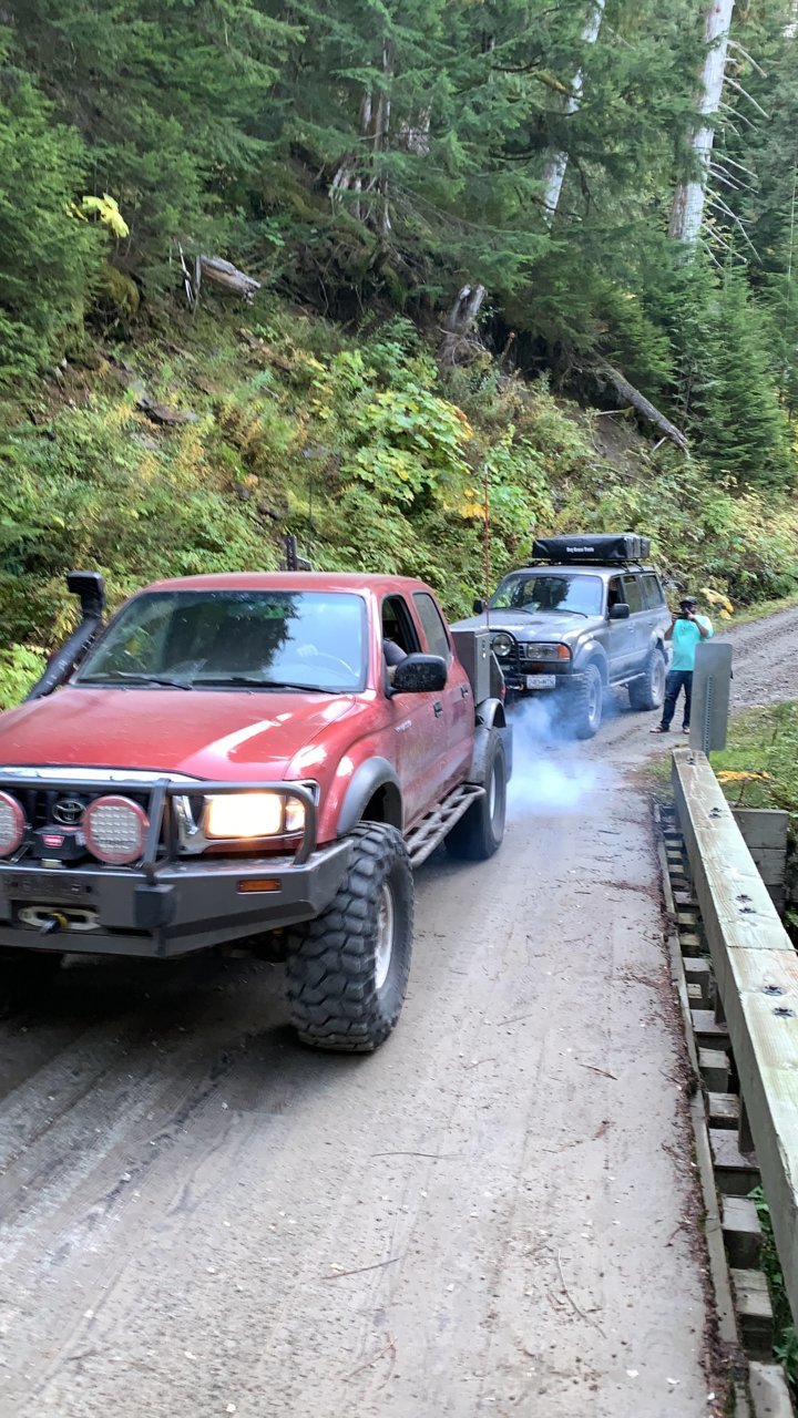

    The supercharger sure spins the fatty’s!

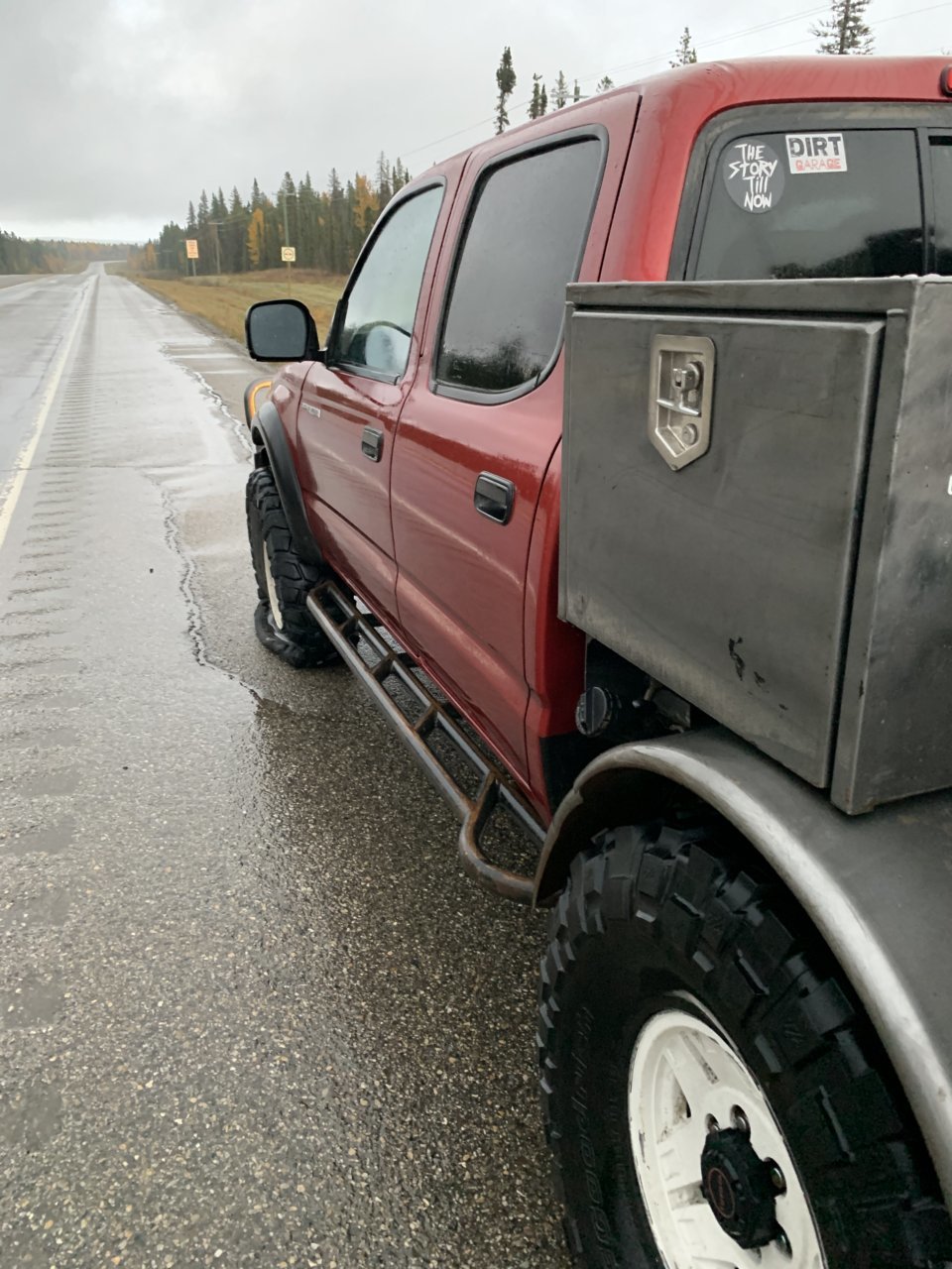

    Two of my Krawlers are tubed. Not the best solution. I started having some issues with the drivers side front.
    And sure enough, she let go. This also blew an actual hole in the carcass. Dammit. I’m gonna have to give up on the Krawlers. Time for new shoes next year.

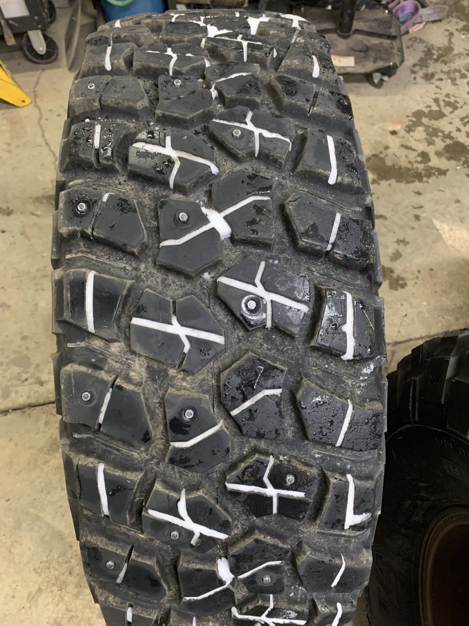

    BFG KM2’s. 315/75/16”. I added grooves, sipes and studs. Winters in Alberta are long, and constant ice on the roads, but I want the MT’s for the snow when I’m wheeling, so this has been a great solution.

    Siped KM2

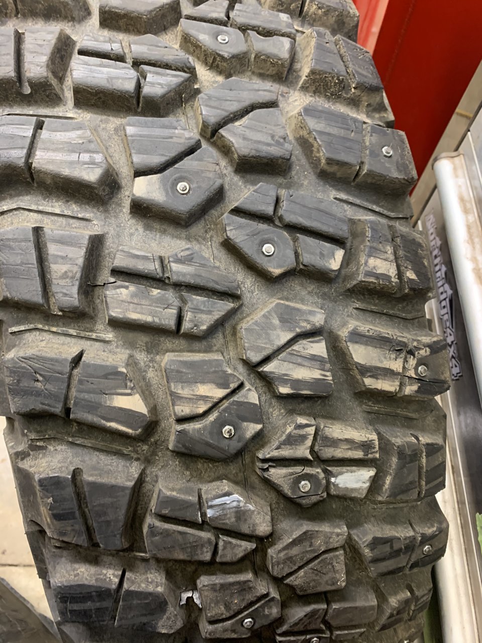

    You can see the sipes are doing their job, grabbing and holding snow in the tread.

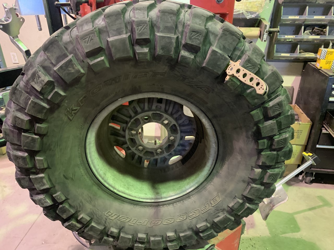

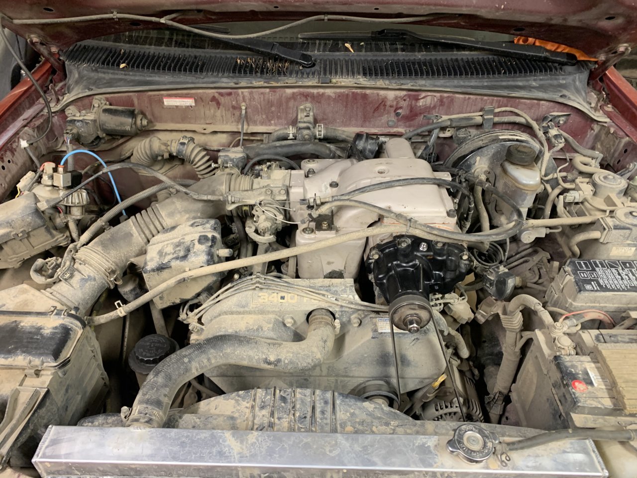

    #309824
    1,114
    Red Deer AB
    2001 Tacoma DC XPreRunner
