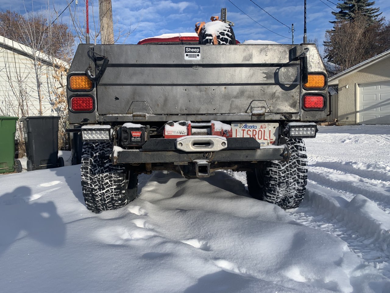

    Can’t wait to get into the big snow!

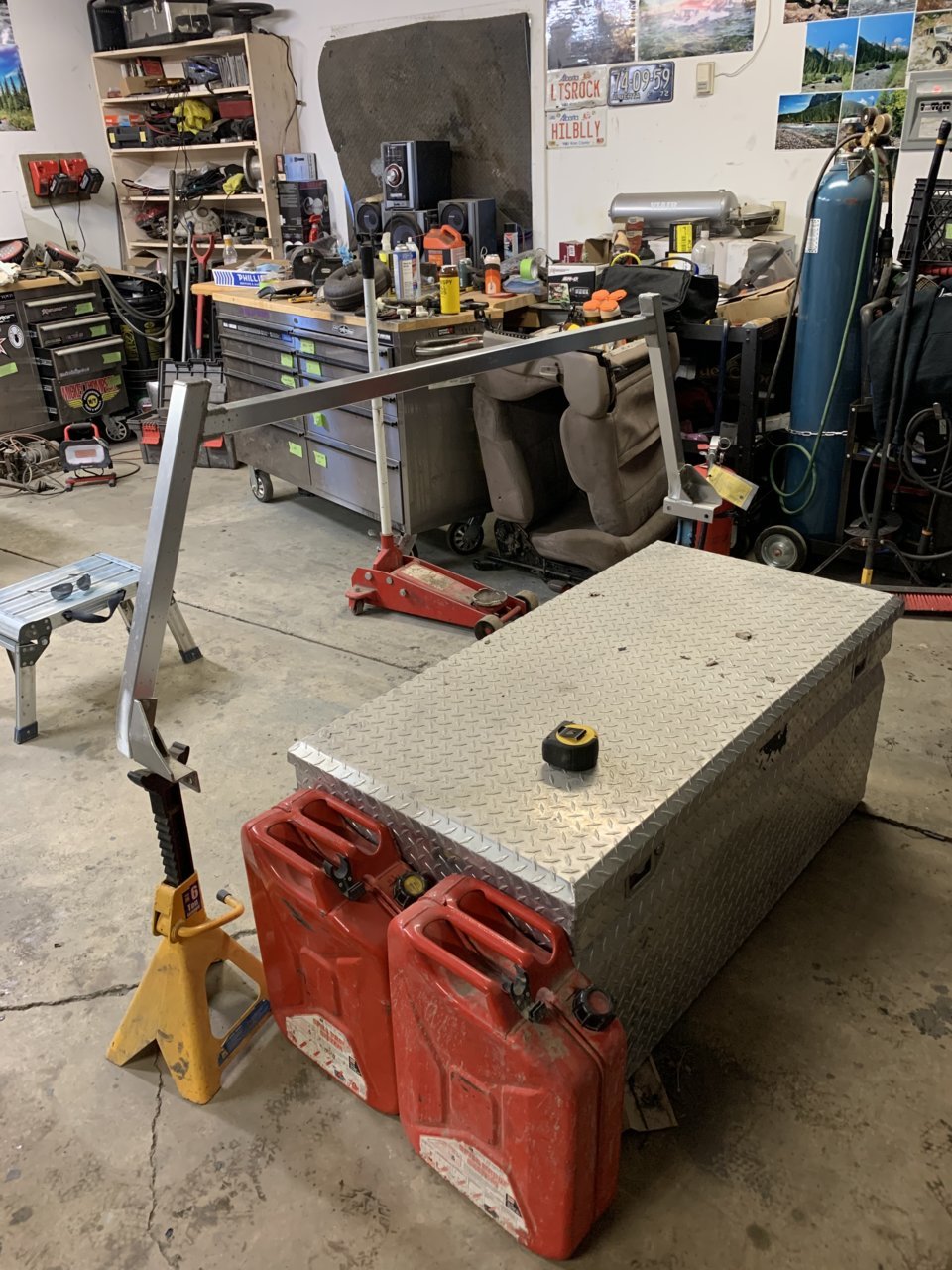

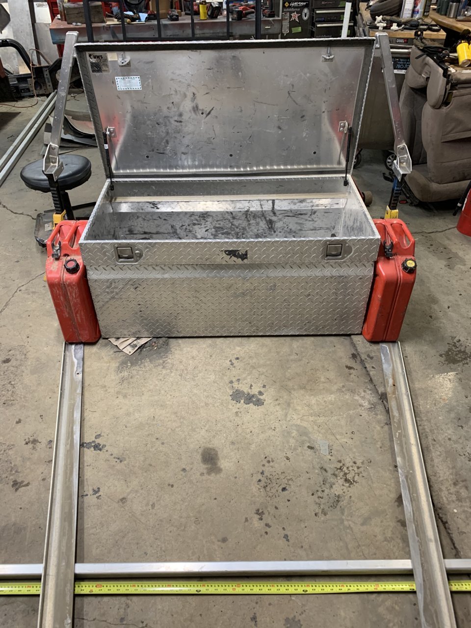

    I’ve also started in a redesign for the truck box

    Going to aluminum, and going minimalist.
    Slashaar and Arctic Taco like this.
  5. Dec 30, 2020 at 3:09 PM
    #265
    POSTacoMike
    POSTacoMike [OP] On the rocks, please
    Nov 4, 2019
    #309824
    1,114
    Red Deer AB
    2001 Tacoma DC XPreRunner
    OME Suspension, ARB Bumper, frame swap, Rebco logger box.
    Frame will be 1”X2”x1/8” aluminum square tube. Tool box on back will carry all tools and 2 batteries, as well as onboard air. Dovetailed. And bobbed. Removable sides. Basically, my logger box weighs in at 600lbs. I’d like to remove 500lbs. Should be able to do it.

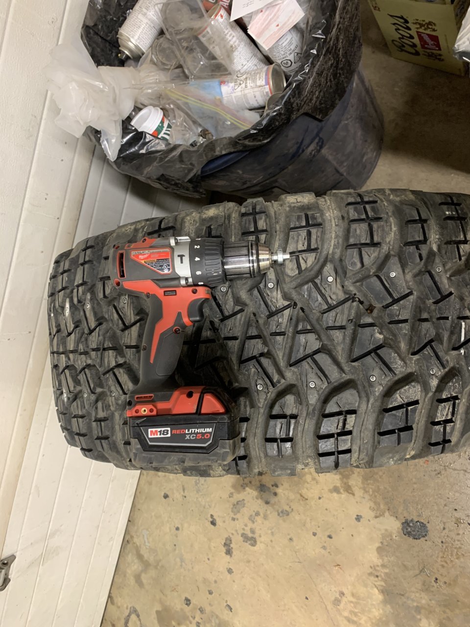

    I have grooved and sipped a few tires, mainly big Intercos. But I have never tried studing them. How do you go about doing it? As the tire wears do you have to drive the stud body further down to keep them from being exposed and pulling out?

    These are a screw in stud. The tires won’t see much for road travel, so I will be monitoring them to see if I have to drive them down a bit as time goes on.
